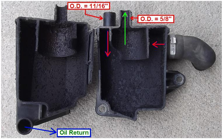

- Just replace the hoses etc.
- The oil trap can be cleaned and re-used. They last up to 300K.
- I posted a photo some yrs ago, when I cut it in half to show people the inside anatomy...

Probably not so true in this case though. The non-turbo separator boxes have a built in diaphragm that is supposed to control the amount of vacuum placed upon the PCV system. Over time it gets all coked up inside and the diaphragm can’t do it’s job. I have a photo somewhere of what mine looked like inside when I cut it open. If I can find the pic I’ll post it.

@chrism et al,
I do NOT have the cutaway view of a P2 oil trap, my guess is the P2 oil trap is very similar to P80 oil trap...
The photo below is my 1998 V70 (non-turbo) Oil Trap with 100K, I cut it in half to see the anatomy:
it is a simple box.
PS: If anyone has a P80 oil trap, please post a cutaway view...
it is a simple box.
