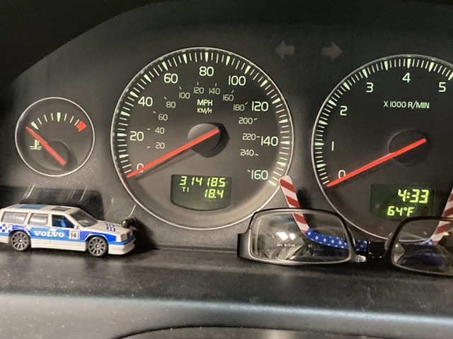

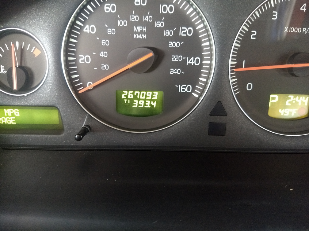

I took a vanity shot just prior to crossing the 300K border, turned out kinda cool
(this is more current, and not as cool). I’ll see if I can find it.
