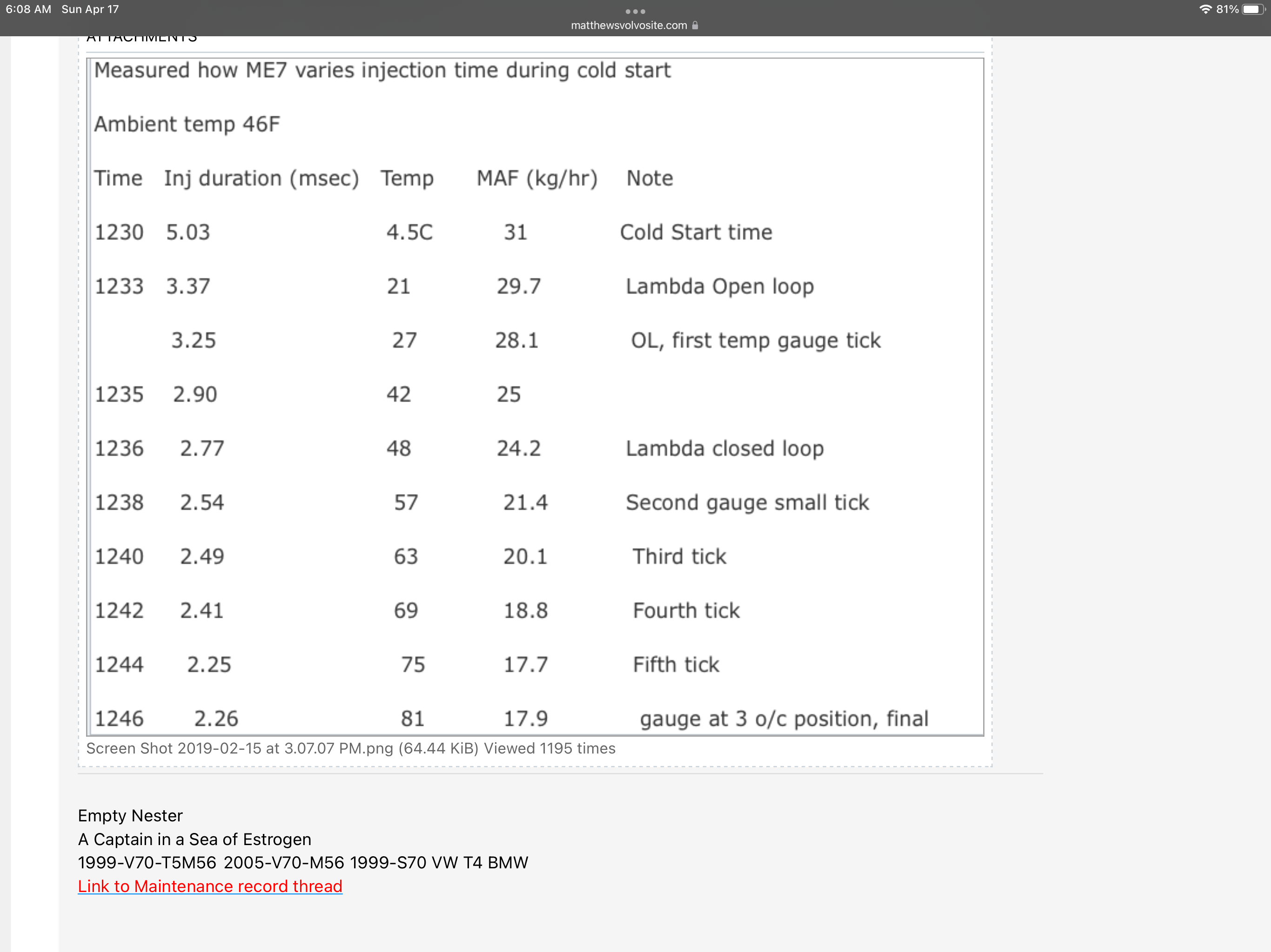

At idle I want to say something like 2-3 g/second
I think I wrote this up somewhere , too
….found it
….found it

The lowest value in the photo is 17.9 kg / h, which is almost 5 g / s. I have checked out of 5 used flow meters and none showed more than 3.6 g / s. The inlet is tight, I checked it under pressure. It only hisses in the hole on the underside of an intelcooler that appears to be factory.

Me7 & M4.3 or M4.4 doesn't have the same values.
Maf sensors are also different and NOT interchangeable!
You will need values for m4.3 or m4.4.
Me7 is from '99 and later.
