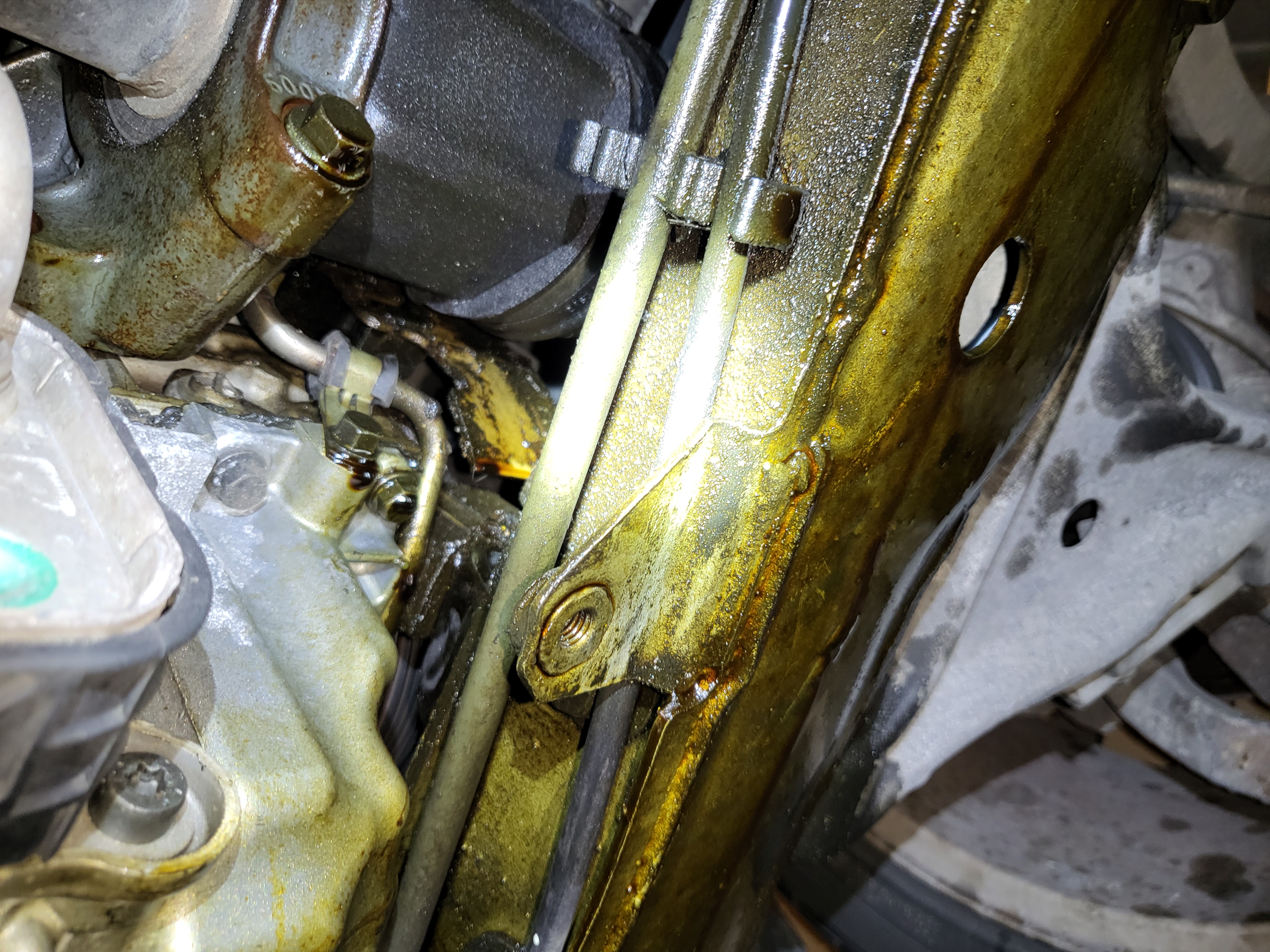

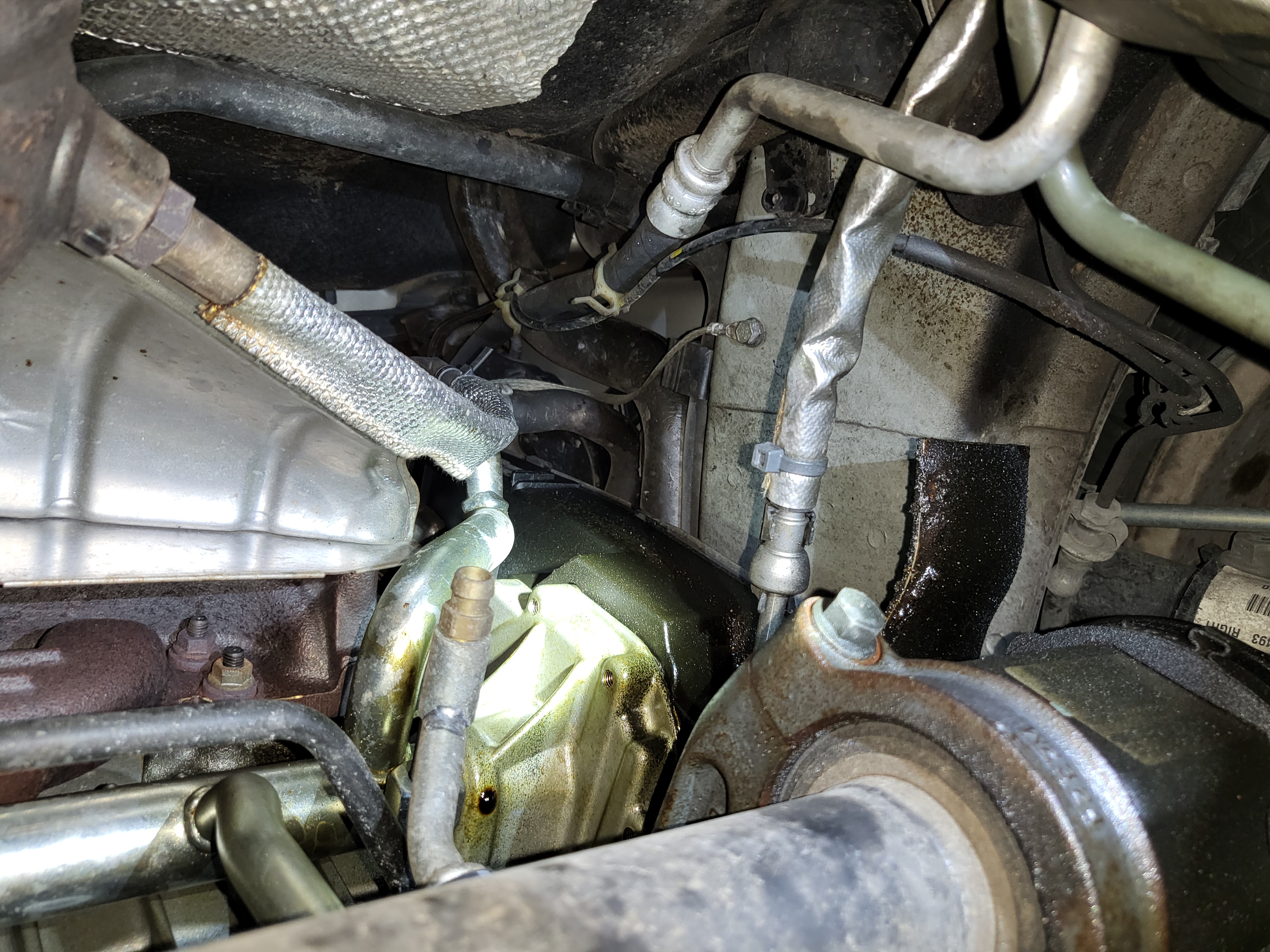

My car is at about 95,000 miles and has suffered from a sudden onset oil leak. It's a pretty decent leak coming from the front of the engine block. I've attached some photos with captions, let me know if you have any questions.
My question is: where does this appear to be coming from? How much should I expect to shell out for this (I reside in the pacific northwest of the USA)?

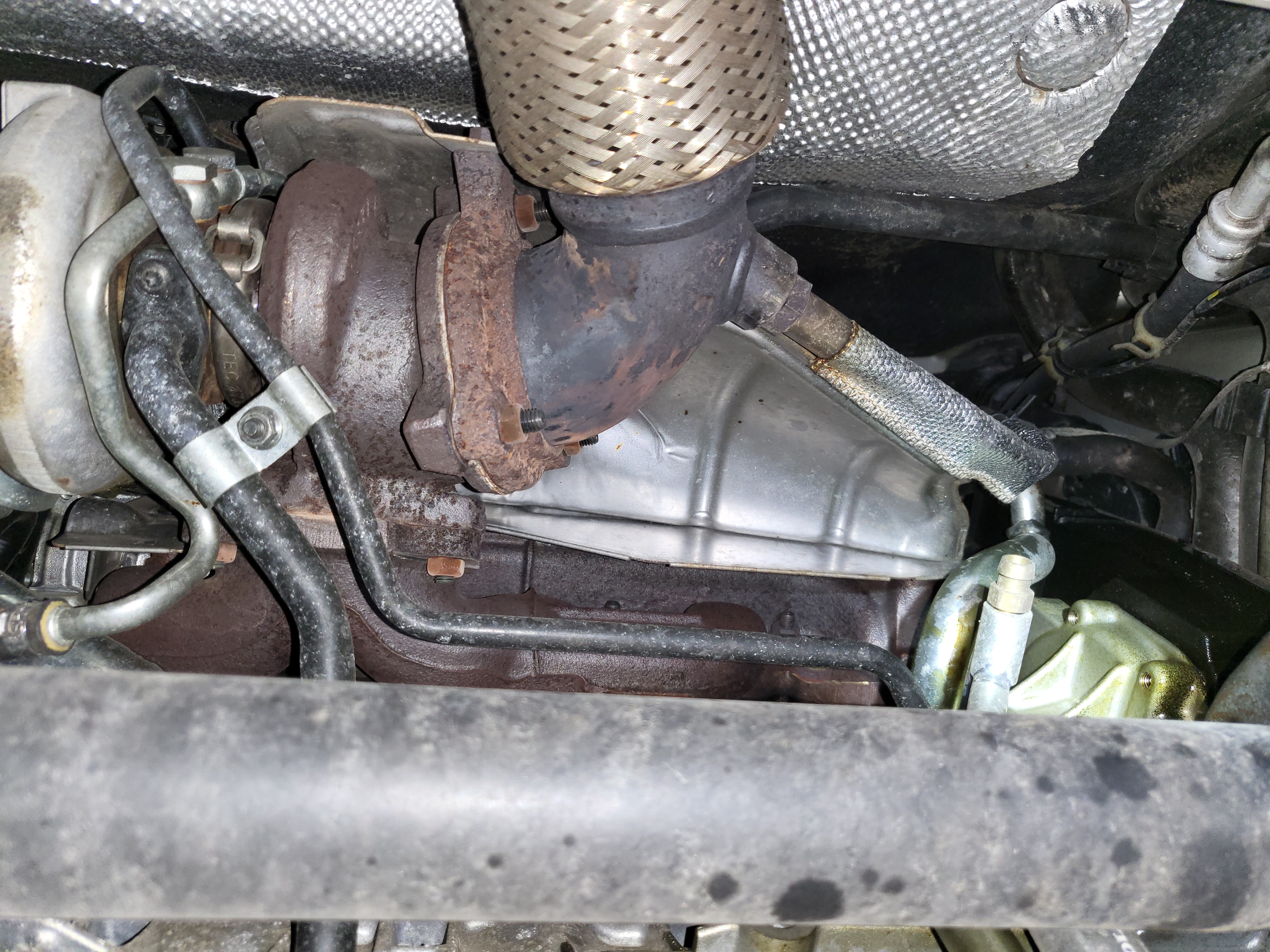

For reference: we are on the right side of the engine (between the engine and firewall). Turbo is to the left, leak is to the right.

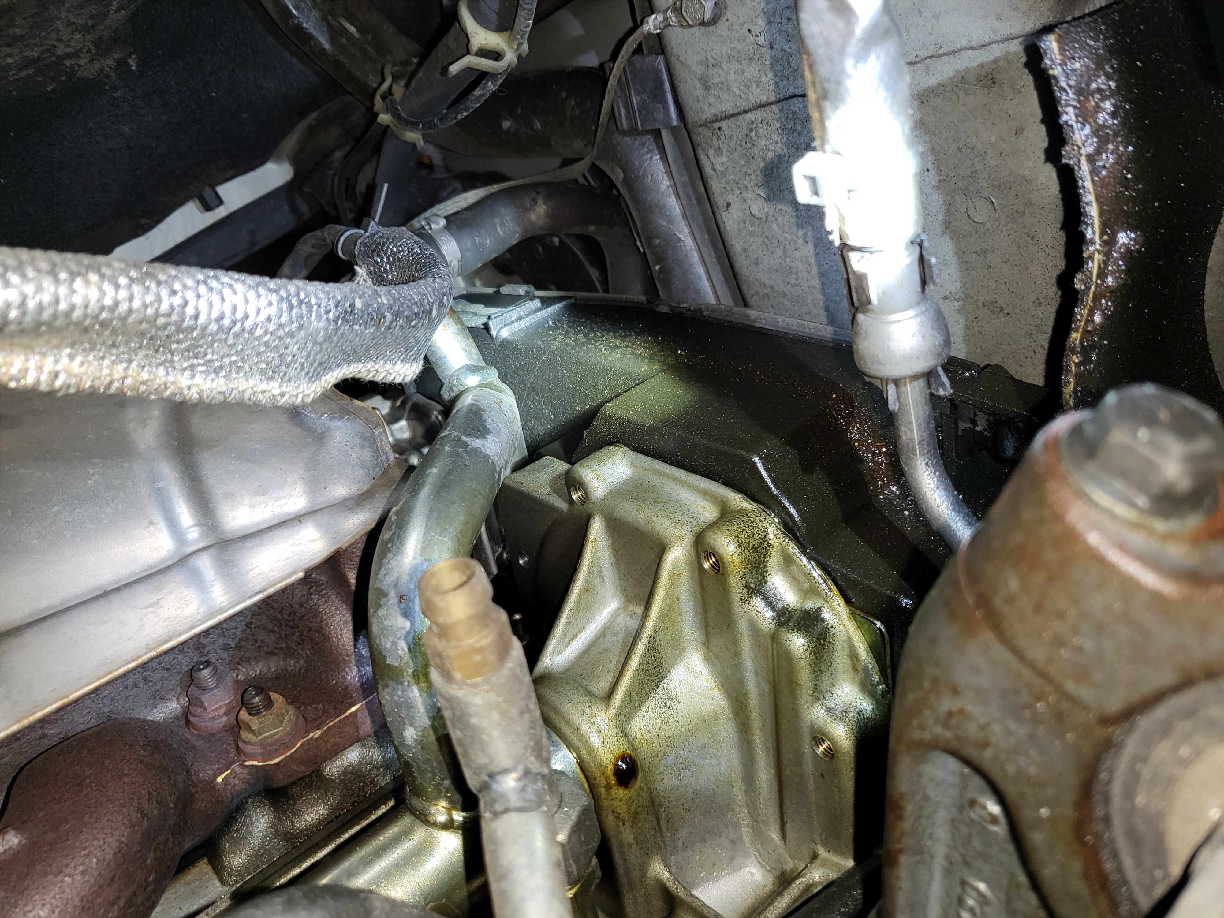

It seems to be leaking from up there. This would be the front/right corner of the engine (near the passenger wheel)
Would that be the timing cover? pardon my ignorance.
Dropped down all over my suspension and then my floor!

Probably a cam seal.
3 hours labor, $5 part

So I got the car into the shop today. We looked under the timing cover and didn't see any oil, the cam seals are dry. It looks like it's coming from the head gasket. Oof!
