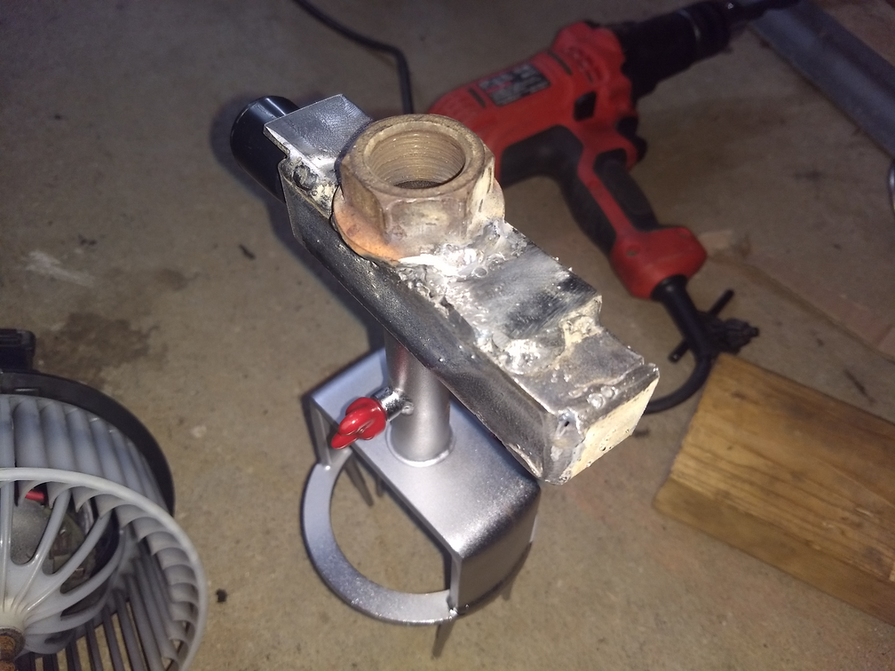

I was struggling with fan and resistor removal on ex-our XC60 and welded 3 tools:
- fan removal tool adapter, allows to use a socket wrench or breaker bar. My fan was fused to housing, 200 lbs man power was not enough to break it loose

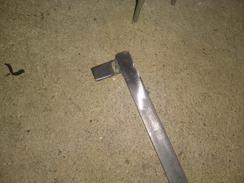

- fan housing latch tool, allows to unlock the latch (XC60, unlike XC70, has HVAC pipe under the cluster as one piece)

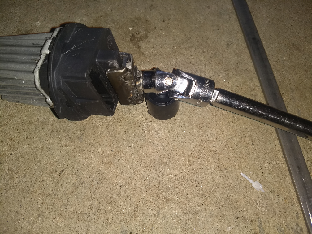

- resistor removal/installation bracket/adapter.
