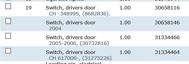

VIDA screenshot below.
Chassis are the last six digits of your VIN. So that leads me to think your part number is 30658146. You could verify with a dealership parts counter if you want, I've done it before ... "Hey can you give me a quote on the drivers door module for my car?" then give your VIN, they always end up with the same answer I've found for myself (try shopping for a steering rack for your car- good luck!). Also another tool I use are dealership parts websites (I use Toronto).
Also for purely anecdotal purposes, I had my passenger door module fail the exact same way as yours. I performed all of the above good suggestions, and none of them worked. The module was simply kaput and no amount of electrical cleaner could bring it back to life. Relays have a rated number of cycles and likely all of ours are WAY outside of the intended cycles they were guaranteed for. I used car-part.com to find a matching one for myself. eBay is good too, and another option I don't use because I'm not in the states is Erie Vovo, I've heard those guys are whizzes with part numbers and offer a great warranty. Good luck.
