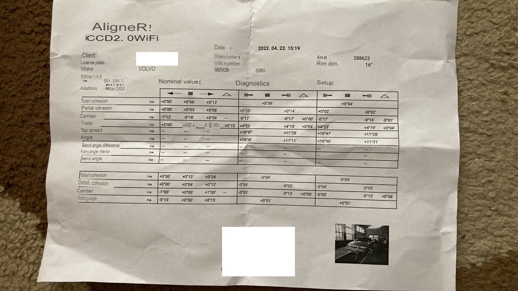

My repairman just finished a "Space SPTD 2 WIFI CCD" wheel alignment on my S80 classic (2002).
But car definitely pulls right.
I attach the wheel aligment values:
Maybe there is some problem with the values?
I already replaced: Wishbone arms, Shock absorber (front, back), Strut mount (front back), and I have brand new tyres. So I think It may a setting issue.

did you check the condition of your tranny (Hutchinson) side motor mount?? behind the harmonic balancer??
I had similar straying. had gotten new tires and alignment. still a slight stray to the right which was more than might be allowed for the concave of the road.
Found that my Hutchinson motor mount had crapped out. replaced and no more issue. I should have know when i started to hear some vibe on acceleration
