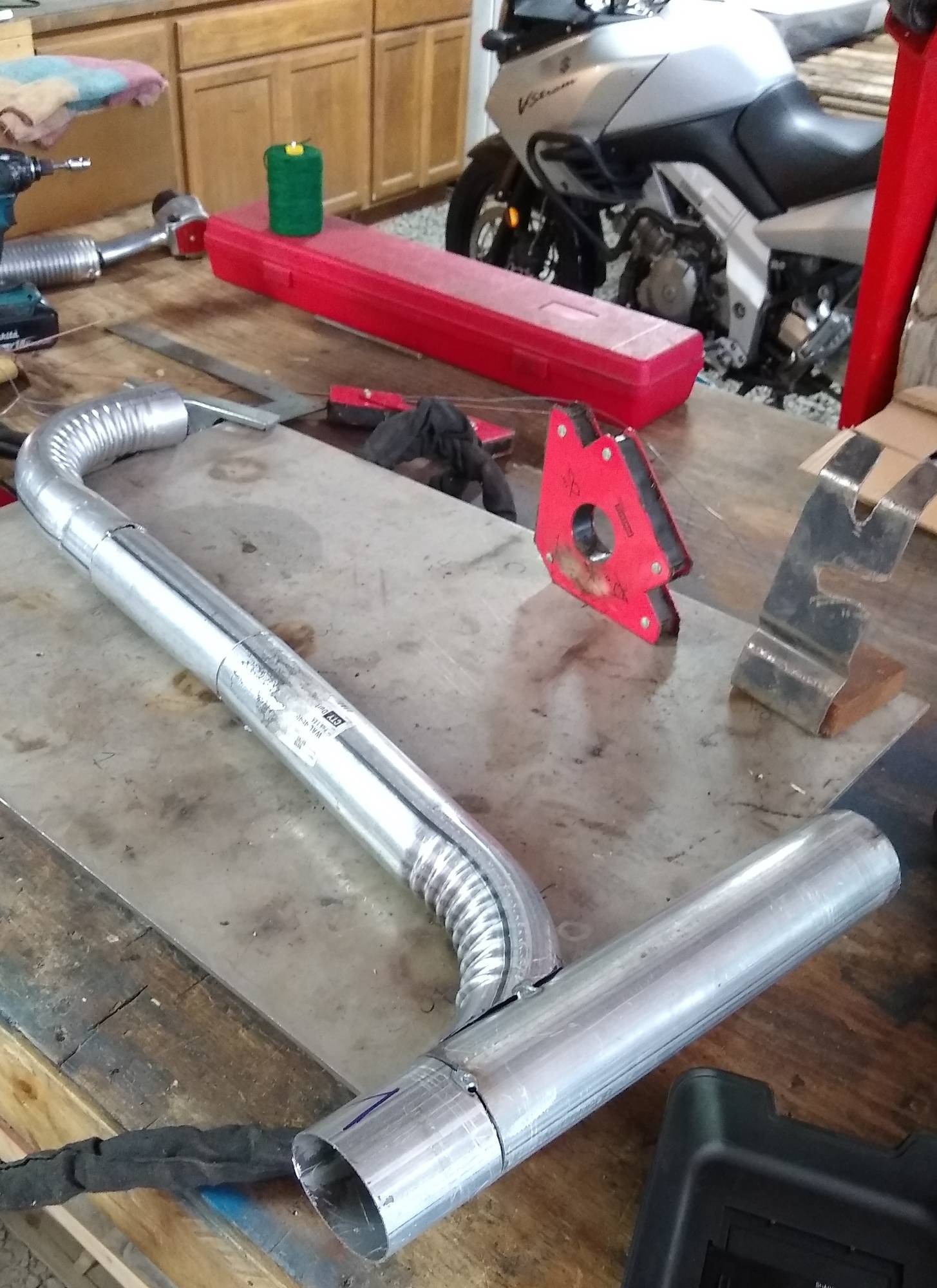

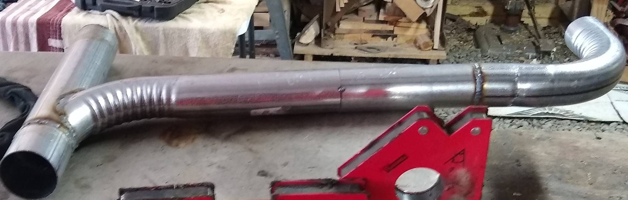

Youtube some other Vibrant Muffler videos. They sound excellent on all types of vehicles. They have Resonators and Mufflers. Called Vibrant and the Resonator is basically a small muffler with a different chamber design in mind.
There was not enough room on the C30 so we decided to go with a muffler delete. We went with unequal length and different size tubing and the rubble is deep, not too loud but with lots of gurgles and loud pops if you gently lift throttle at cruising speed.
Orielly had a Ford Econoline Van Pre-shaped bolt-on exhaust tubing with the correct number and angle of bends needed for the job. Was very reasonably priced.
