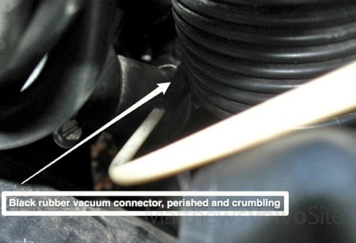

MVS Contributor jreed hits it out of the park with a DIY on an overlooked vacuum hose: “I was out looking around in the engine compartment (97 855 GLT with ~162k miles) for opportunities to fix something this morning. I’ve already replaced most of the vacuum lines in the car, but I found a short crumbly vacuum connector that I had overlooked the last few times I checked the car. This connector is located above the transmission, near the lower radiator hose. It is part of the Fuel Pressure Regulator line from the intake tube near the MAF Sensor and connects between a white hard plastic line and a metal line that runs over to the fuel pressure regulator on the passengers’ side.”
Fuel Pressure Regulator Vacuum Line Replacement
Getting the line off required (for me — if your hands are smaller you might not need to) loosening the black flexible plastic intake line that connects between the MAF and the PTC/Turbo intake region. I loosened the hose clamp and disconnected the line from the MAF. This allowed me to bend up the line enough to reach in and use pliers to loosen the metal spring clamp on the rubber connector.
Once I had the clamp loose, I found I needed to gently slit the rubber to allow it to be twisted and slid off of the metal line. Here is a picture of the little rubber hose after I pulled it off of the metal line:
