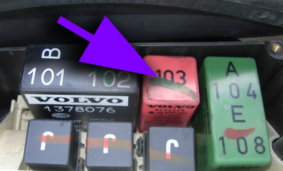

If your engine isn’t getting the proper amount of fuel, especially as the temperature dips, it could be your Volvo fuel relay. The solder joints in the relay itself tends to shrink and crack rending the relay non-functional. This thread tells you where to find the relay and how to resolder the joints and change the capacitors in the relay. You can avoid buying the expensive Volvo fuel relay pump if you follow the instructions here!
Just wanted you to know, that thanks to Lee I found the problem. It was indeed the #103 relay that gone bad! I even managed to fix it. Here is what you need to do if you have the same problem:
1. Pop the cover off and carefully examine the little circuit board.
2. Look around every solder connection, especially the larger components and
terminals for tiny hairline crack that forms a circle right where the solder meets the component lead.
3. If you locate one, simply flow some fresh rosin-core solder from a decent hot soldering iron into the joint and resolder it. It’s probably a good idea to resolder everything once you are in there, as there aren’t that many joints.
4. Look for bad contacts on the relay part itself, intermittent (open) relay coil, or intermittent component failure. (Junction breakdown on a Transistor, etc)
5. while you are in there, Replace the capacitors. This is extremely important. The capacitors in my case were the problem. They became temp sensitive and simply stop performing in low temp. After I replaced them and reinstalled the relay the engine starts great!!!
