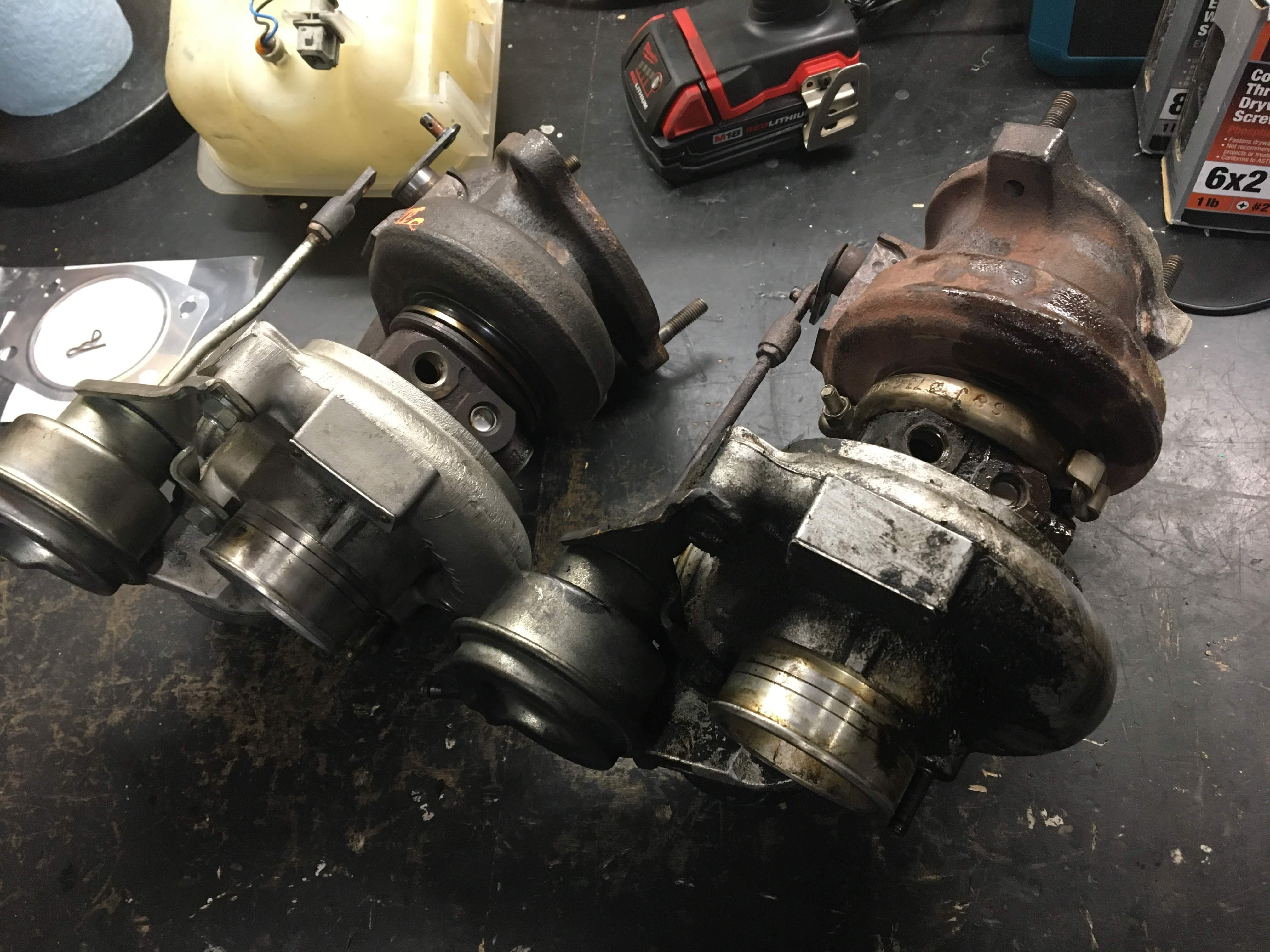

Later 13G, Hello 19T

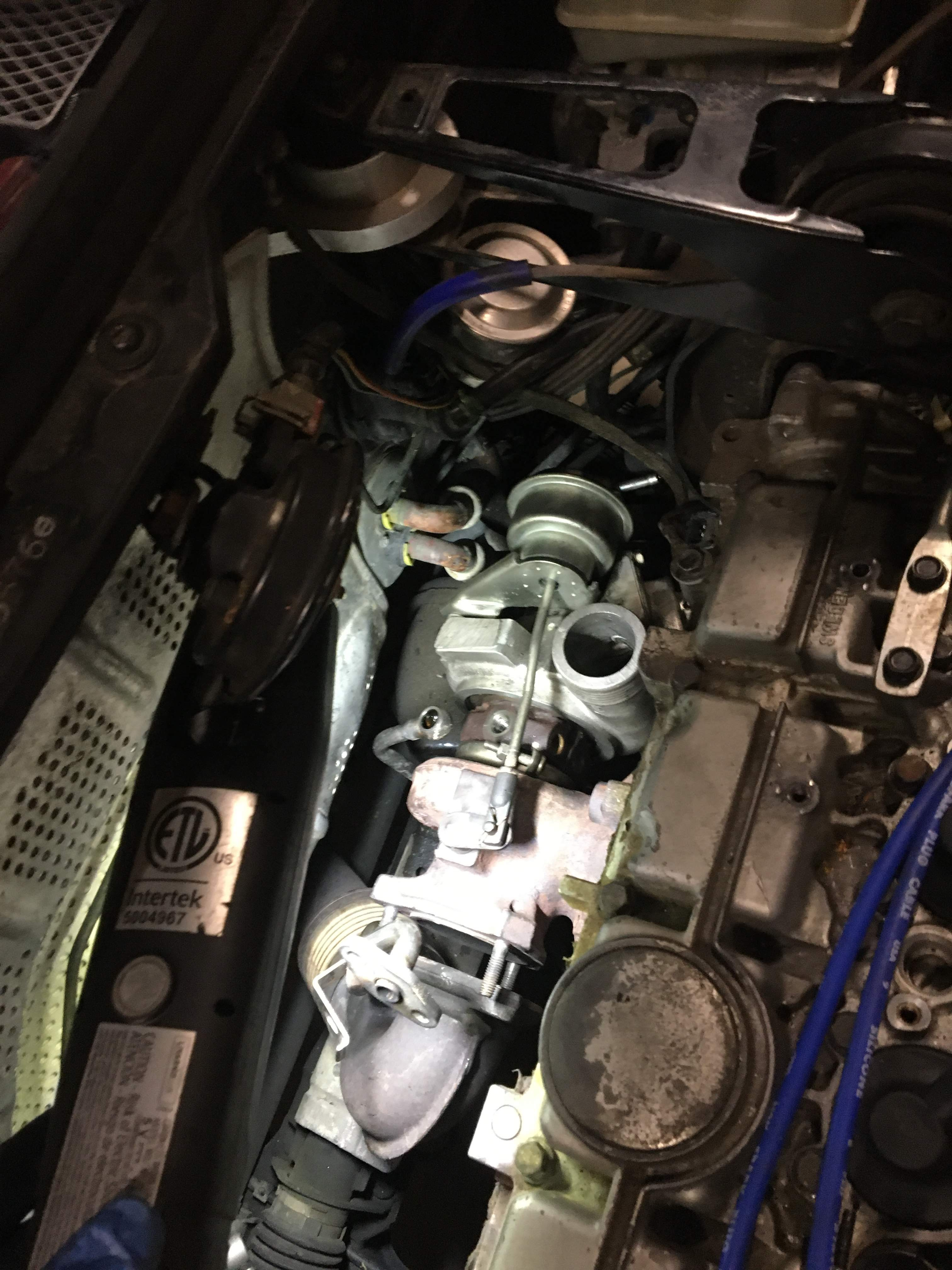

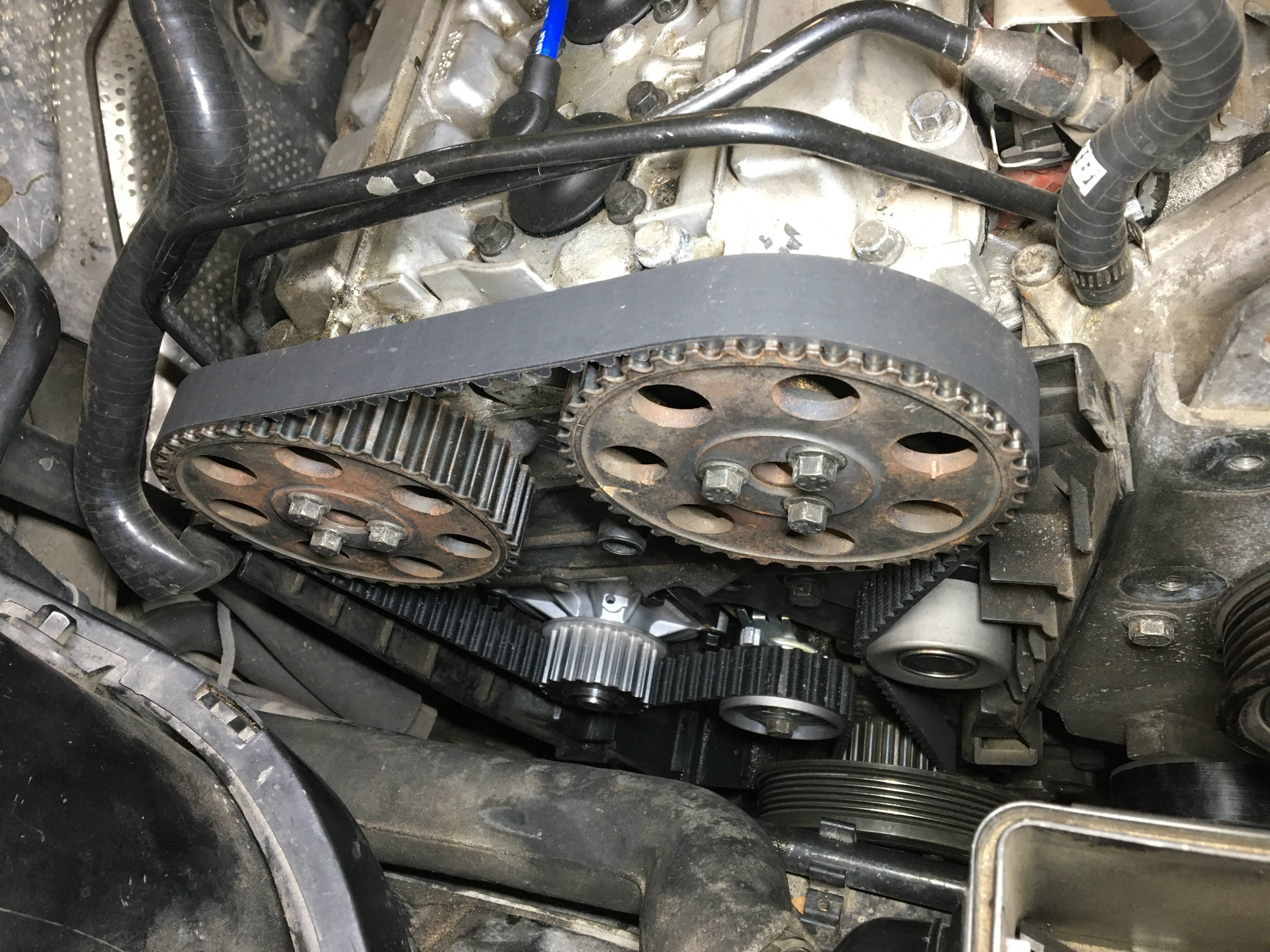

So onto the build… it’s a bone stock 1998 V70 GLT. 2.4L LPT N motor, 13G turbo. I started by replacing the timing belt, tensioner, idler, and water pump the other day, and just last night I got the 19T mounted up with the original straight flange exhaust housing. Yes, an angled flange would flow better, but we’re going to stick with the straight flange for now to work with an OBX downpipe.

  • TD04HL-19T turbo (2000 V70R)

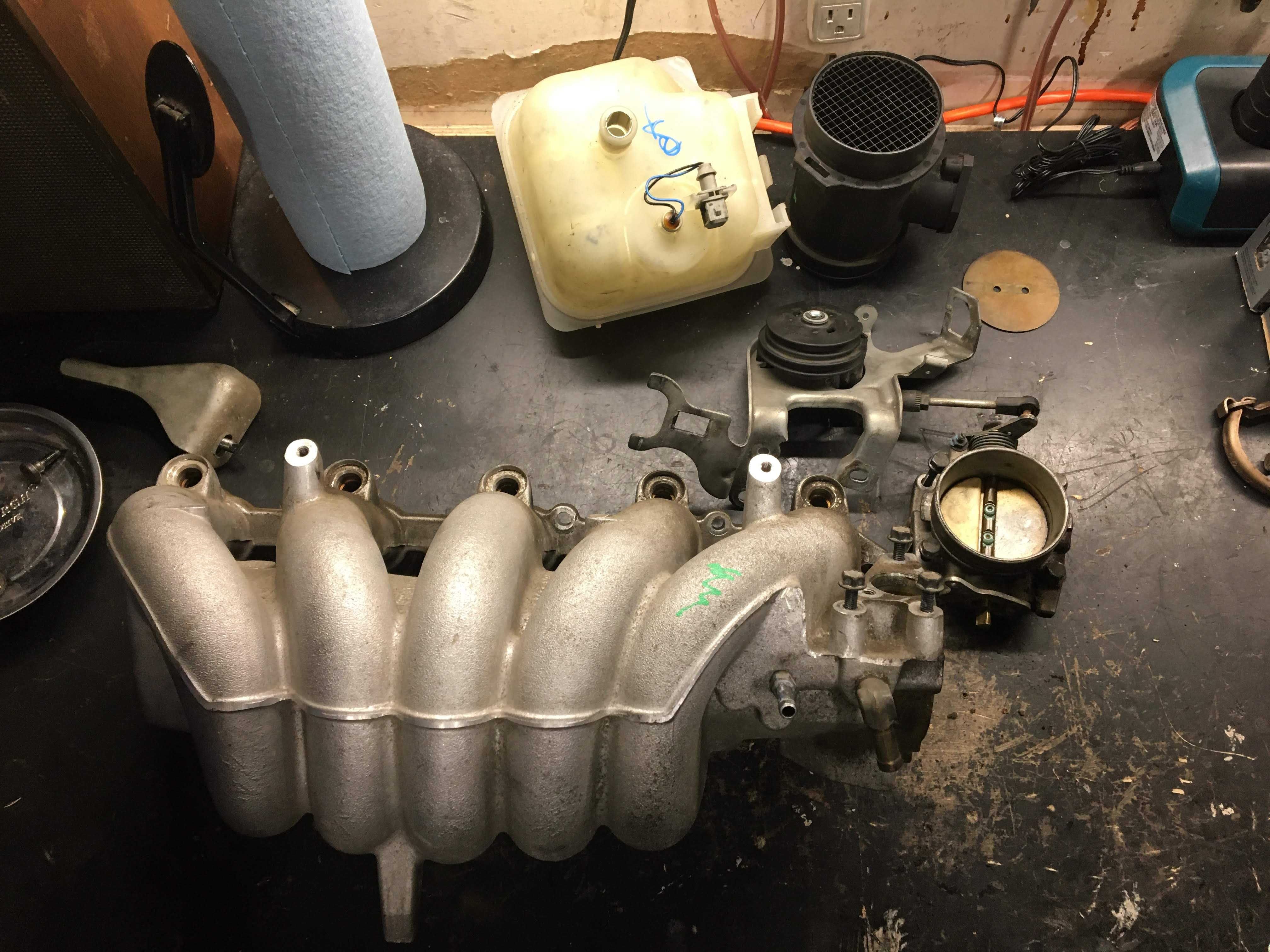

  • NA intake manifold and throttle body w/ 960 throttle plate (’98 S70/V70 NA)

And the important part… here are some pictures of 1998 V70 GLT 19T Build in progress, thus far!
