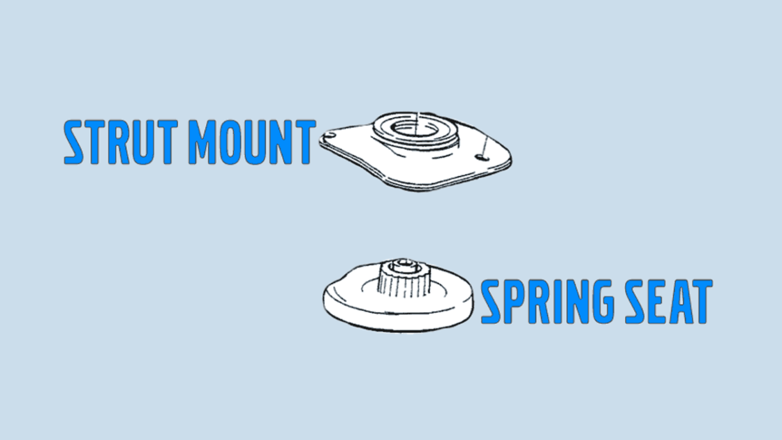

Identify Strut Mount vs Spring Seat
Strut Mount vs Spring Seat… these two suspension parts are often confused. This post explains the difference, and shows you the difference between the two in these images. Also, it shows you how the Strut Mount and Spring Seat assemble into their positions in the suspension.
Strut mount vs spring seat and how they fit in the suspension
Use this visual to distinguish the parts. Use this Forum Topic forum to find out which you need. From that forum post:
Local Volvo shop (not dealer) says its the “strut cap” which I know as a strut mount plate/bearing, I called a dealership to see how much for parts to do it my self as I couldn’t find them at local stores in stock and the guy who answered the phone in parts said it was probably the spring seat, without me even asking.
