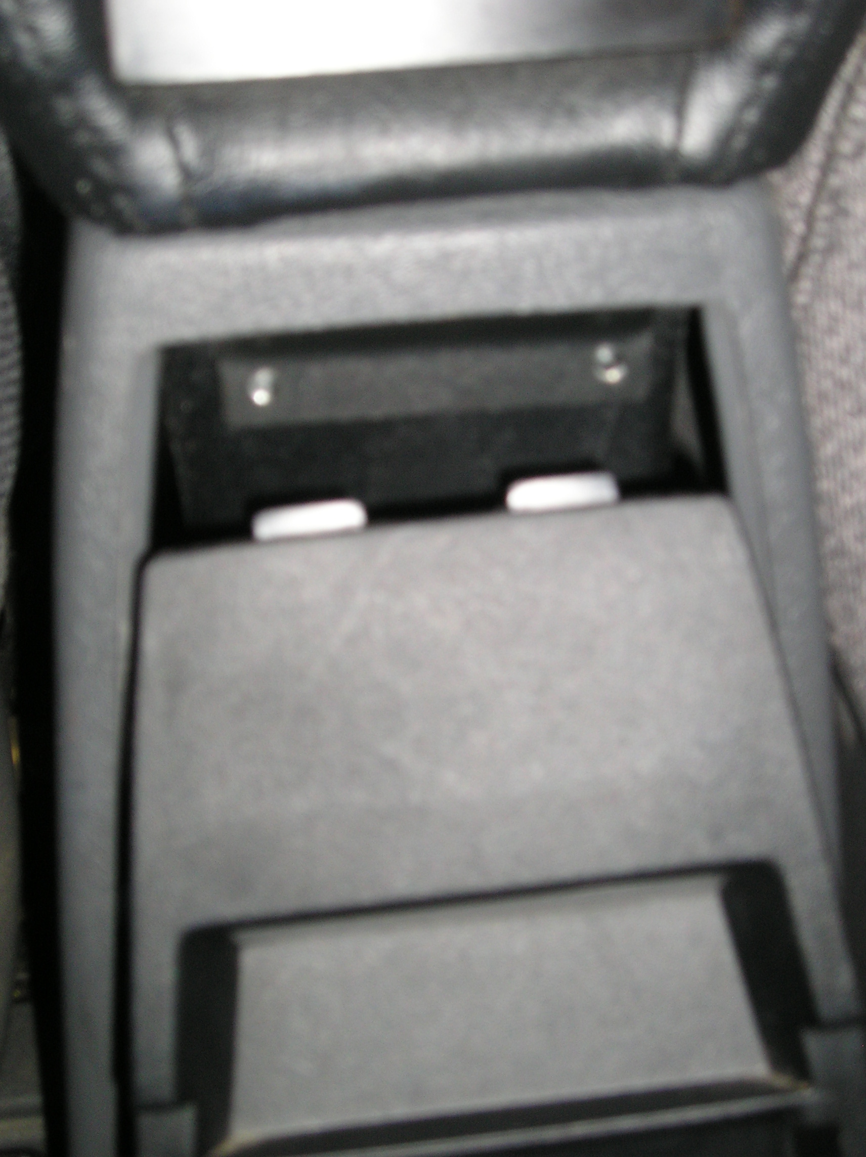

This is a simple adjustment. Start by removing the ashtray in the backseat. It is spring-loaded in the bottom, and secured by two stops in the top. To remove, open the ashtray, and press down against the springs to allow enough room to clear the stops. Then remove.

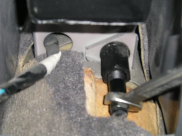

Next you need to remove the plastic panel. It is secured by two tabs in the top and two plastic clips in the bottom.
