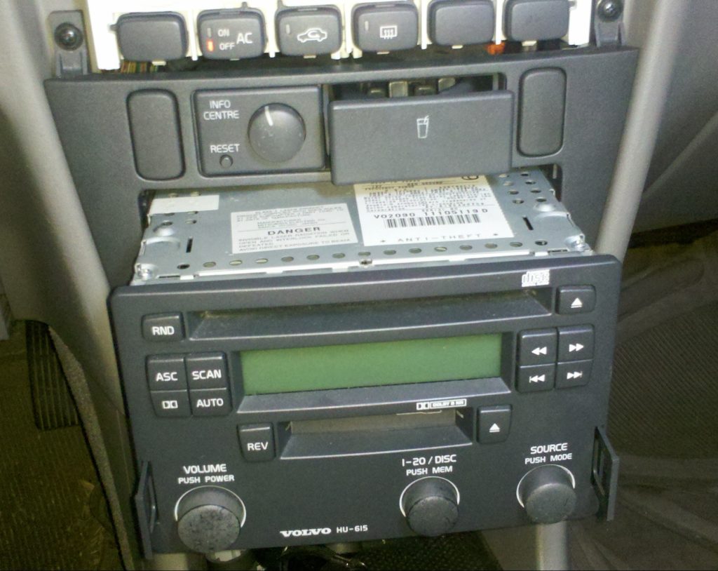

The first thing is to remove the radio, then the climate control panel (slides out with pressure from behind after removing the radio). The horizontal center console should also be removed at this point – this is really just two bolts under the felt cover inside the armrest and two screws that are visible after removing the ashtray, as well as the e-brake cover which slides off the handle and unclips from the rest of the console.
