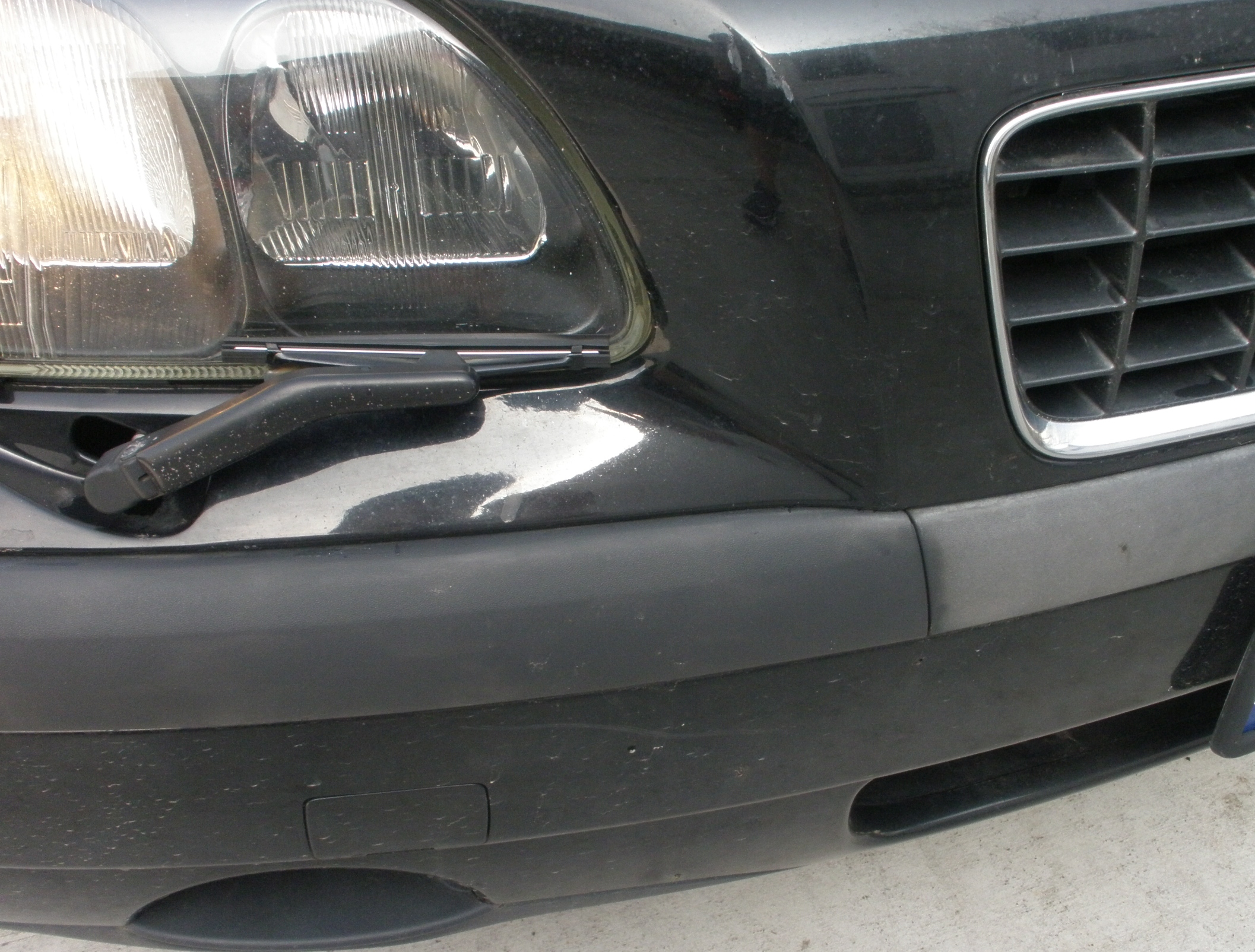

Got a new heat gun for a project around the house and had some time to try it on the bumpers on my 850 wagon.
Before
After
Not bad. took about 20 minutes total. some suggestion would be to wait for warmer less windy weather. It was high 50’s here in Ohio. I did the front as well. Took out some spots and evened out some worn areas. I will hit it again when it warms up. Well worth the 31 dollars for the heat gun. Also used it to take some left over sealer after pulling the side moulding off of my Audi 5000 Turbo Quattro. Get ready to send the old girl to the paint shop.
Thunderbox
The third photo shows the change close up. It’s not a perfect effect but its a huge improvement over very weather-beaten and faded 12 year old plastic trim. The fourth photo shows what it looks like from a normal viewing distance.
I did the side panels and the front and rear bumper trim. I didn’t do the lower trim and I stayed away from the side marker lenses.
That whole job took me about 45 minutes.
