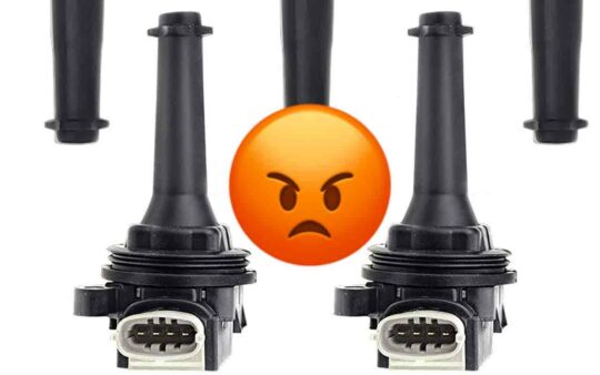

I have a 2001 s60 with 170,000 miles on it. the same thing happened to me about 6 months ago. I had to get my ignition coils replaced. there is propbably only one that is bad but if one goes bad the others will most likely soon follow. It can damage your catalytic converter if you wait too long. Good Luck!!
