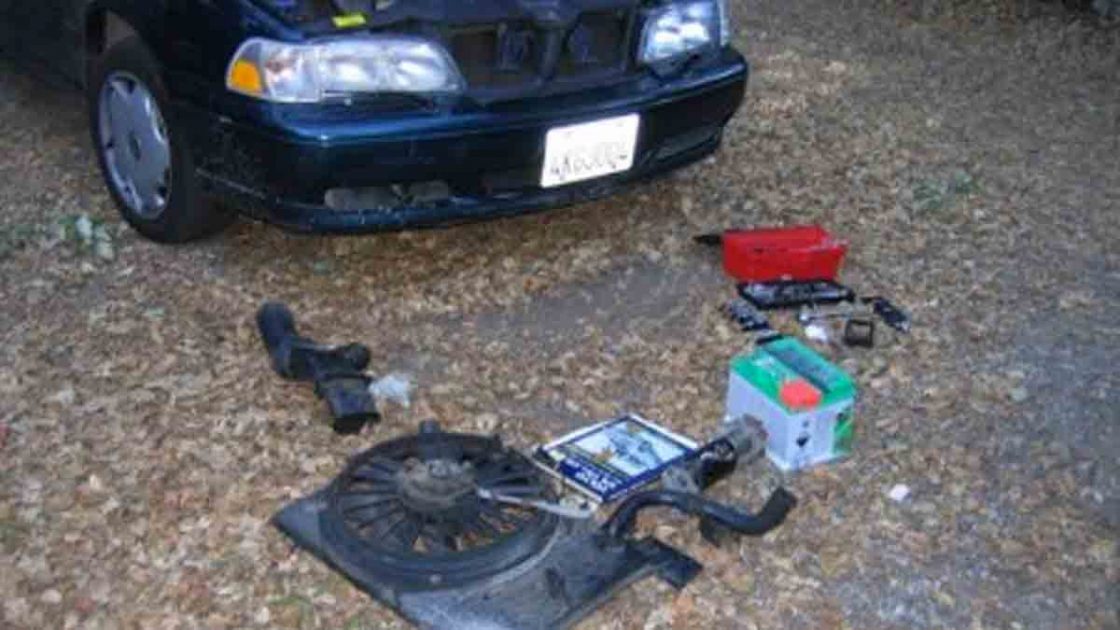

I just accomplished this job, here’s how I did it. Please forgive my lack of knowledge of the correct names for many parts, I am a complete amateur and I stumbled my way through with the help of forum members!
For the purposes of this description, left and right will be relative to the person standing in front of the car facing the engine. Also “in front” will then refer to closer to the person.
Symptoms: Key is turned, click is heard but no attempt to turn over. Headlights bright. Jump starting does not coax even an attempt at turn over. ie. not alternator or dead battery, not fuel delivery as it would try to crank then. This car is a manual transmission so no PNP to worry about.

Followed this to the letter – It worked perfectly!!
It’s true..unless you have very thin arms and tiny hands, forget changing the starter without removing the fan housing.
