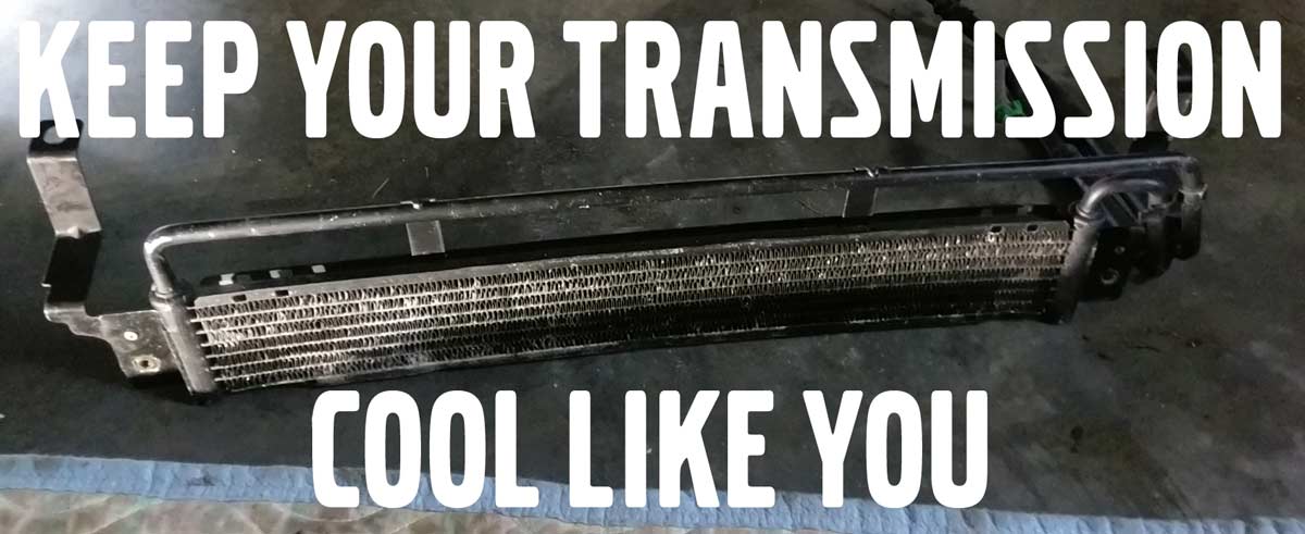

  • S60 Transmission Cooler
  • 3/8″ Hot Oil Rated Hose – about 3 ft
  • Transmission Cooling Hose Retainer 9485149 – 1
  • Transmission Cooling Hose O-Ring 988840 – 2
  • 3/4″ Hose Clamps – 6
  • OPTIONAL but HIGHLY RECOMMENDED – Magnefine 3/8″ Transmission Filter
  • 7/8 Open End Wrenches – 2 (preferably thin type)
  • Dremel or Angle Grinder with Cut Off Wheel
  • 1″x6″x12ga Stainless Strip (any strip will do in a pinch, but this will get abused and rust!)
  • 3/4″ 1/4-28 Stainless hardware set (Bolt, 2 washers and Nylok Nut (or split washer and regular nut)
  • Various Hand Tools to work with hoses, clamps and removing the Swage Fittings on the hoses
  • Drill with 1/8″ and 3/8″ bit for removing aluminum rivets and drilling SS Strip
  • OPTIONAL – Hose Cutter for nice clean hose cuts

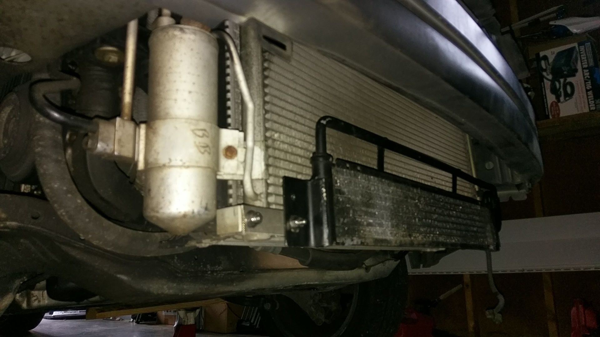

V70 transmission cooler installed
I have tried all the basic stuff, from Fluid Changes to Adaptation Runs. I rebuilt the Linear Solenoids yet nothing seemed to work to completely eliminate the harsh shifts after a bit of heat. Heat was the basis for the issue, so what is the best way to remove the heat? An Aux Cooler, right? Now getting an Aux Tran Cooler is no biggie, right? $80 online and you got it, but you’ll have to mount it and then figure out how to plumb it into the system. I took a little more OEM approach.
While searching for Trans Coolers on-line, I happened across Roberts (RSPI on the Forum) DIY for this cooler on a P80 platform. Hmmmmm It’s Volvo. It’s going to fit OEM or damn close. The fittings are all there making plumbing a snap. Yeah… SOLD!!! Once it got to me in the mail I cleaned it out thoroughly (no sense in putting someone else’s gunk into my trans!!) and started planning!!
