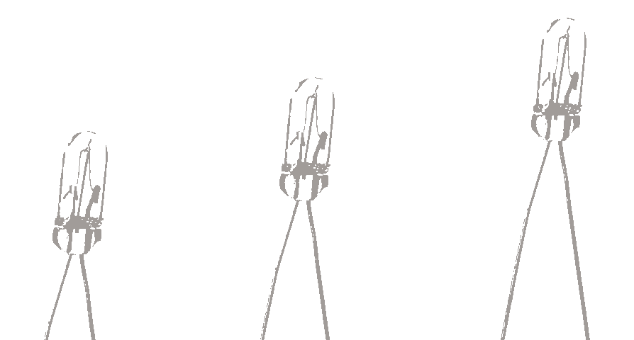

I just found a source for bulbs for the dash switches on a ’96 Volvo 850 T5 sedan. They are # 7219 from Bulbster.com. You have to reuse the little white Volvo holders, but they are only $2.14 each instead of $8+ with the holders. They are T1, 12V, .7W, wire lead bulbs. Simply remove the old bulb from the holder, install the new bulb, and trim the excess wire lead. They seem to match the brightness of the one I had that still worked.
I also found the bulbs for the heater control panel. These are # e74 and are $1.55, T1 1/2 14V, 1.4 W, sub-min wedge base (european) and worked perfectly.

Found them at Radio Shack in packs of 2 for $2
12V Microlamps (2-Pack)
Model: 272-1092 | Catalog #: 272-1092
Found them even cheaper at Bulbtown.com $1.45 ea without base.
