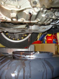

In addition I already had a 10 qt oil drain pan (the image was taken after I drained the transmission the first time, it was clean and this is indeed the old ATF in the pan, not oil).

In conclusion, the drain and fill method was very easy and straight forward. I am very satisfied with the results and after returning 3 qts back to the dealership the whole process cost me $63. As mentioned before, the original fluid was by no means burnt or in any way in bad shape, but certainly discolored. Now that I have done the ATF replacement, I will keep a good eye on the fluid level and looking for any leaks in the future. The shifting of the gears is very smooth (did not have any issues prior) and I will do this again in about 50,000 miles.
