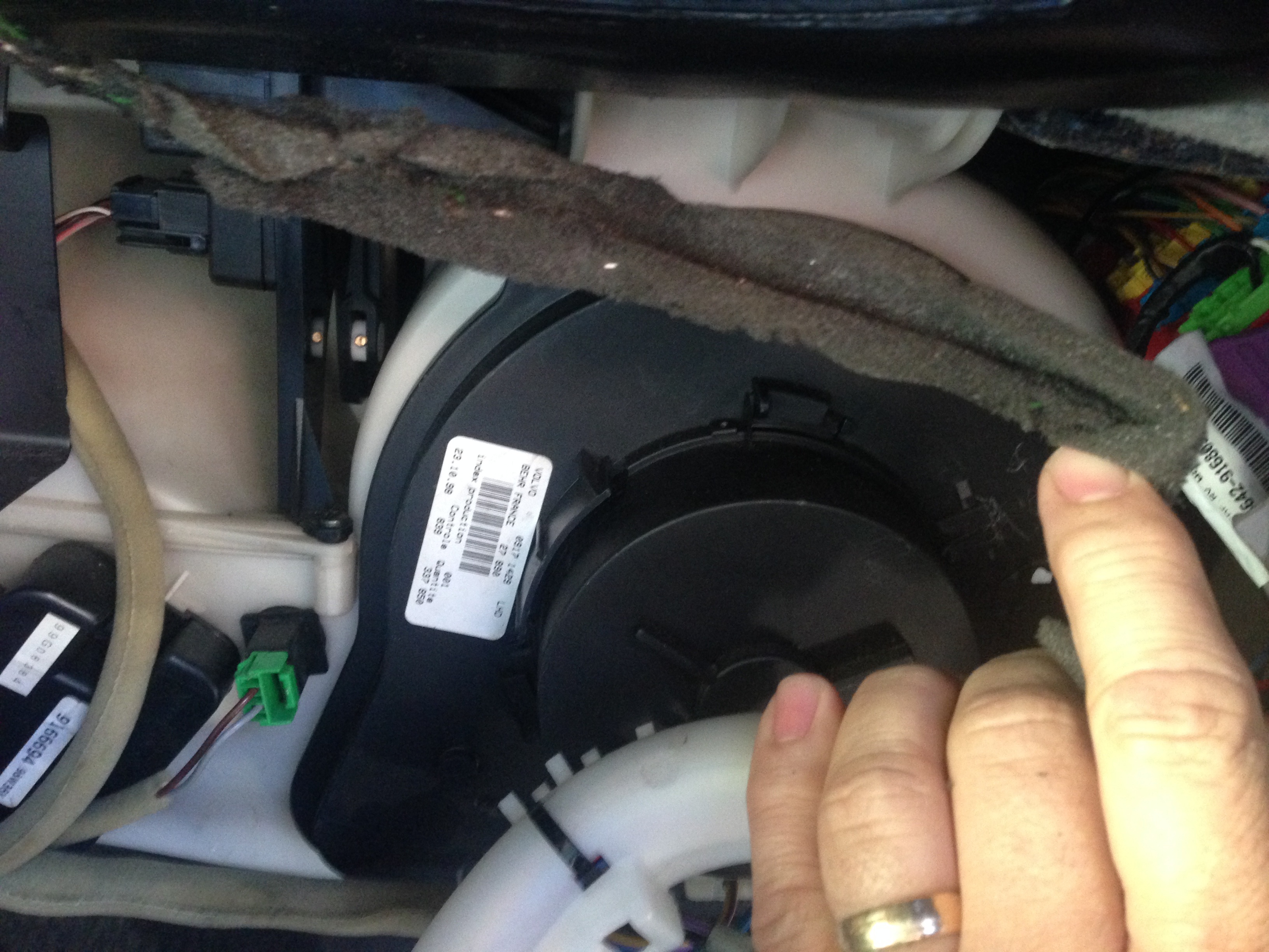

Update. While waiting for the kids in the driveway for school, I pulled the glovebox and put pressure on the white fan connector and the fan started running. It runs at low speed, sounding like a sick whale, but with more pressure runs at full speed.
It looks like there is some wiring in the housing between the actual fan motor (80 USD from a MVS supporting-vendor) as opposed to the whole blower/cage/fan assembly (180 USD from same)
I don't have time to troubleshoot so I ordered the whole cage and will report back some useful diagnostics so that others can diagnose motor vs motor/fan/cage problems.

Update - cleaned contacts over lunch, and fan started up. It is still speed dependent on pressure on the connector, so Im not happy with this as solution. New one on order comes tomorrow.

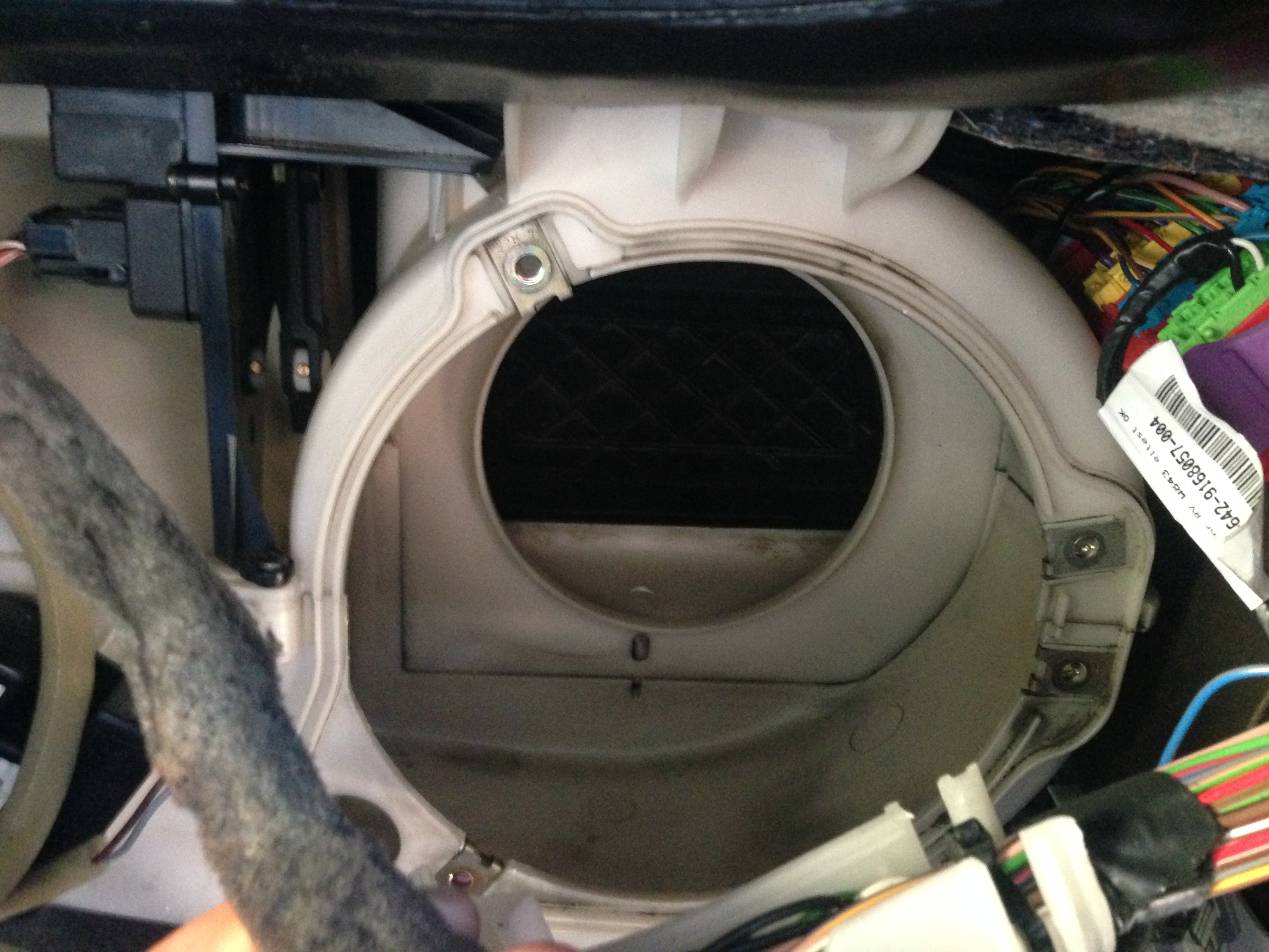

Swap took 10 minutes. EZ PZ.
I couldn't get the blower cage off the old motor so I'm glad I replaced the whole thing.
