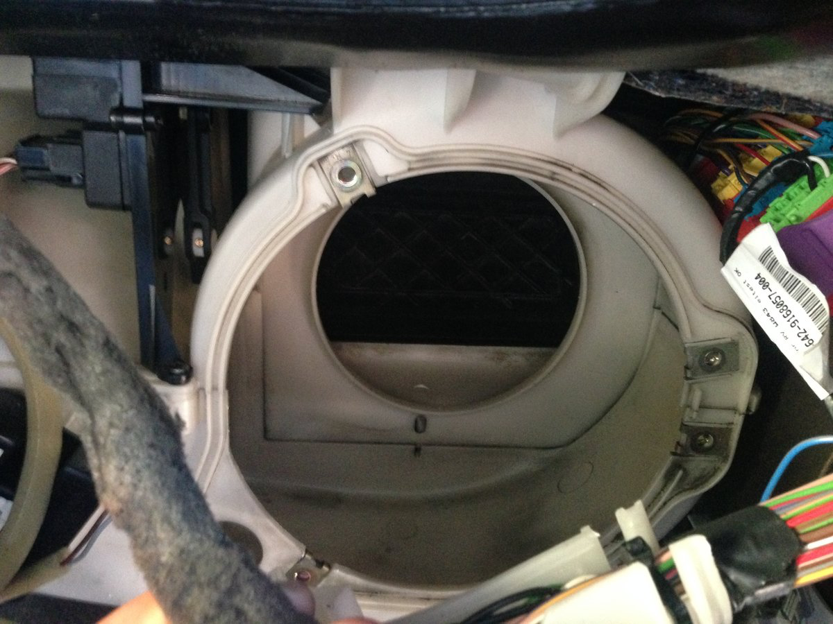

abscate » I pulled the glovebox and put pressure on the white fan connector and the fan started running. It runs at low speed, sounding like a sick whale, but with more pressure runs at full speed.
It looks like there is some wiring in the housing between the actual fan motor (80 USD from a MVS supporting-vendor) as opposed to the whole blower/cage/fan assembly (180 USD from same)
I don’t have time to troubleshoot so I ordered the whole cage and will report back some useful diagnostics so that others can diagnose motor vs motor/fan/cage problems.
abscate » Update. While waiting for the kids in the driveway for school, I pulled the glovebox and put pressure on the white fan connector and the fan started running. It runs at low speed, sounding like a sick whale, but with more pressure runs at full speed.
