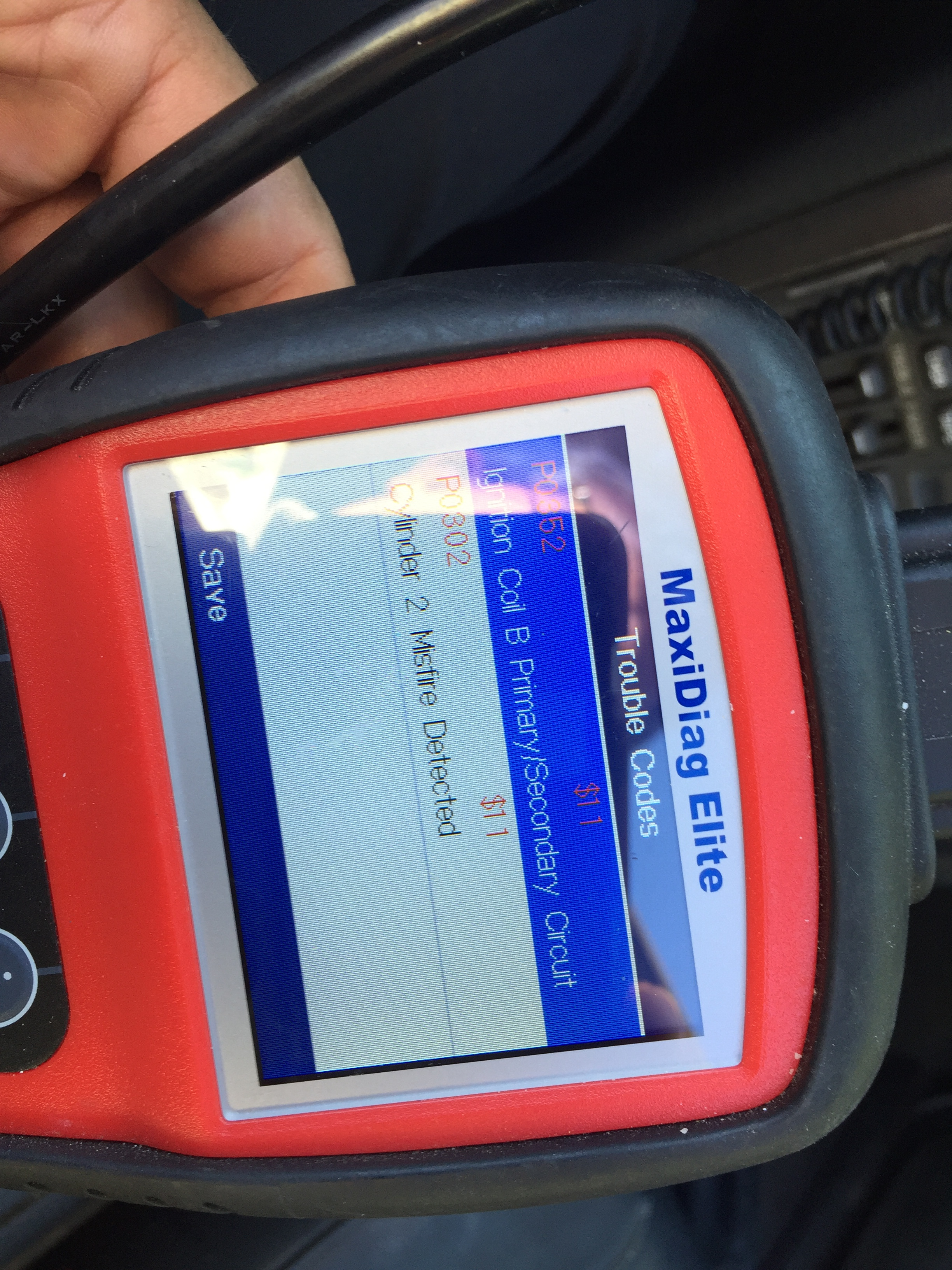

I was able to reach my ObD in the glove box and read codes, and had two...P0352 #2 coil primary failure and #2 misfire P0302

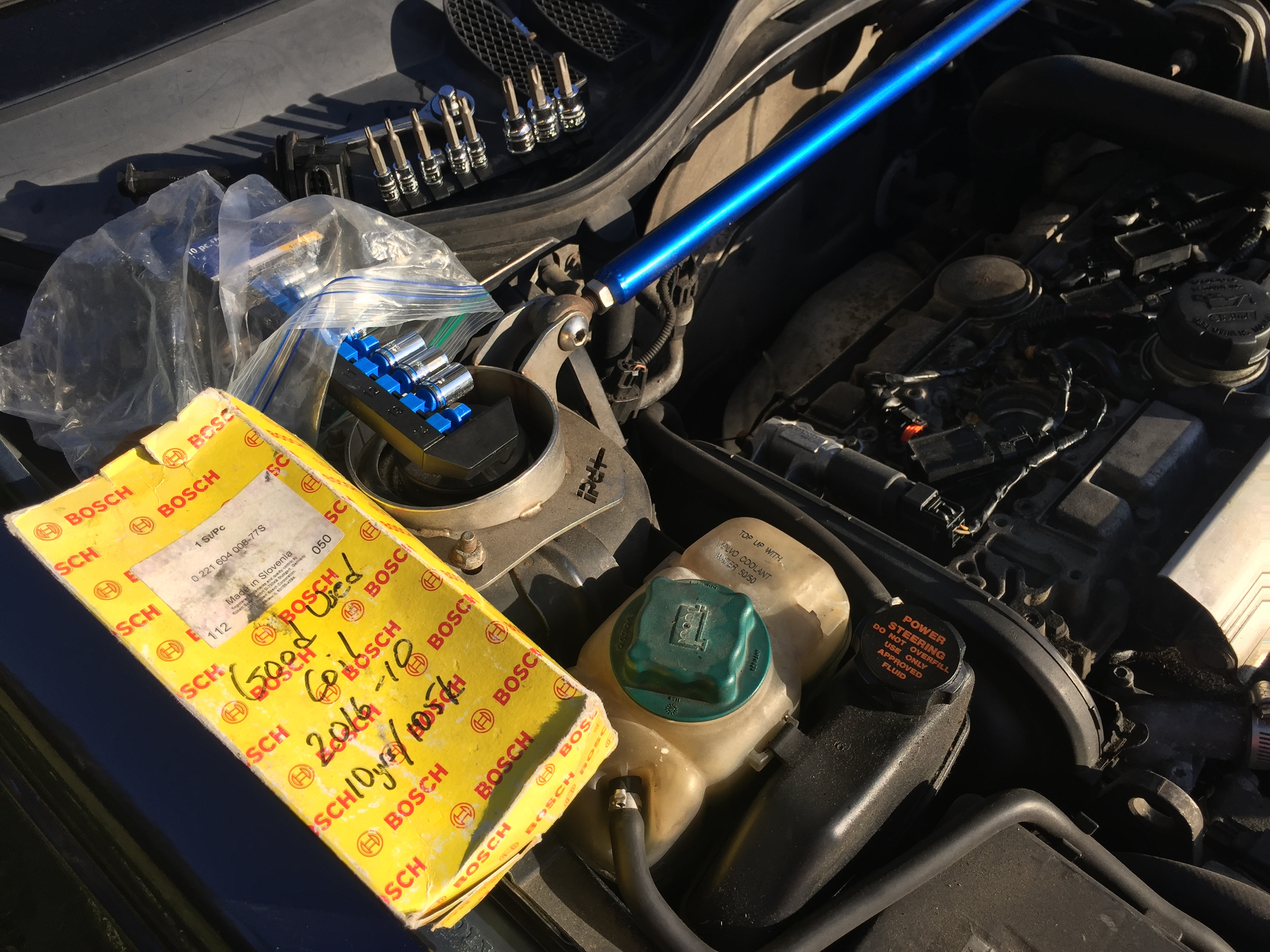

I pulled over, T25 for cover, M6 for coil screw, spare coil from parts kit, installed and miss cleared. I will test today on the drive home.
