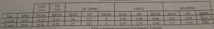

My car failed it's second California smog check today. This time NO levels exceeded both the 15 and 25 mph limits. The emissions were even higher regardless of a new cat.
- Temperature gauge looks normal
- Car does not have EGR system
- I could not find any obvious vacuum leaks
- Throttle body was clean
- Engine is stock with exception for the 960 throttle plate
- Two new O2 sensors (never shown any codes)
- New CA certified universal Magnaflow 46006 catalytic converter
- Mileage near normal
- Engine was warm during test
- Intake hoses seem properly connected
- Timing belt recently replaced
I suspect that the PCV system needs to be cleaned/replaced. It hasn't been touched in 132K. The dipstick hole does smoke a little. I understand that a clogged PCV may cause too high temperatures causing high NO levels.
The PCV replacement instructions scare me a little. Does anyone have any other recommendations before I replace it?
Thanks.

What kind of gas are you using?
Generally NOx goes up as timing is advanced. Maybe regular gas would cause it to retard the timing and reduce NOx. Do you ever get any pinging? If so maybe the knock sensor is bad or something, causing too advanced timing. Don't know for sure about Volvos. And could your timing be off if your cam was off a tooth, since it drives the distributor? Or if a cam is off a tooth, that could affect air flow timing and NOx I suppose.
