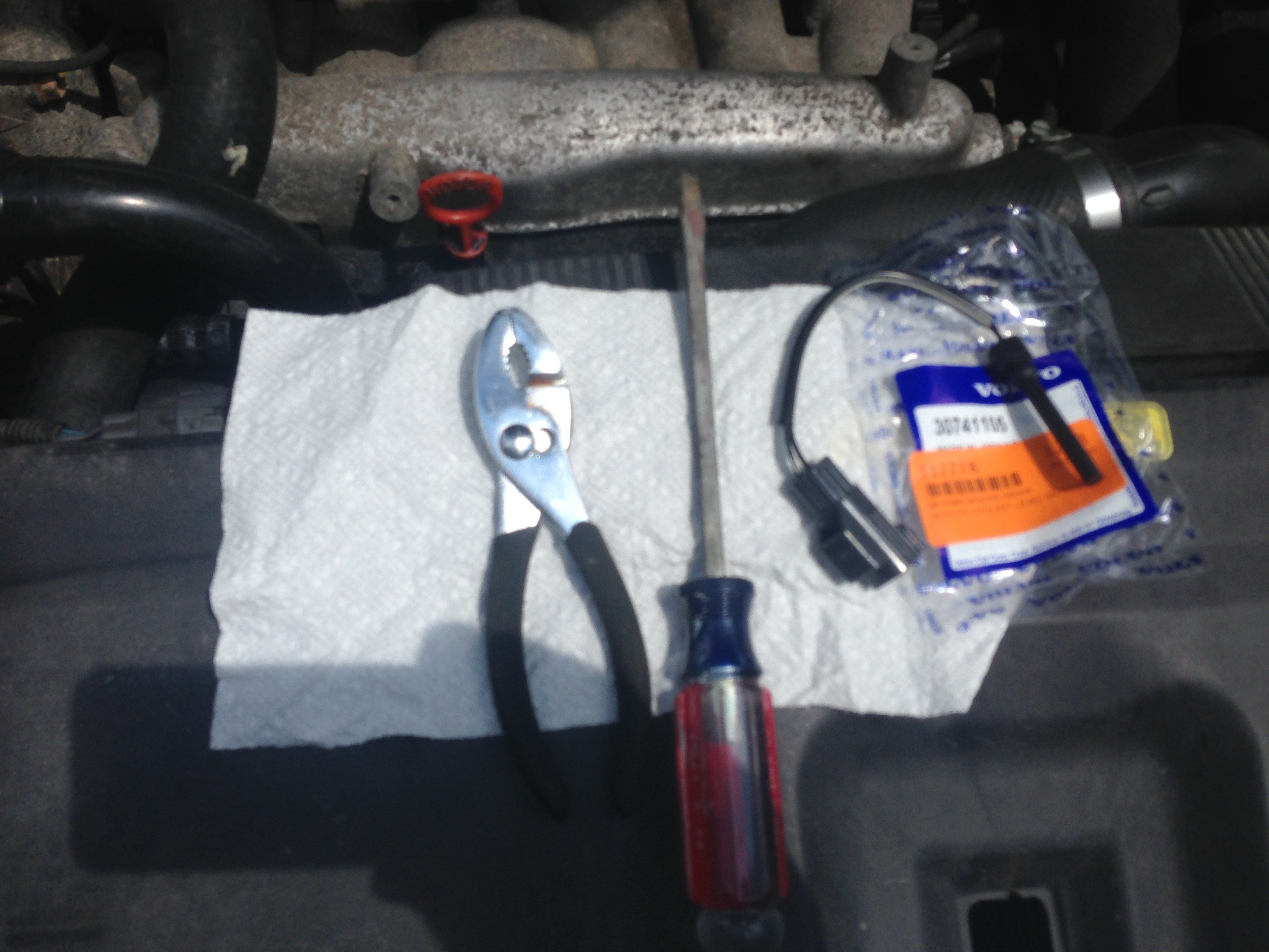

Tools needed (I have no idea why I put screwdriver in there)

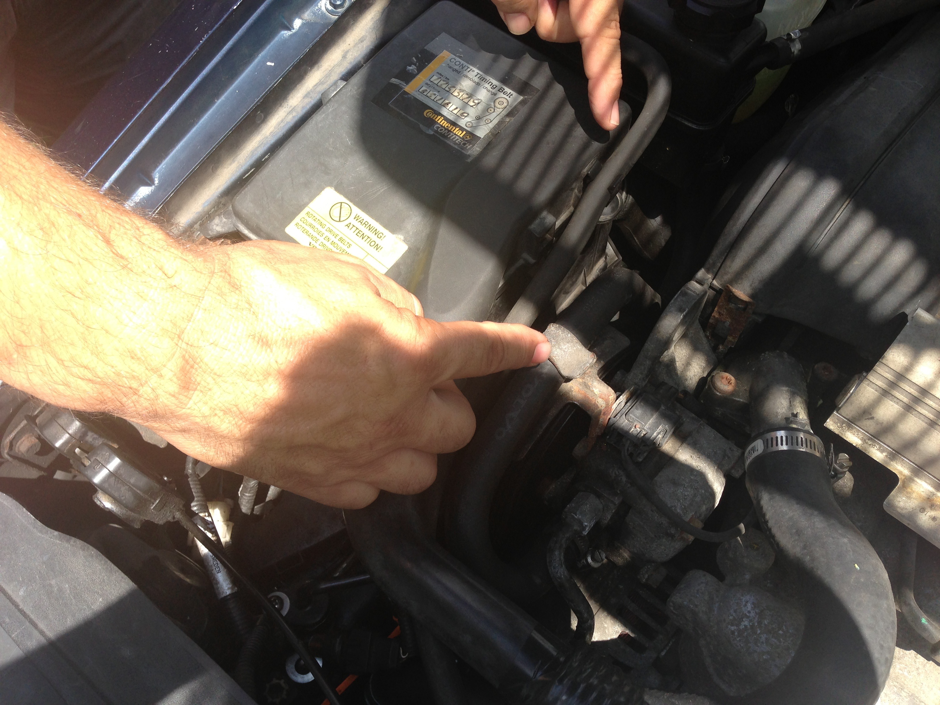

Pop the power Steering hose and coolant return hose out of the clips as shown

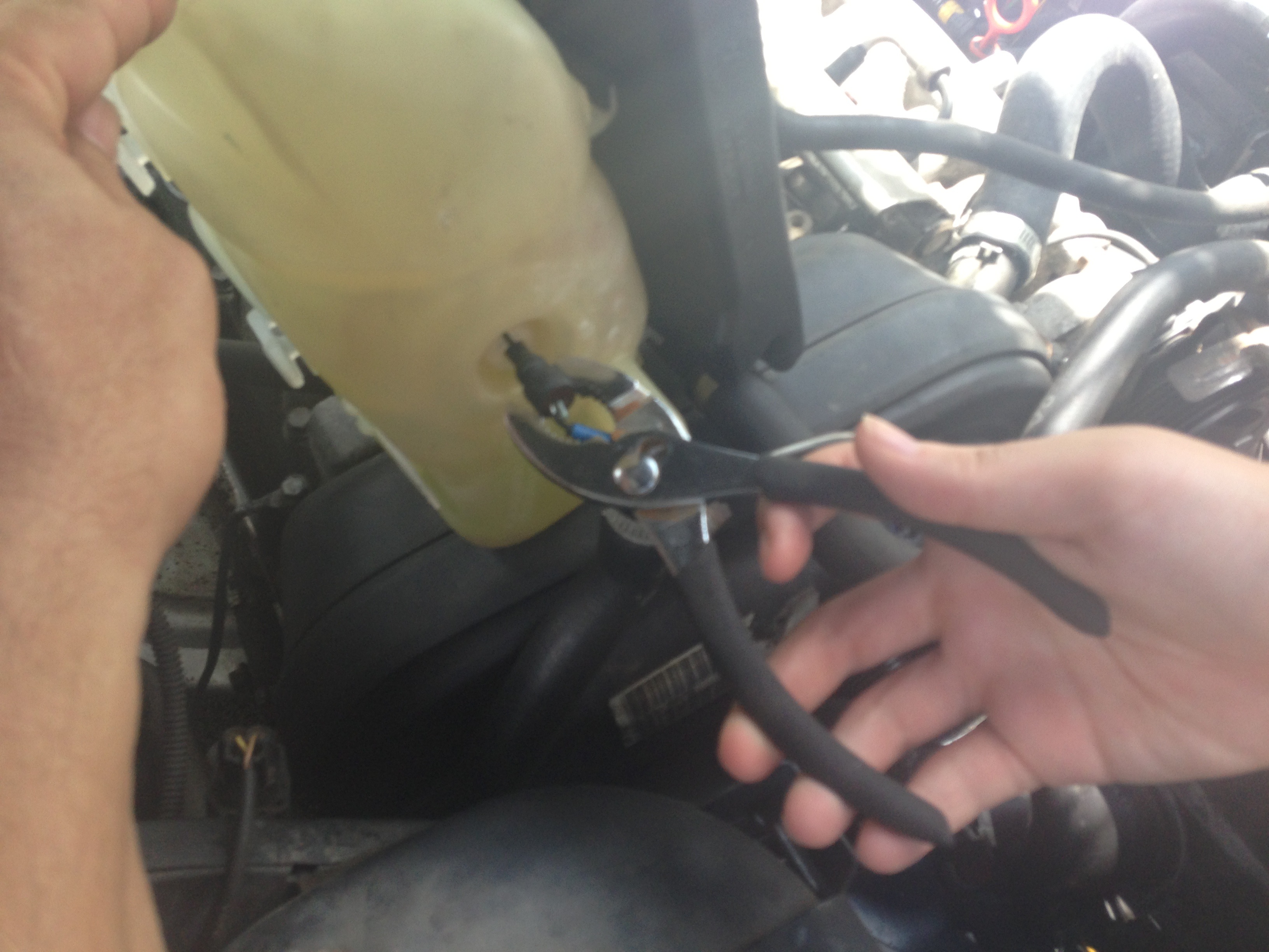

Tip up the Coolant reservoir and P/S reservoir (no need to separate them) to expose the sensor
Abby is grabbing the end with pliers - the sensor goes up into a plastic tube so no coolant comes out when you pull it.

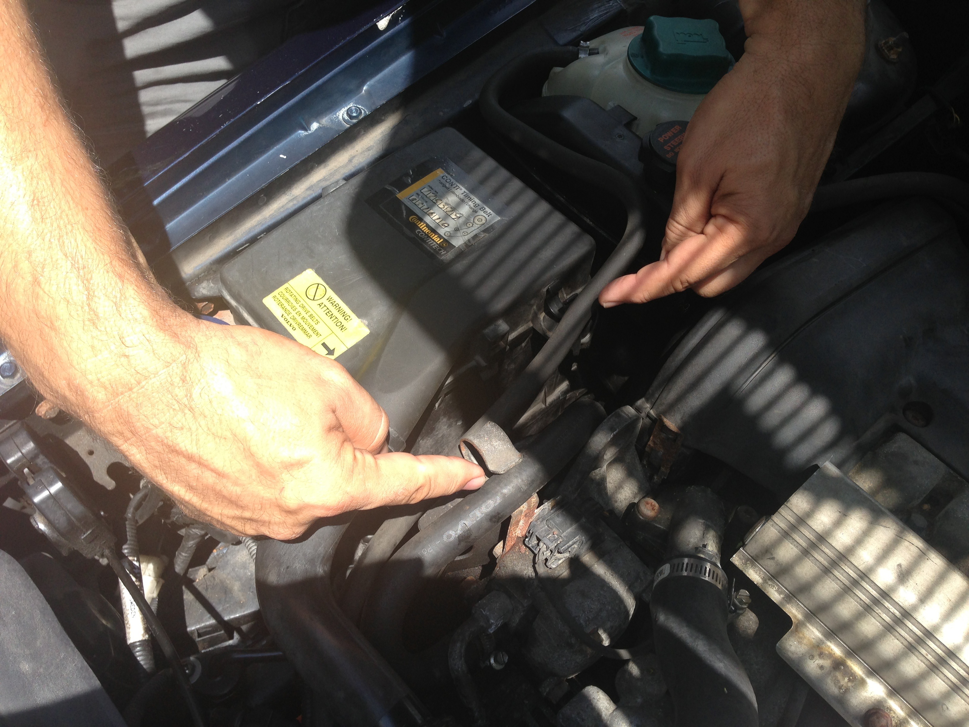

Reclip P/S and coolant hoses
Abby removes sensor with pliers grabbing thick rubber part - new one sticks back in with finger pressure
unclip P/S and Coolant return to allow reservoir to tip up
Need pliers and sensor - part number 30741155
