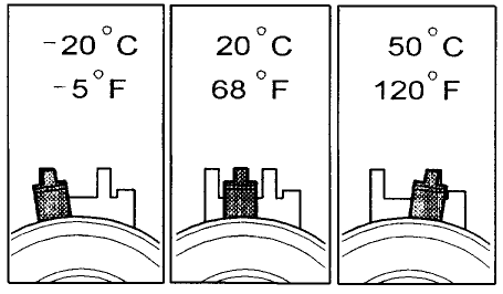

Hopefully, the photo below will help make things a bit more clear (in addition to the youtube video posted previously).
- The mechanical tensioner has an eccentric design, i.e., as the adjusting tab "A" is moved, the axis of pulley rotation is changed to adjust the tension on the TB.
- The first step (once the TB is in place) is to "over-tighten" the TB a bit. This is accomplished by turning the adjusting tab CCW with the Allen key to 6 o'clock position. By doing this, the temp indicator "C" will move in opposite direction to 1 o'clock position. Now the TB is over-tightened to remove any slack during installation.
- The next step is to bring the TB tension back to normal operating condition. This is done by moving the adjusting tab "A" from 6 o'clock position ---> 7 o'clock position. By doing this, the temp indicator "C" will move from 1 o'clock position ---> 12 o'clock position.
- Now tighten the Center Bolt to spec.

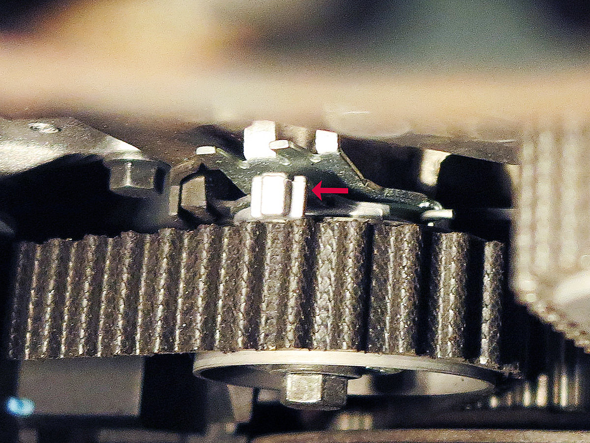

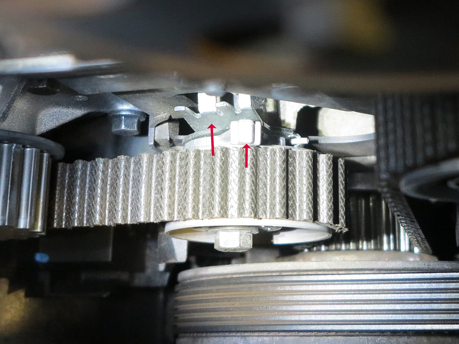

I was following this thread, and last night I took off the TB cover to find the tab at 1 o'clock position. Here is the picture. I had taken the steps cn90 showed so well by diagramming it, and set the tab at 12 o'clock. This was few week ago.Ozark Lee wrote: ...
It can't hurt to take the timing belt cover off and have a look while the engine is running just to satisfy your curiosity.
...Lee
So now tab at 1 o'clock NOT 12, my questions are...
1 - engine was warm-to-hot when i took the picture, did the tab move with engine temp?
2 - how does 1 o'clock position compared to 12 o'clock change the engine's working?
3 - could i simply loosen the hex bolt and reset it at 12 o'clock position as explained by cn90, without removing the belt, aligning the cam marks, and rotating the crank etc.
many thanks!

xHeart,
That tab (temp indicator) is temp-sensitive.
You should check it at room temp, around ~20C or so.
The reason the temp indicator moves is that: as the engine runs, it heats up and the belt stretches a tiny bit ---> TB tension decreases a tiny bit. So the temp indicator moves a bit to the R (from 12 ---> 1 o'clock position), thus the TB is tightened up a bit to take up any slack.

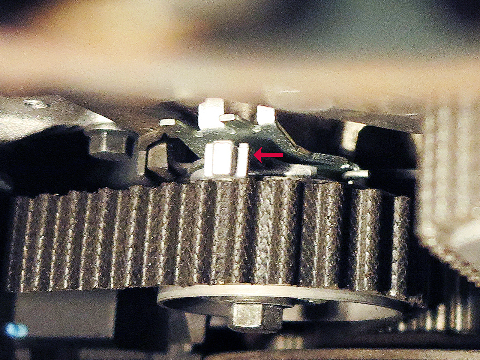

proof positive! the temp indicator returns to cold setting. does it need a reset to be more accurate?cn90 wrote:xHeart,
