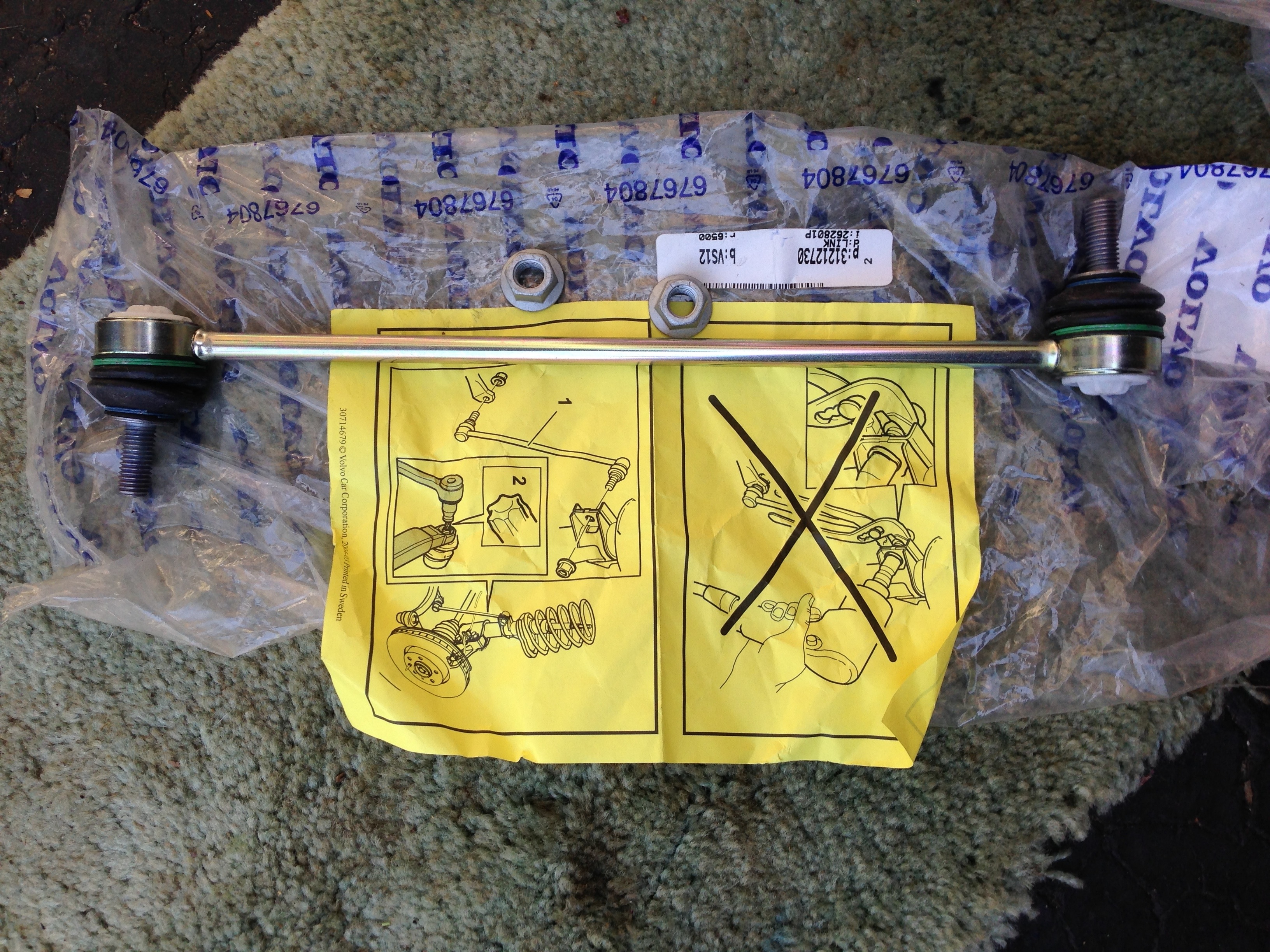

*** Note my stock link nuts were 14mm hex, the replacement (VOLVO OEM) were 15mm hex

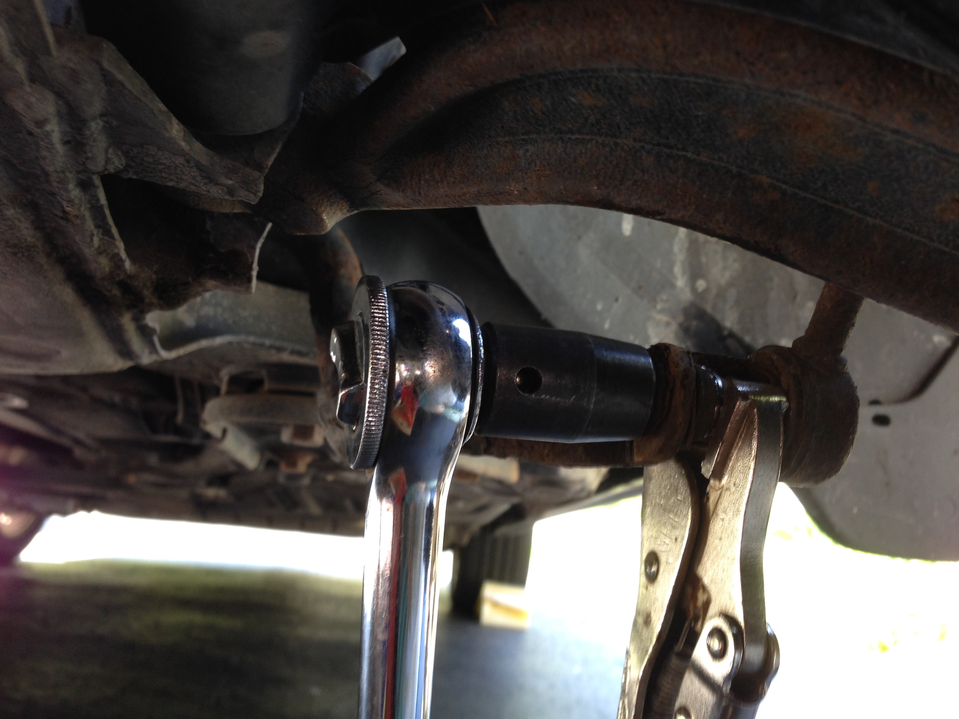

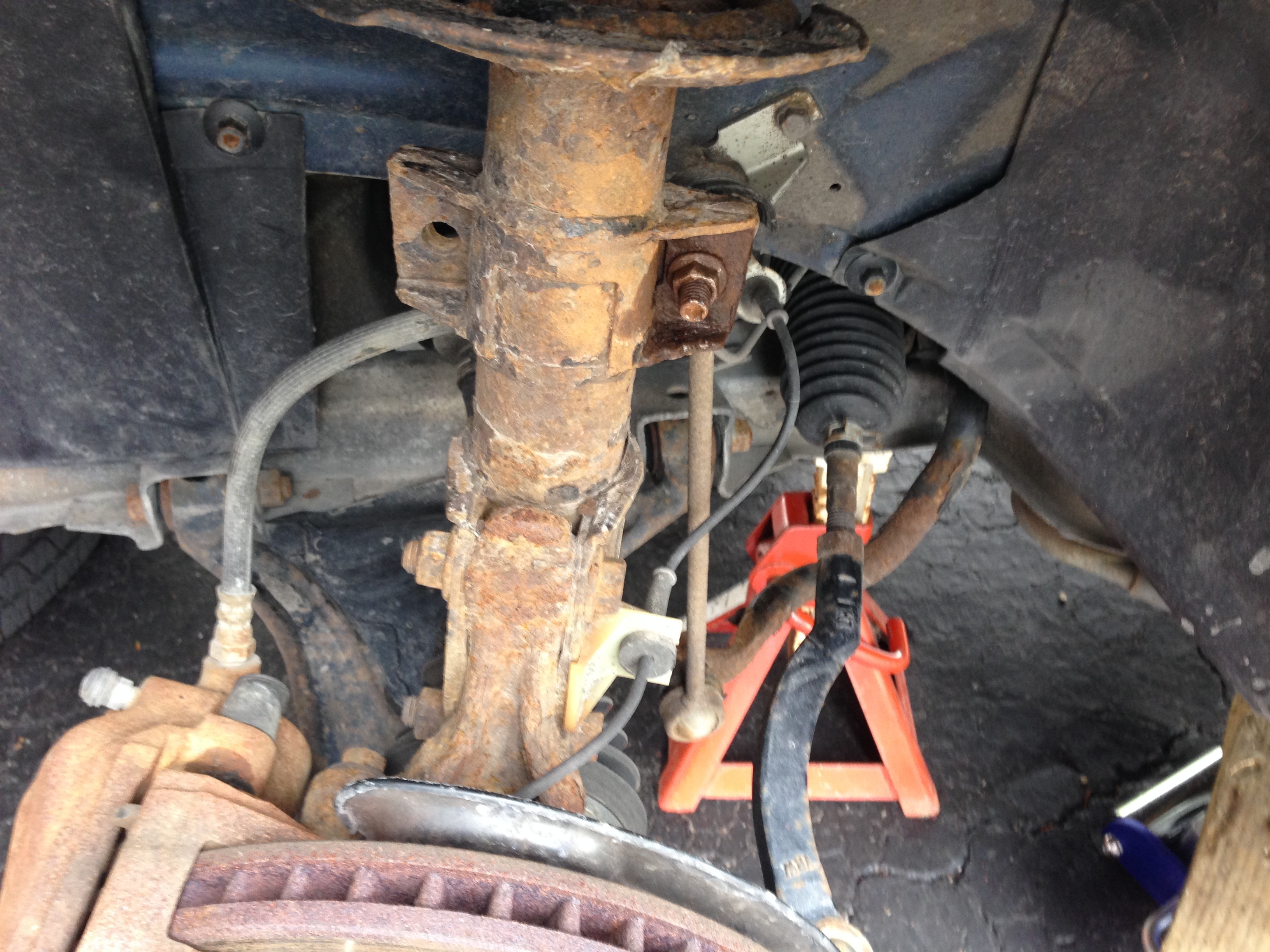

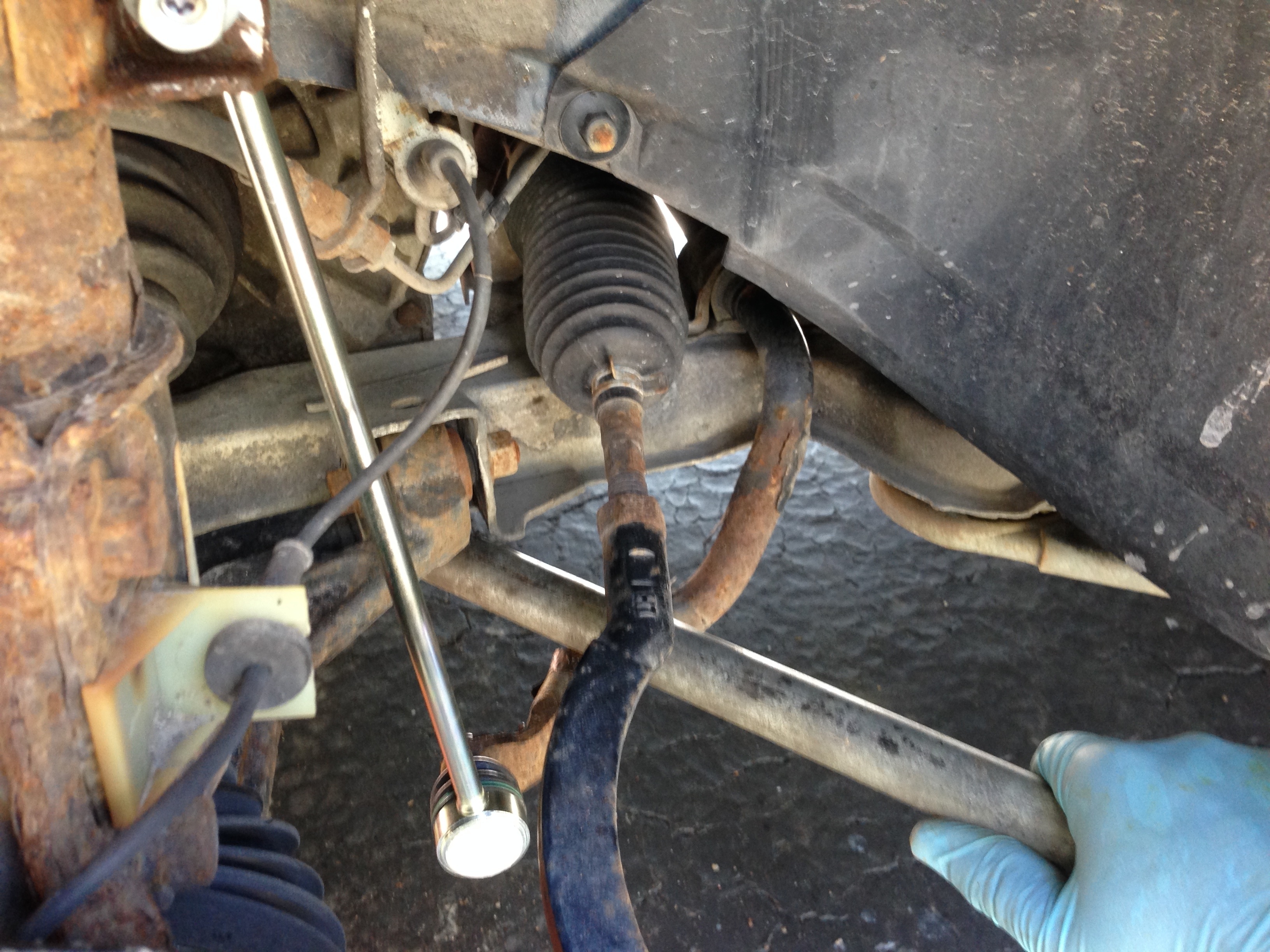

Here is the job. The vertical rod with two ball joints links the sway bar to the strut. The ball joint has a 14 or 15mm nut and an internal TORX 30 screw so you can hold it while unscrewing the nut. All of my Torx stripped out, so I ground one off, and used vice grips on the other three, shown later

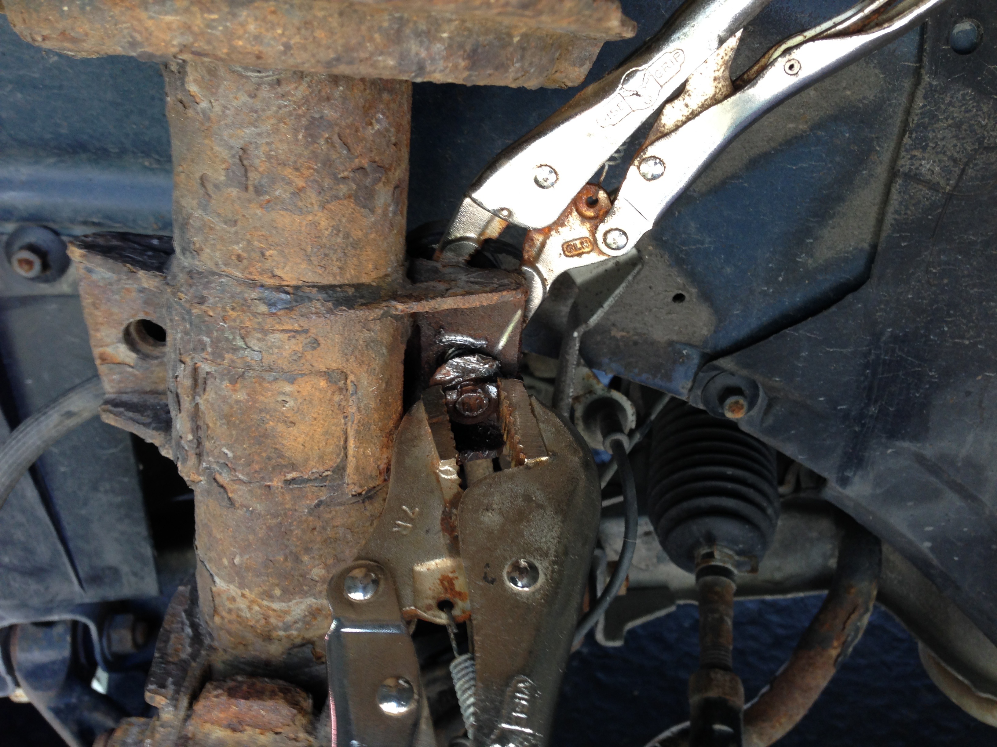

I had to cut the top left link nut with a grinder and finally got it to free from the strut, but it was still frozen on the link ball shaft. I got a needle nose vice grip on the ball area, and then turned the damaged nut off with a fat vice grip.

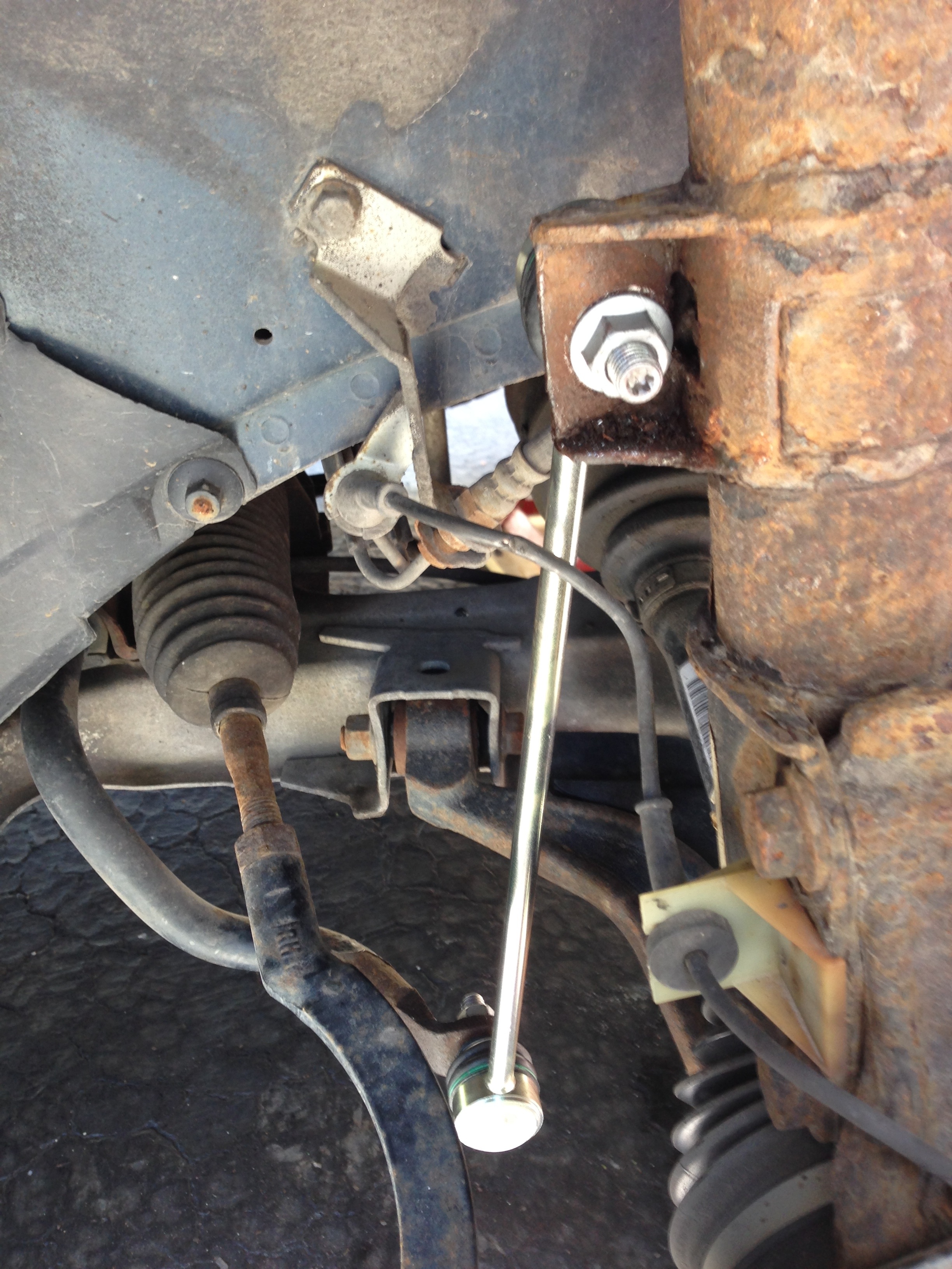

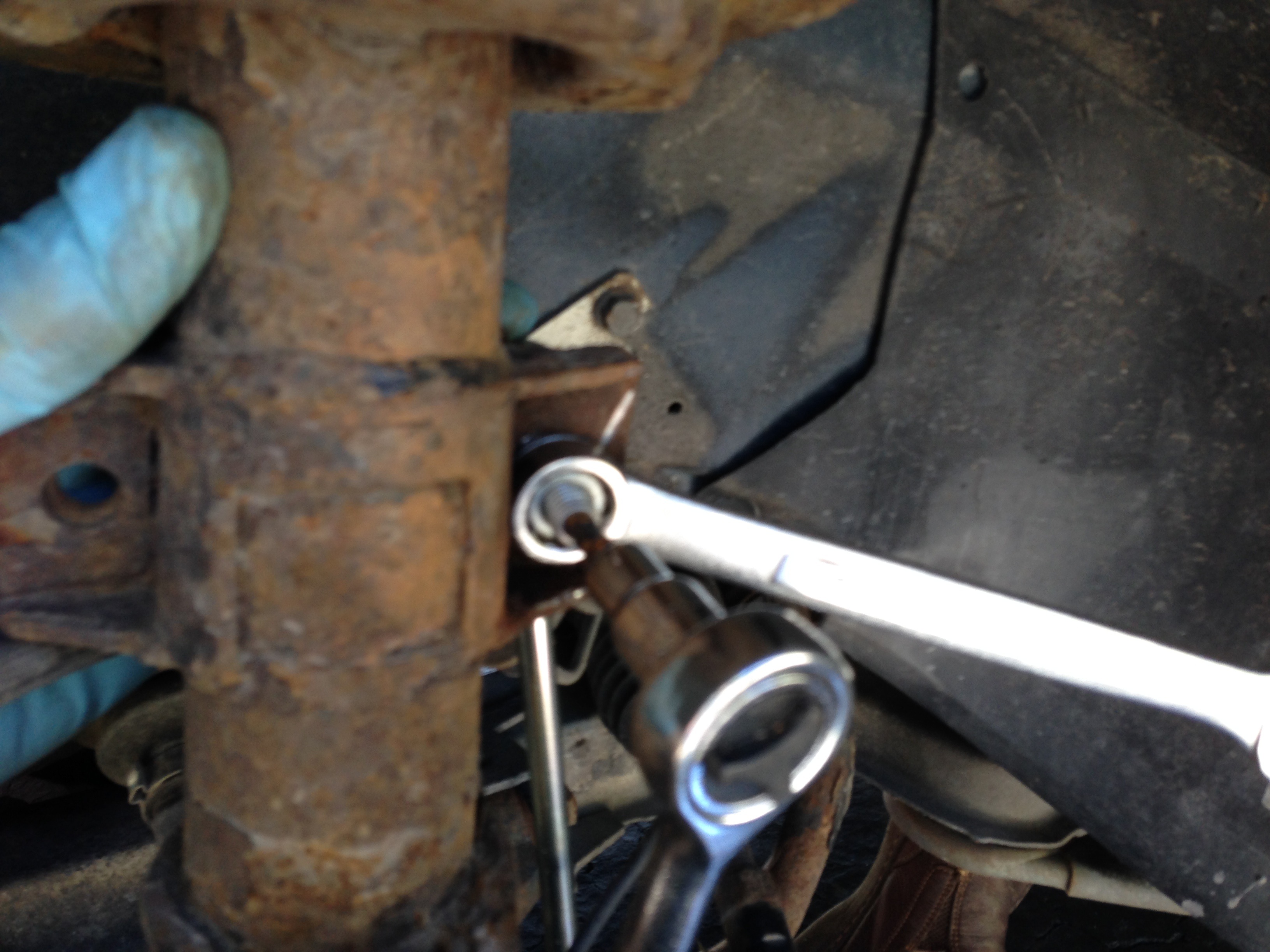

Same trick on bottom, tighten new ones using Torx internal screw, being careful to keep Torx bit deep in threads. You can tension the sway bar with a pipe and modest force to line up the link if the wheel is free in the air.

I wrapped the ends of the link studs with electrical tape to try and keep them from corroding. Time will tell.
