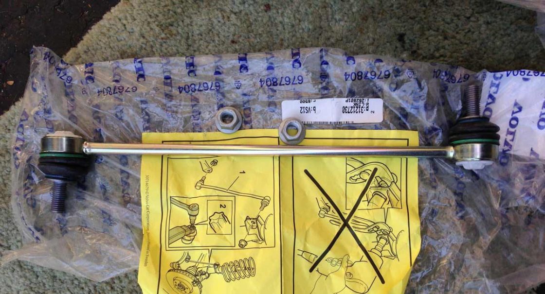

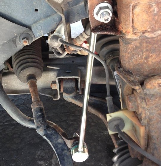

1999 V70 T5 Sway Bar Link Replacement w Pix
Need a Sway Bar Link Replacement ?
MVS Forums moderator Abscate tells what led him to know it was the sway bar end links: “…creaking, groaning, crack on loading the front end. I would occasionally get a crack so loud that heads would turn.”
So what’d he do? He got to work! His documented repair here is a compliment to the other couple end link repairs in the VRD, and his photos and steps are clear & clean.
  1. Block, jack and stand,
  2. front wheels off.
  3. 14, 15 mm wrench, sockets, handle…
