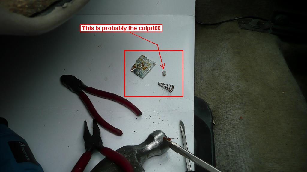

I confirmed that the SW Lock no longer functions: with key out of ignition, the SW is free to move R and L. This confirms that the small little piece (the Steering Lock pin) broke off and jammed the ignition tumbler.

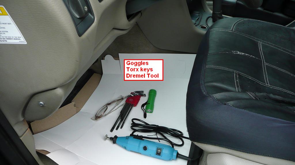

TOOLS:
- Torx keys
- Dremel with diamond cutting wheel (about $25-$30 at local hardware store).

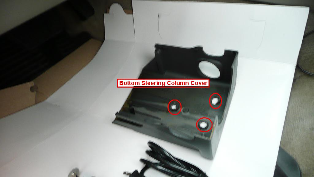

3. Remove bottom plastic cover (3 Torx bolts). Wiggle it out.
During installation, make sure it mates properly with the upper piece, note the rubber grommets fitment around the stalks (wiper, and turn signal).

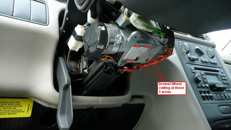

4. Looking up, you will see the rectangular plate. WEAR GOGGLES!
Use Dremel tool to cut exactly at the 3 areas, it will take some 15 minutes.

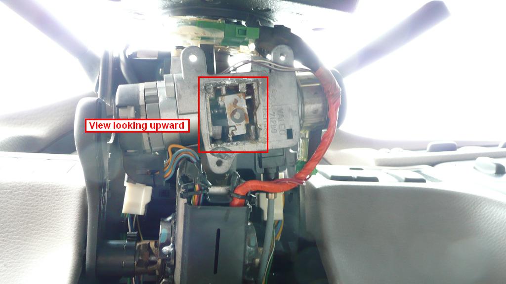

5. Use a flat screwdriver to pry the rectangular plate out, you will see the spring and a small piece falling off. Collect all these pieces, clean them and place them on top your bookshelf as souvenir!!!
6. Leave the bottom of the ignition tumbler open as shown in the photo below, I see no need to cover it.

In the S/V70 series, Volvo always used VALEO as the supplier for the tumbler. When you look closely at the design, the pin that performs the SW Lock function is a flimsy piece of aluminum that broke easily, especially when one wiggles the SW in the morning to start the engine!
OK, I used a magnet to test and I know this tiny piece (see photo above for the culprit) is aluminum.
In contrast the rectangular plate is steel because it sticks to the magnet.
Now I am thinking about this (removing the rectangular plate) as a preventive maintenance if one does not want to get stuck in the middle of nowhere. Some people have to tow the car to the dealer. Some people are savvy enough to remove the electrical portion of the ignition switch and use screwdriver to start the engine. But if one does this mod upfront, one will never have to deal with this again (key stuck in position I), ever.
