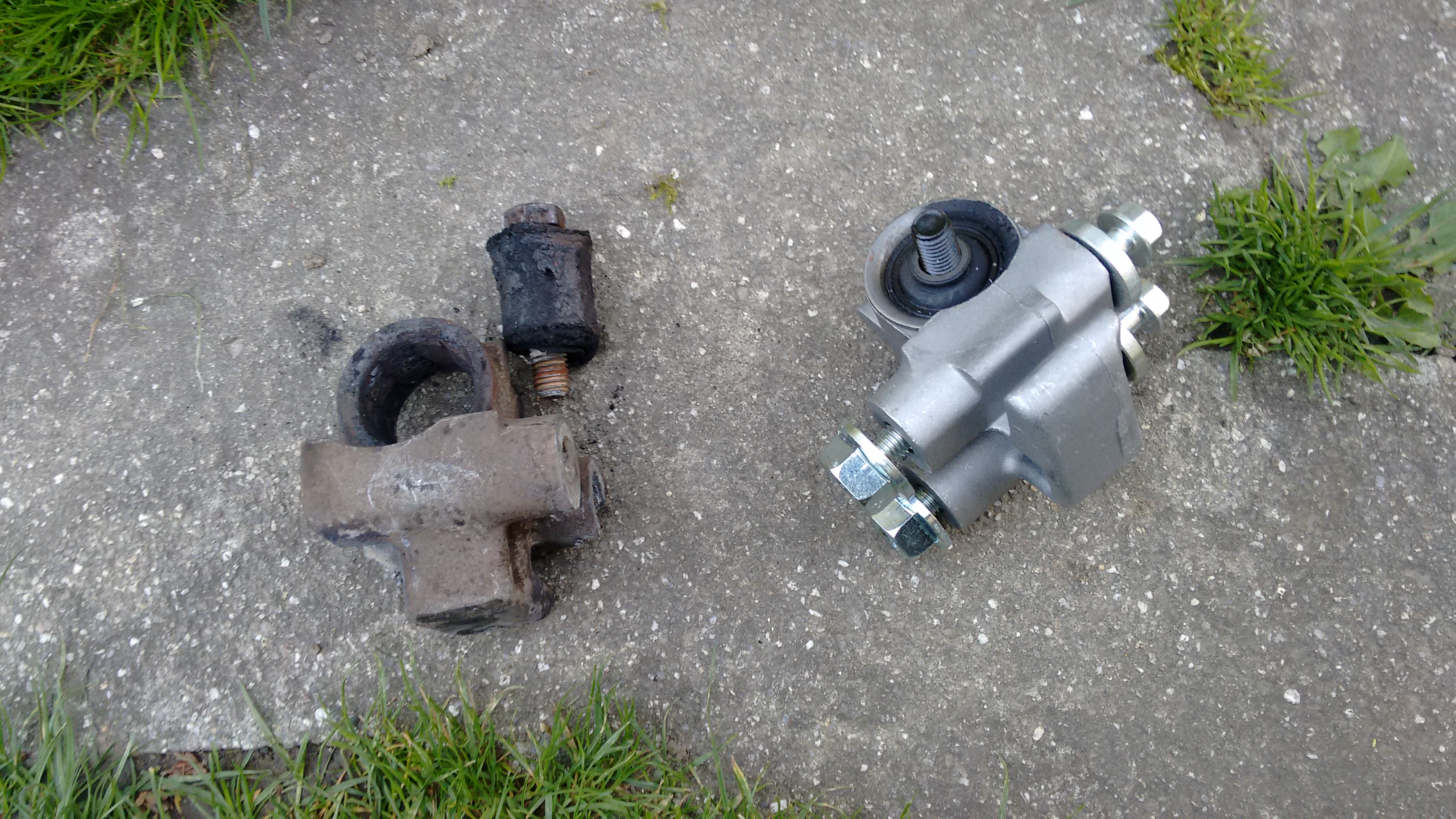

I Think the rear suspension is the cause. it is in bad shape, the arm mounts are worn out.
I already bought all parts I need: 2x arm mounts, 2 steering links, volvo tool, break hoses and I also have the ipd sway bar laying around that needs to be installed.

By the way, this is solved, problem were worn rear suspension mounts/bushings.
After replacing all 4 the car drives fine
Picture inline, copied to MVS server:
