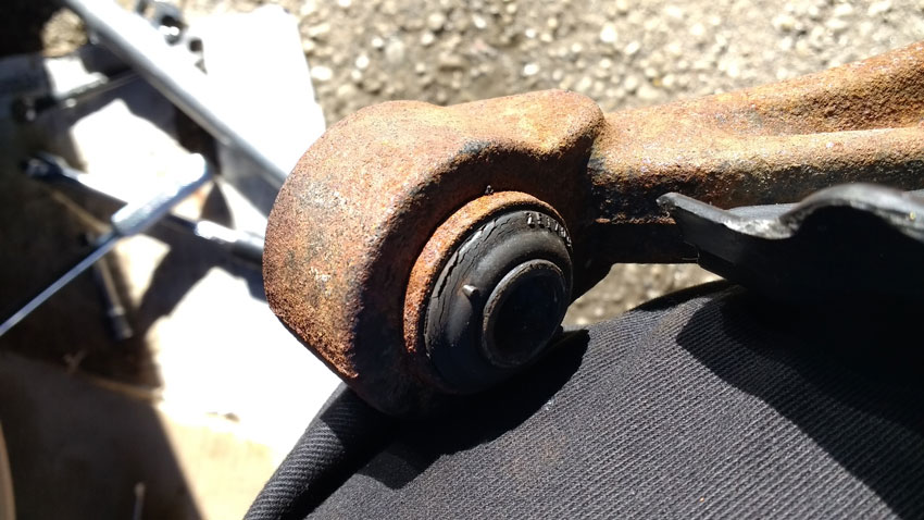

No idea if I've figured this out.
But...
I replaced the sway end links with Lemforders. (The Karlyns weren't too bad though...)
One of my control arm (driver's side) had bushings with crazy cracks on it... :(
The other control arm had a noisy ball joint. :o
Both were replaced with Meyle HDs and are being shipped back to FCP tomorrow.
Don't know if this will take care of the KER-FLUNK, but certainly looks like there were things that need to be replaced... And yes, I know I should have gotten Lemforders... :roll:

Not too bad - Im not even sure the rubber has let moisture into the interior space. I bet that loose ball joint is it.
Didn't we jack this up and look for looseness before? This is one of the times it pays to be up in the air where you can really wiggle stuff to see whats going on.

balljoint is the 99% culprit.
