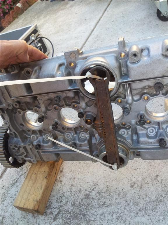

My 99 NA had no VVT at all and hydraulic lifters. I also have a customer with a '99 NA with no VVT that I service regularly.
My 2000 NA had intake VVT with solid lifters

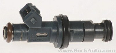

Precopster, I'm not doubting that you have a 99 w/o cvvt but it is not a US certified model. Does that car w/o CVVT have an ETM or a conventional throttle with cable? Does it have the intake manifold with an air control valve controlling air to the rectangular air manifold that the area from injector electrical connector down to the tip of injector just above the intake hole for injector? The 99 NA 5 cylinder US models do.

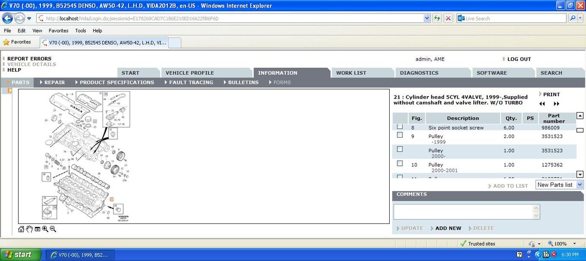

Hi jimmy On Vida look up B5254S under AME profile (USA) and you'll see two identical cam pulleys part number 3531523 QTY 2.00 for the 1999MY.... Which indicates NO CVVT
The pulley part numbers change for the 2000-2001 MY with unique pulleys for intake and exhaust indicating CVVT on one cam.
All the 1999 V70s I worked on were B5254S with ETMs (I've worked on at least 5 or 6 of them)

I'm not doubting you've seen what you've seen but Vida confirms what I'm saying on my 2012B version
