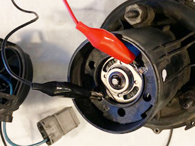

I'll do the same with #19 as applying 12v to the motor in air pump, i.e., directly applying 12v, like this -- unless you say otherwise:

Yep that works.

Just touch the other lead to the battery posts, and remember the motor might kick when it runs (Newton)
If you connect it and they get stuck and fault, when you go to remove them you will blister your fingers.

abscate wrote: 06 May 2019, 15:32 Just touch the other lead to the battery posts, and remember the motor might kick when it runs (Newton)
He's already been through that (Einstein!) for the motor. Is asking about testing the solenoid. You're in sales, should know better than to get fooled by the graphics!

#19 solenoid passed! DOES IT WORK LIKE A SWITCH?
The connection nipple for #22 holds vacuum and releases with click after a 12v charge. Whereas, nipple for #18 -- vacuum line to sas valve -- was open.
ALSO, extended the replacement air pump's negative wire -- it too tested ok afterward -- thanks Erik!
