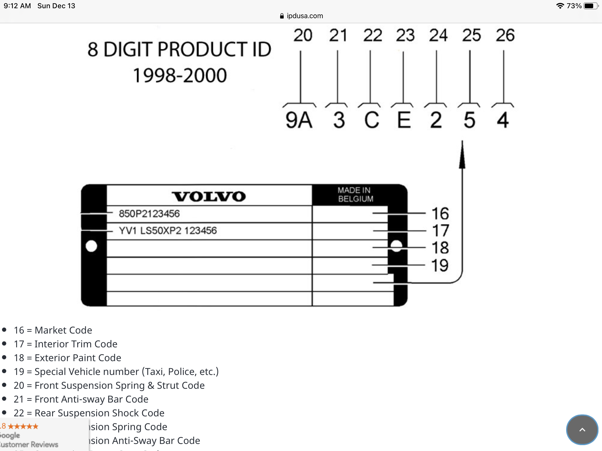

Is this on the 1998 base V70?
I’ll link sway bar codes table...you find these in the plate on the driver fender, under hood
Courtesy of IPD
https://www.ipdusa.com/techtips/10015/w ... it-tell-me
Courtesy of IPD

My 1998 V70 base has the following product ID, line 20: 4F2PEVS5
So, it is marked 2. Is this referring to a color or a specific diameter of the sway bar

Based on the decoding table from the IPD link you provided, the anti-sway bar code is 2 - this would be item or number 21 in above table. I do not know if this helps!

Elizabeth the T5 is sway bar code 2, I’ll go out and measure it in a bit.
What we don’t know is how to map the code numbers to the part numbers above!

Plate code 2 is 21.0 mm bar measures on two Cars this morning
