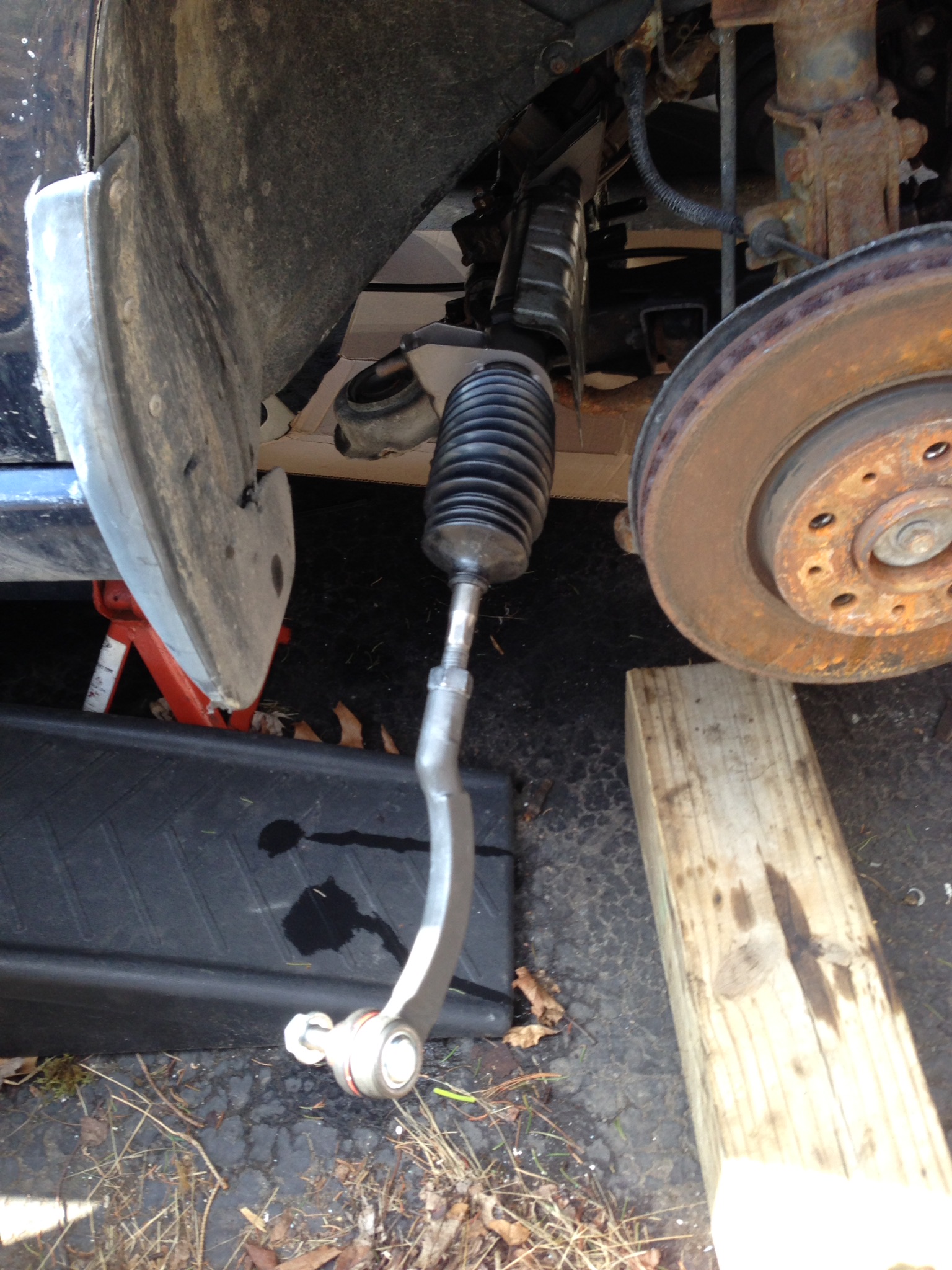

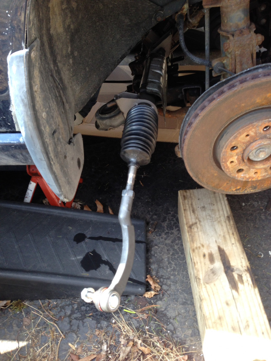

I hung the engine on the cross brace , removed the front engine mount bolts (2M8/ 14mm hex) , removed the front torque mount nuts and cleared the rod from the subframe, then removed the rear bolts/ plates, loosened the front about 1cm drop. This gives about 20 cm drop if the subframe at the rear

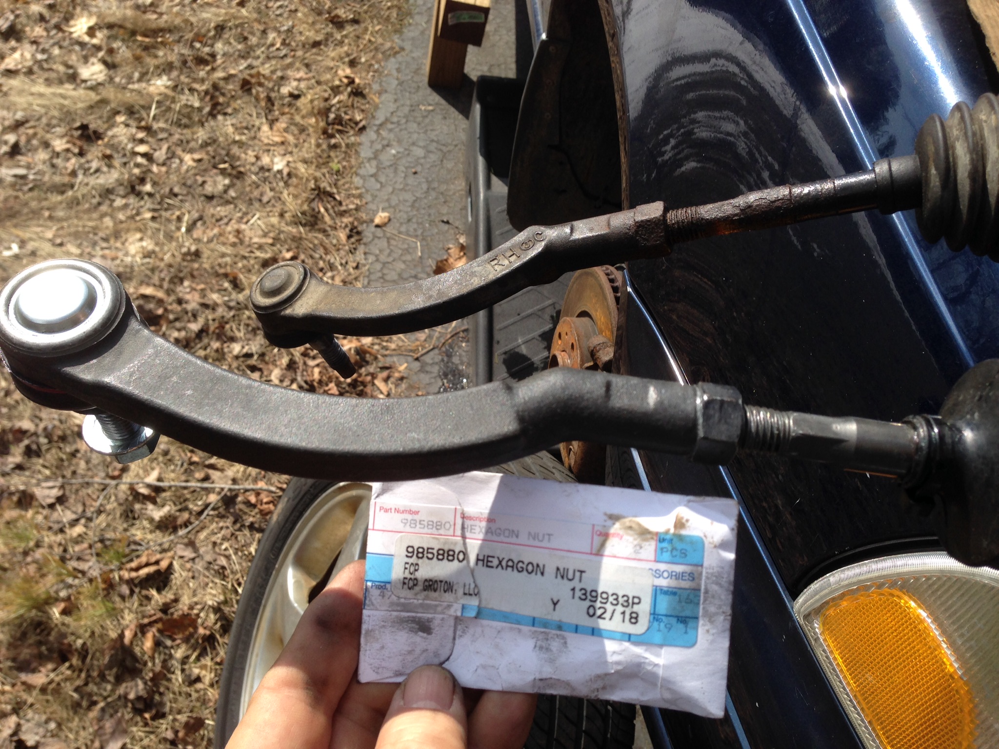

Attached TRW tie rod ends , matched thread count, new lock nuts

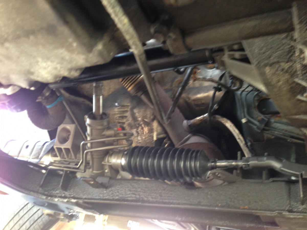

Fed rack in from right, lined up mount bolts

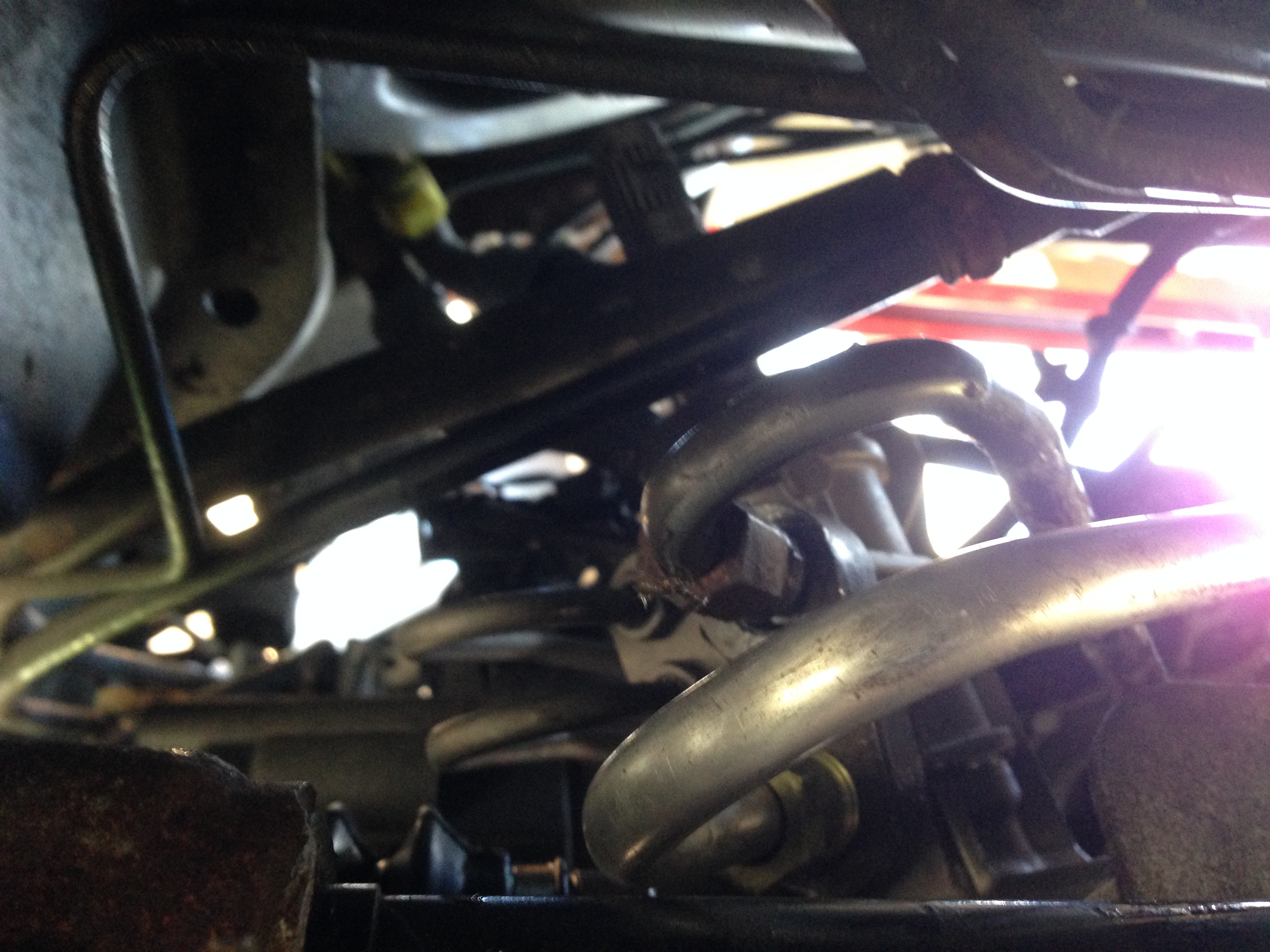

Attached lower return line flare first, 19mm hex
Then attached upper line, 17 mm hex and crows foot

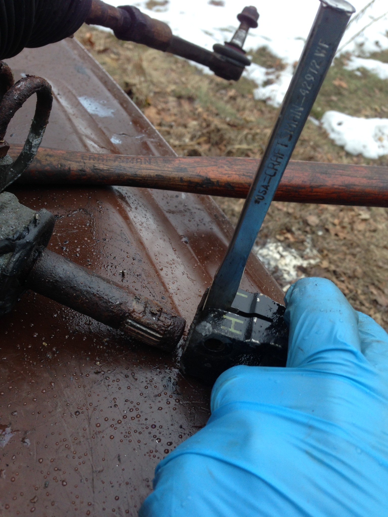

Dropped steering coupler in from inside cab8n. Used the same chisel trick to split the metal block and tapped the coupler down from in cabin with mallet, installed new lock screw

Looking fresh and nice technique on the steering coupler attachment. I should have went that route and I fought that sucker for quite sometime.

If I ghosted someone on that, let me know. That came to be after looking at that, but it might have been inspired here.
Works for both removal and install.

There is absolutely no way to get a flare-nut wrench on those lines in situ.

Unless its an Orange County CA car where rust is when the black bolt paint has faded from its Swedish factory.
Drop subframe, protect stuff ,blast them with heat, and remember if you have to cut one, the return line is 1/3 the price of the pressure line, $300 vs $100
