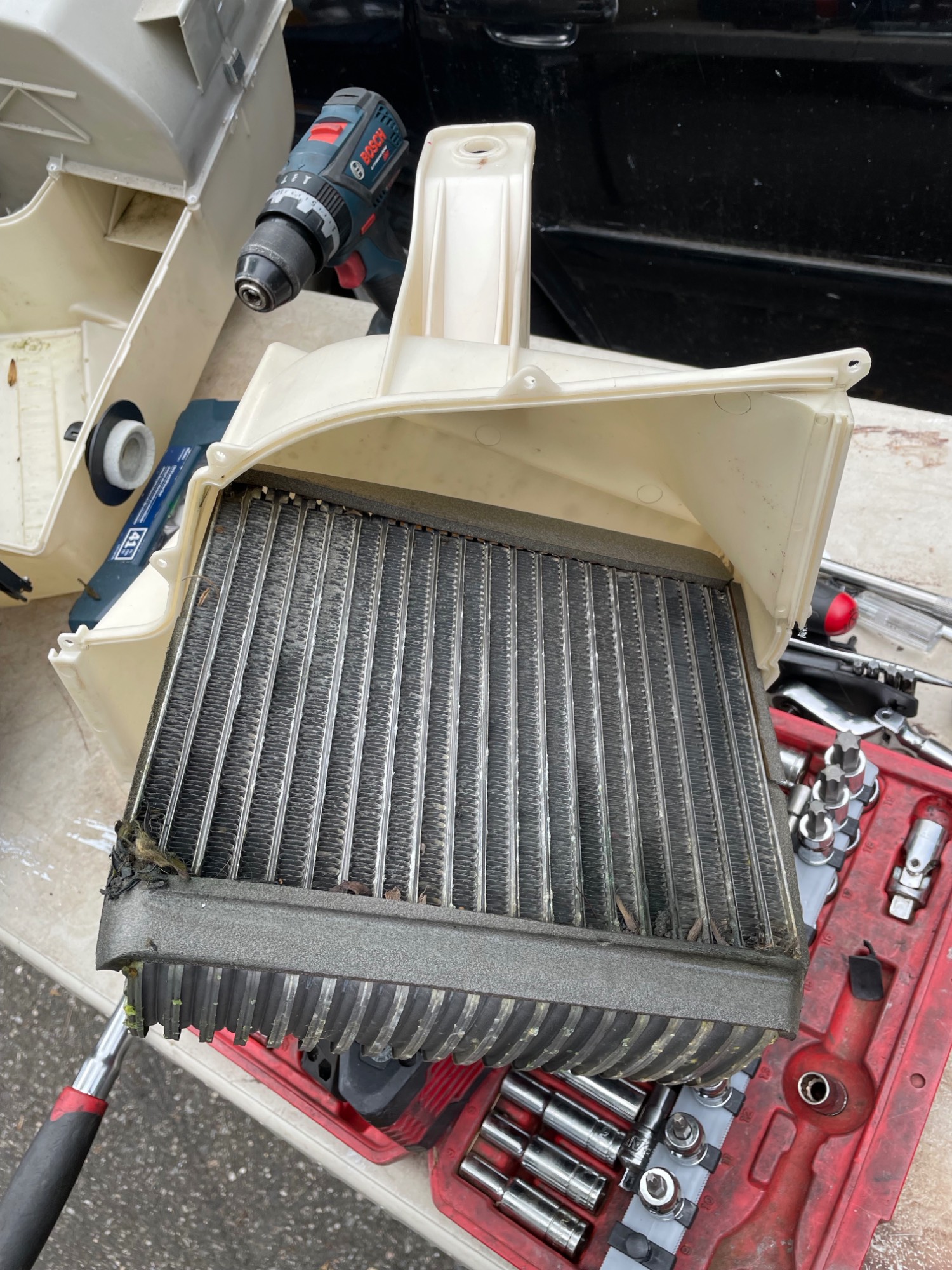

Look for the telltale dark stains of pag oil that foretell a leak in the evaporator …like this
