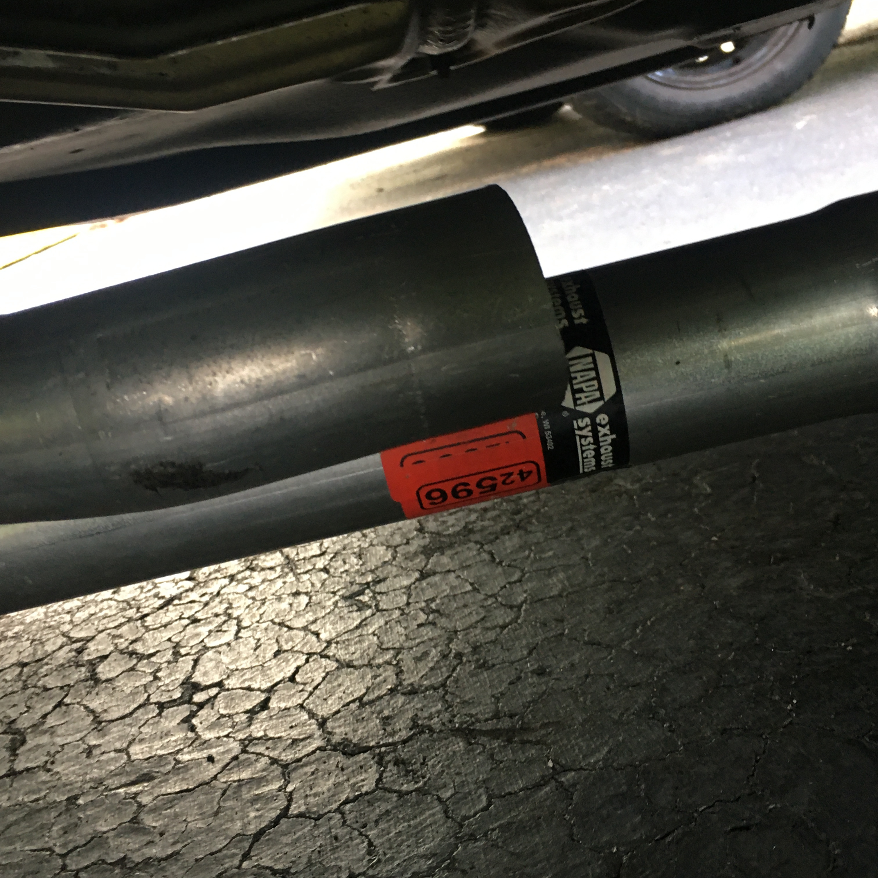

I have a Bosal aftermarket Cat on Shaggkira, and a new Starla rear muffler
The 'ball joint' connection from the Bosal was a bit short of the Starla - my jury rig lasted two months.
The Starla Pipe is a 60 mm metric pipe, or 2 3/8 OD - an odd size you cant get at NAPA or FLAPS , Ive found out.
Im trying to fab with 2 1/2 inch and fibergalss packing and muffler cement.
Part numbers to come.
Ive found the connector on ebay in the UK

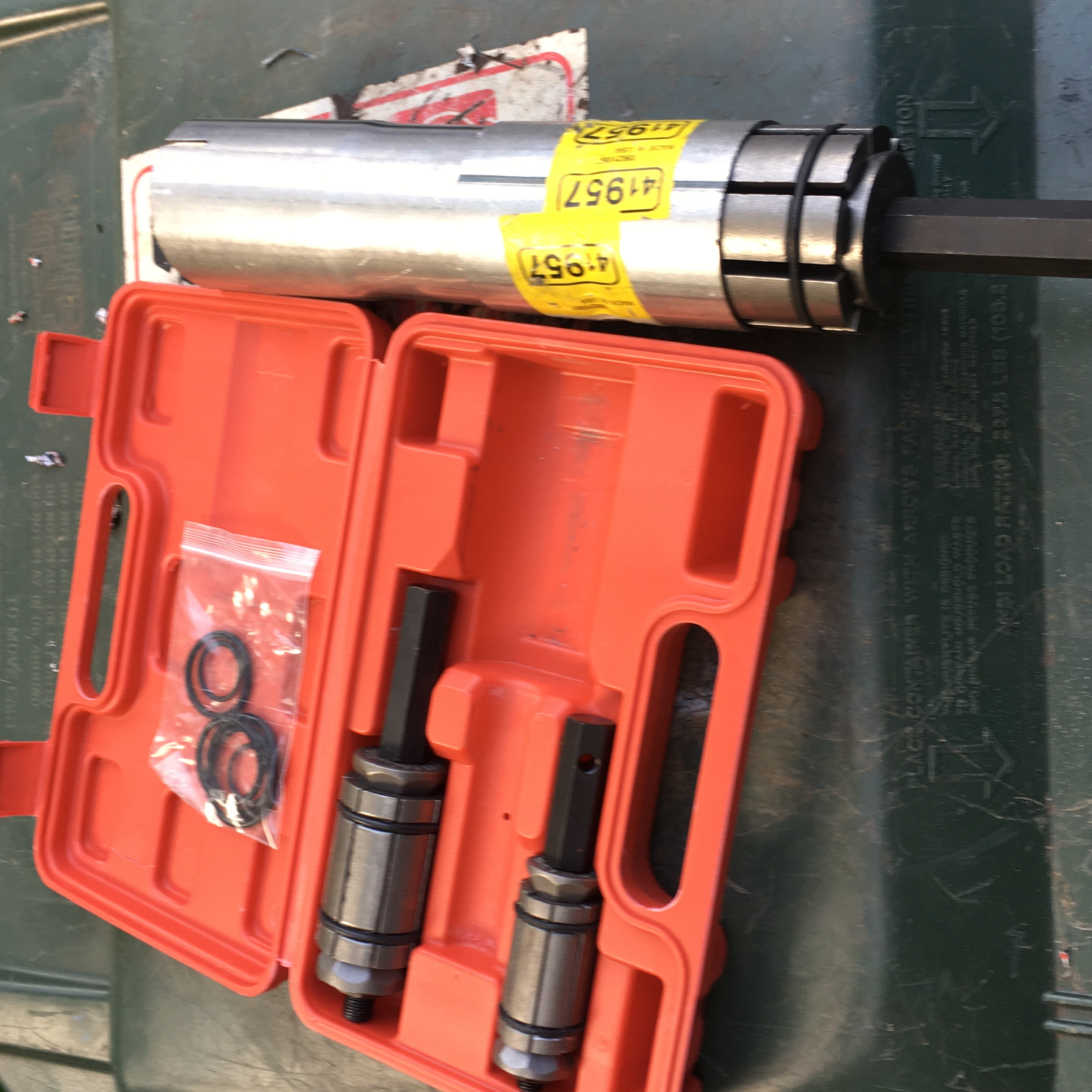

I was surprised by the 2 3/8 mongrel size of my tailpipe (turbo). The 2.5" flange is too loose, 2.25 too small. I had the 2.5" flanged pipe extension from AZ, so I stopped into local Midas, had them grow the other end to exactly slip over the stock part of the tailpipe that I cut off to replace the bumper bracket. The tech took half a minute to do it and was not going to charge me. I slipped him a tenner. Then, used my chain-wheel pipe cutter to cut off the 2.5 inch flange which stuck out too far anyway. Problem solved.

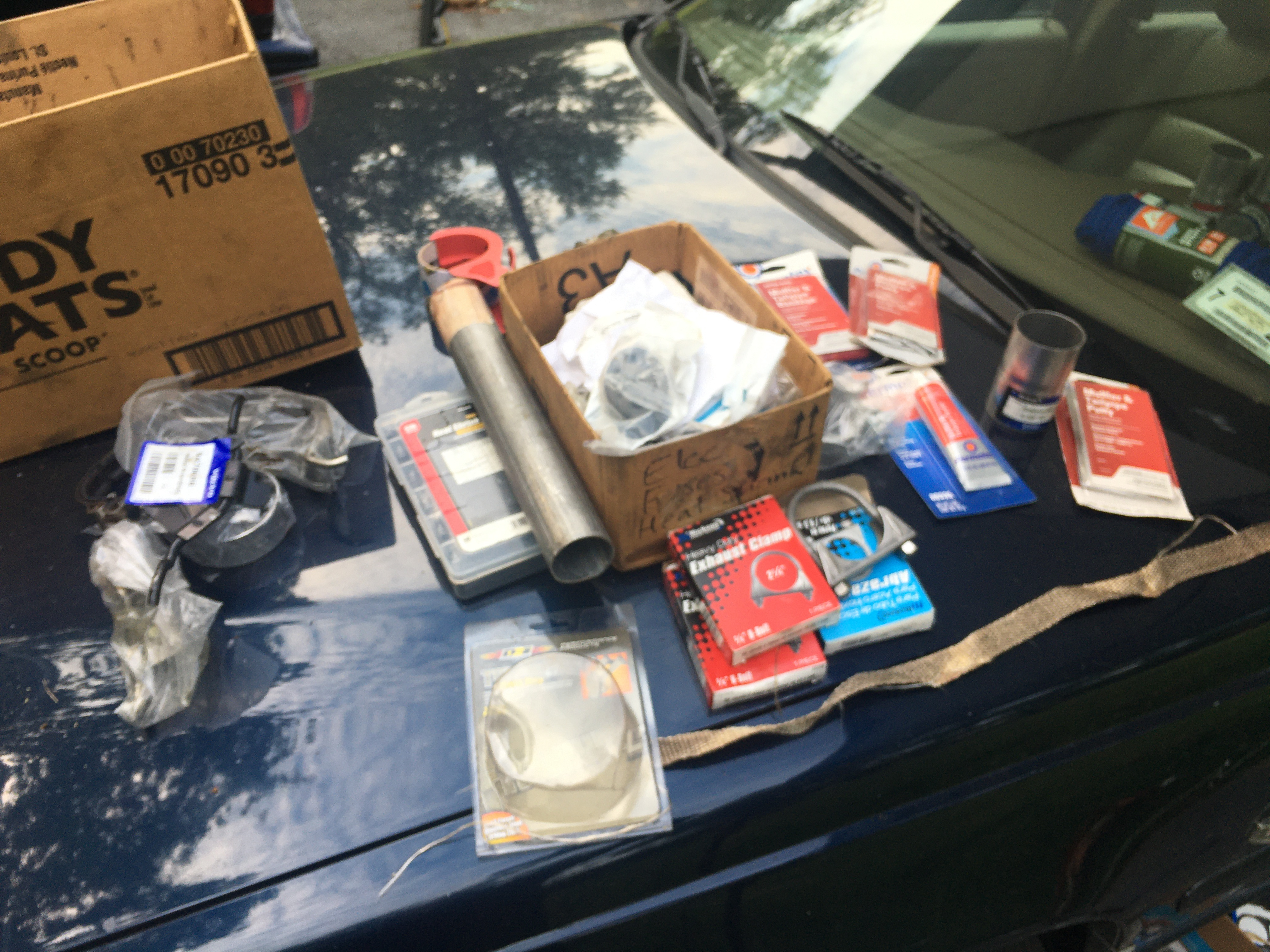

I’ve got the mandrel expander, fiberglass exhaust pack, permeatex cement, and clamps and connectors.
Will knock it off tomorrow with a 2 1/2 inch extension piece

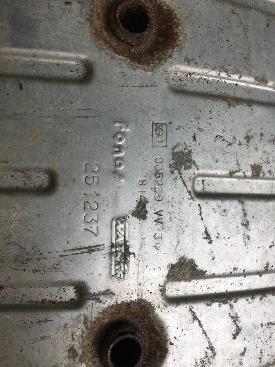

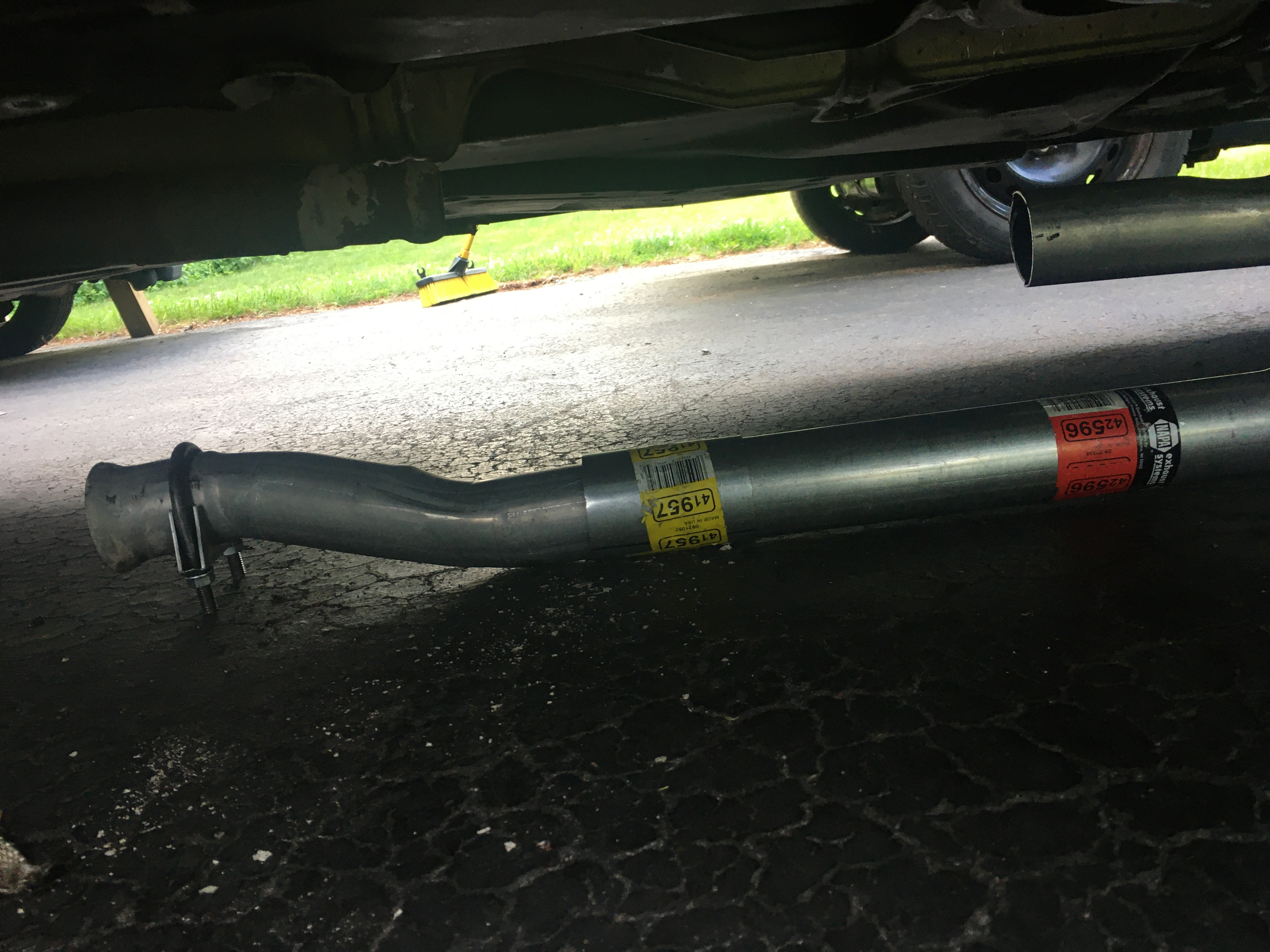

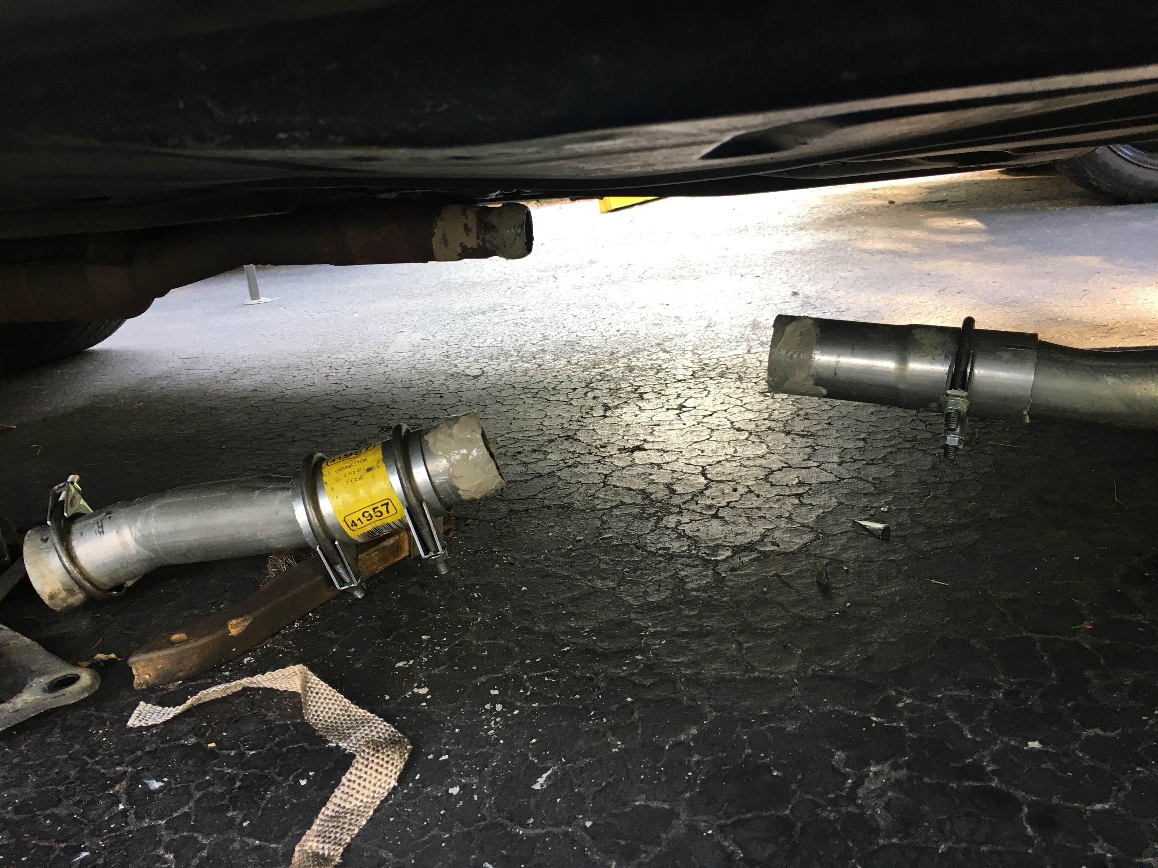

This was self inflicted. I bought the Starla muffler for the OE cat, and the Bosal cat has a skinnier pipe.
The walker muffler 251237 would have fit with just the single donut clamp
I had to kludge up to 2 1/2 inch extension, then back to 2 3/8 ( 60mm) to attach

If that section is too large just cut a cross, so four slot, and that can help close the area tighter. Use a little material to wrap or seal any small opening that has exhaust seepage.
