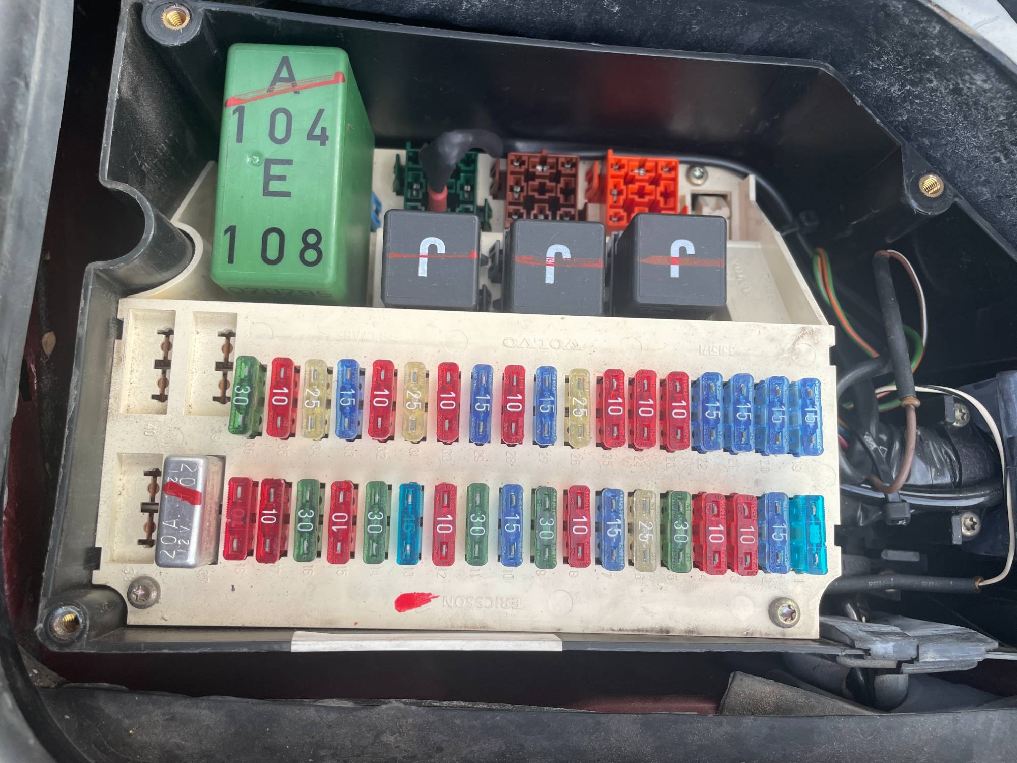

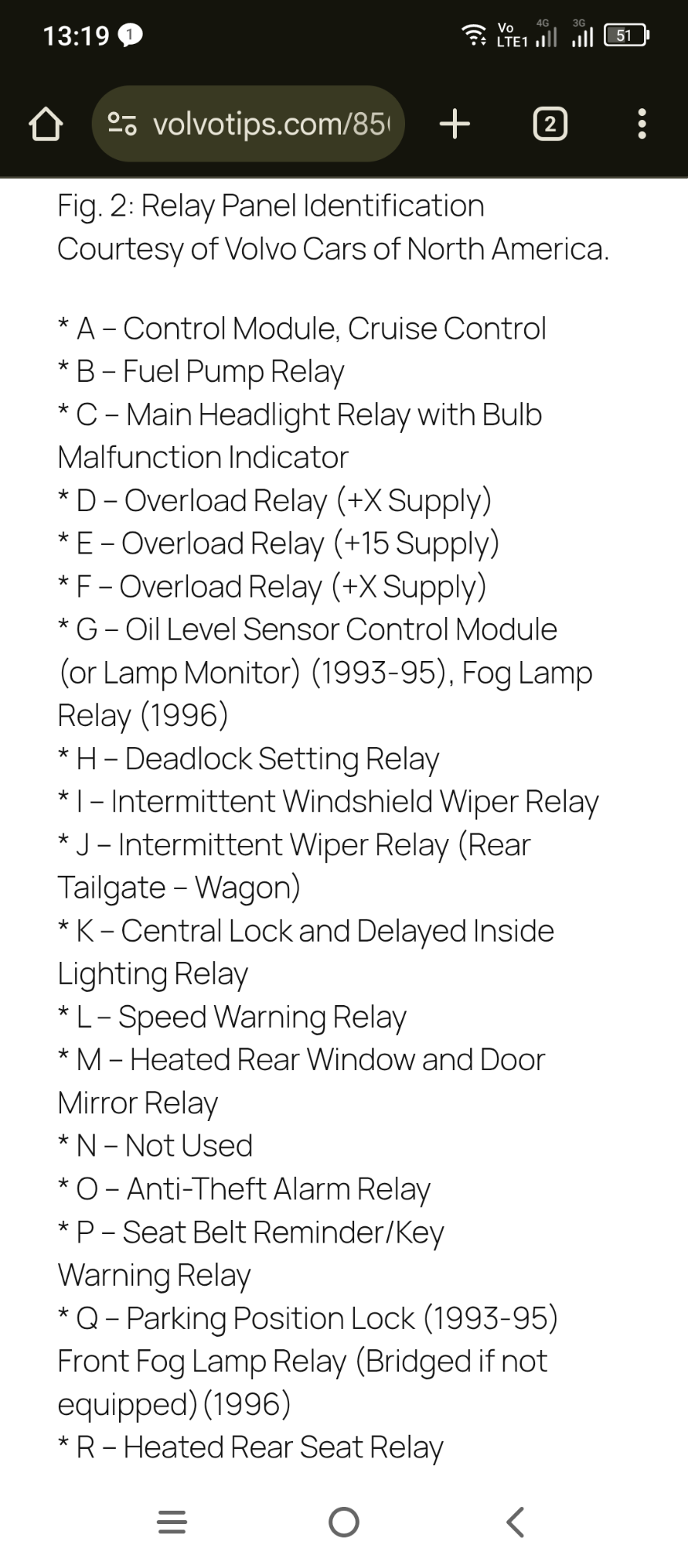

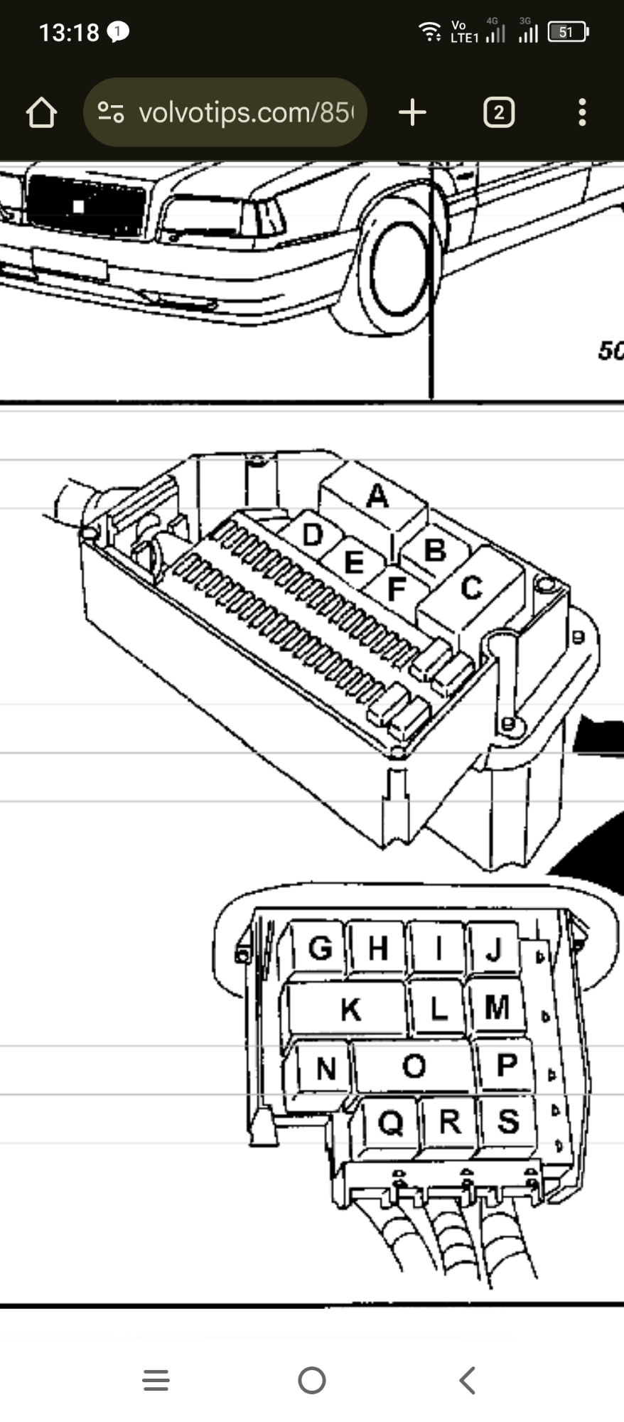

Got a post-purchase inspection on my newly-acquired '96 854 Sedan, one, among several glaring issues, was some issue regarding either the fuel pump or its relay, upon inspection, it looks as though these relays are missing altogether. There are a couple wires plugged into the number 103 slot. Not sure if I have something wrong or this is simply a lower spec or something.
Any and all help is greatly appreciated and I don't suspect this'll be the last time I'm on this forum.
