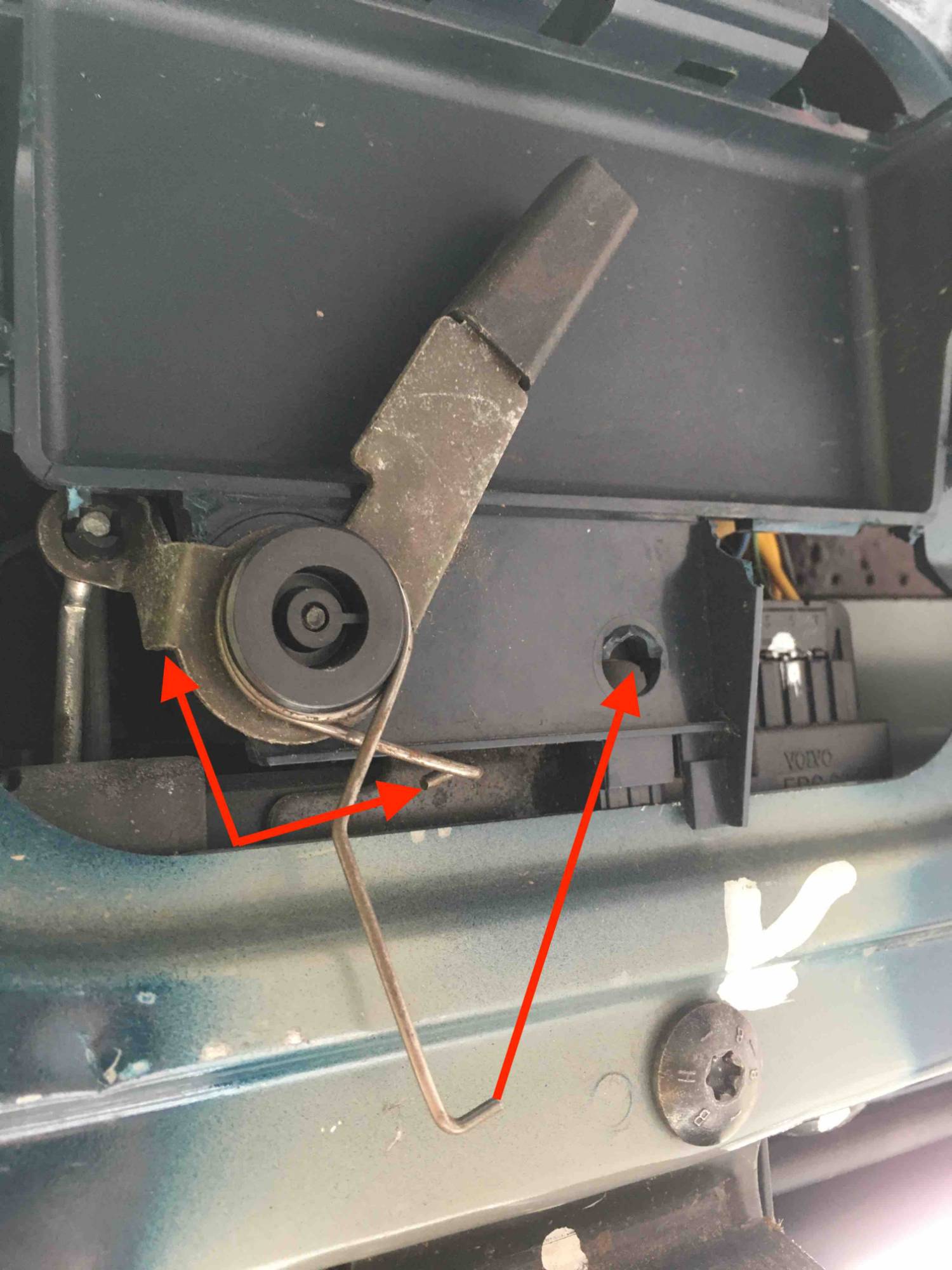

Hy Buddies,
I have a issue with this part. Recently i've closed the door as always and the next time, this spring appeared.
May someone could confirm my idea is right ? Doesn't here a missing part (black part broken on the picture ?
Thanks.
Manov

I’ll take a picture of mine , I think you are right on a broken plastic part

Salut Abscate,
I've found this. I think the part which is broken is the Number 6817995, N° 13 on the board. I will contact my Volvo dealer to see if it still available.
Manov
