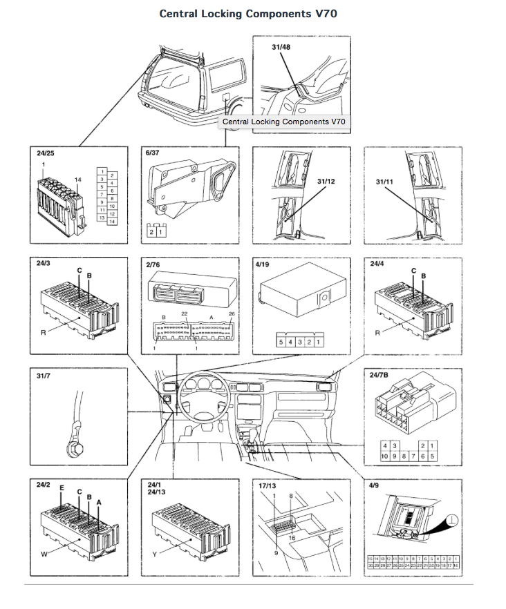

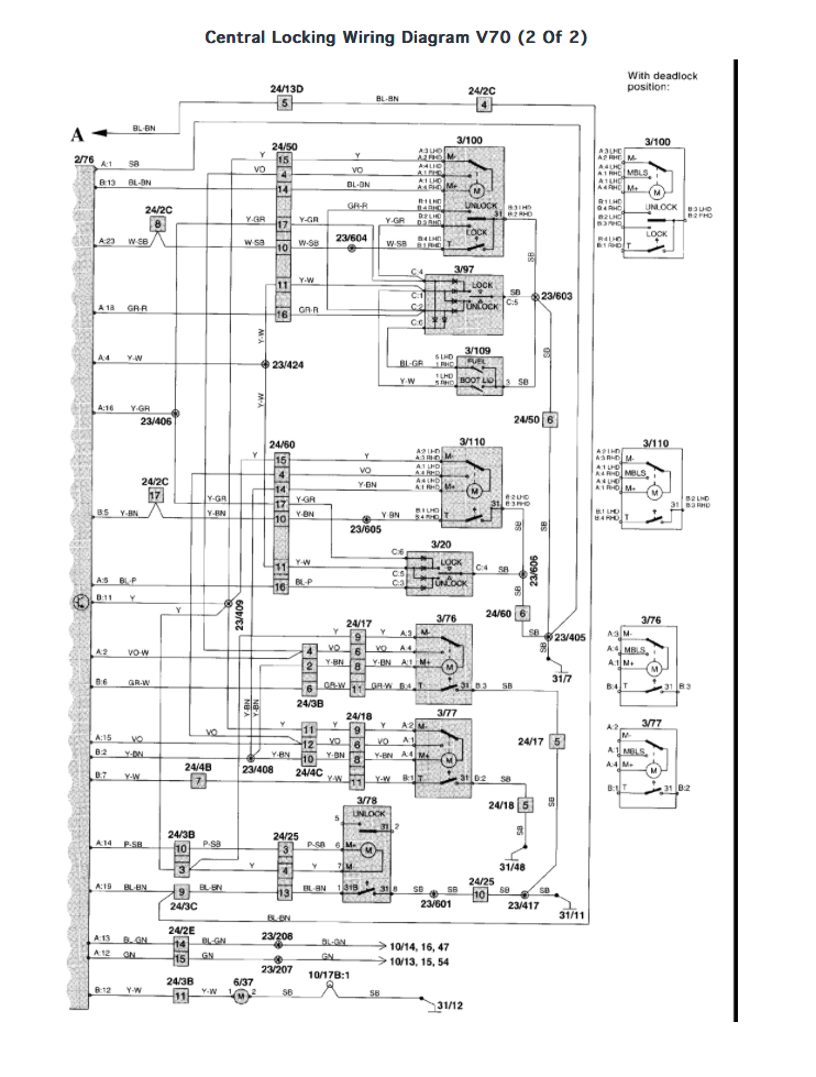

Trunk lid light gets 12VDC from Pin A:16 on the CDM, ground wire is pin B:14 on the CDM, a BL-BN wire runs from the CDM to connector 24/13D then to connector 24/2C then to pin 9 on connector 24/3C (also connects on A-19 on the ECU) , then to pin 13on connector 24/25.
That runs to BL BN to pin 1 on the trunk lock motor component 3/78. and is grounded to pin 8, SB wire to 23/601 to pin 10 24/25, then SB to 23/417 common and finally grounded at 31/11 - location of that ground is in tailgate C pillar.
The 24/25 connector is high in the C pillar near the trouble spot of the wiring loom
Should be able to diagnose the continuity of the ground wire from the 24/25 and see if that or the switch is the problem,

Update - I found broken pieces in the brass part of the tailgate lock and will need a new one.
