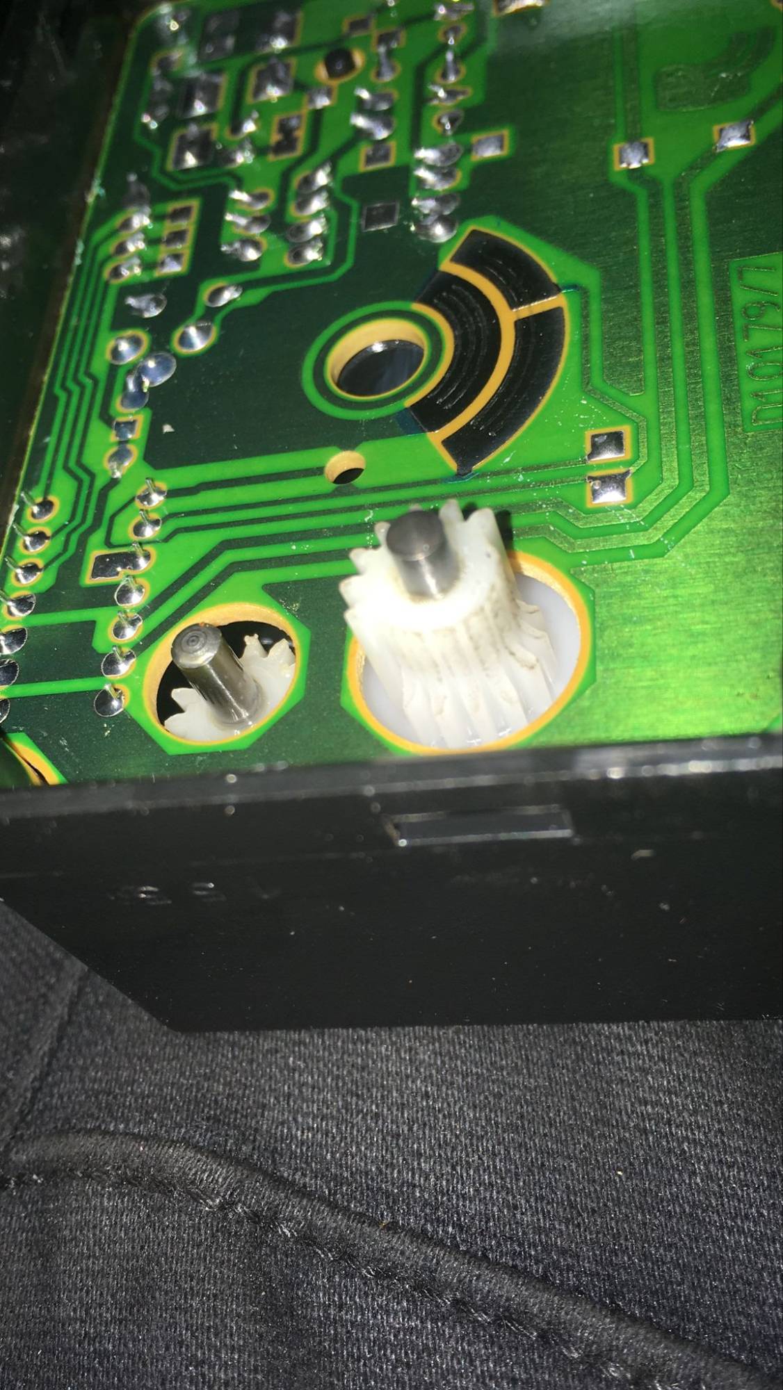

The motor of the plate ACC is good to be replaced.

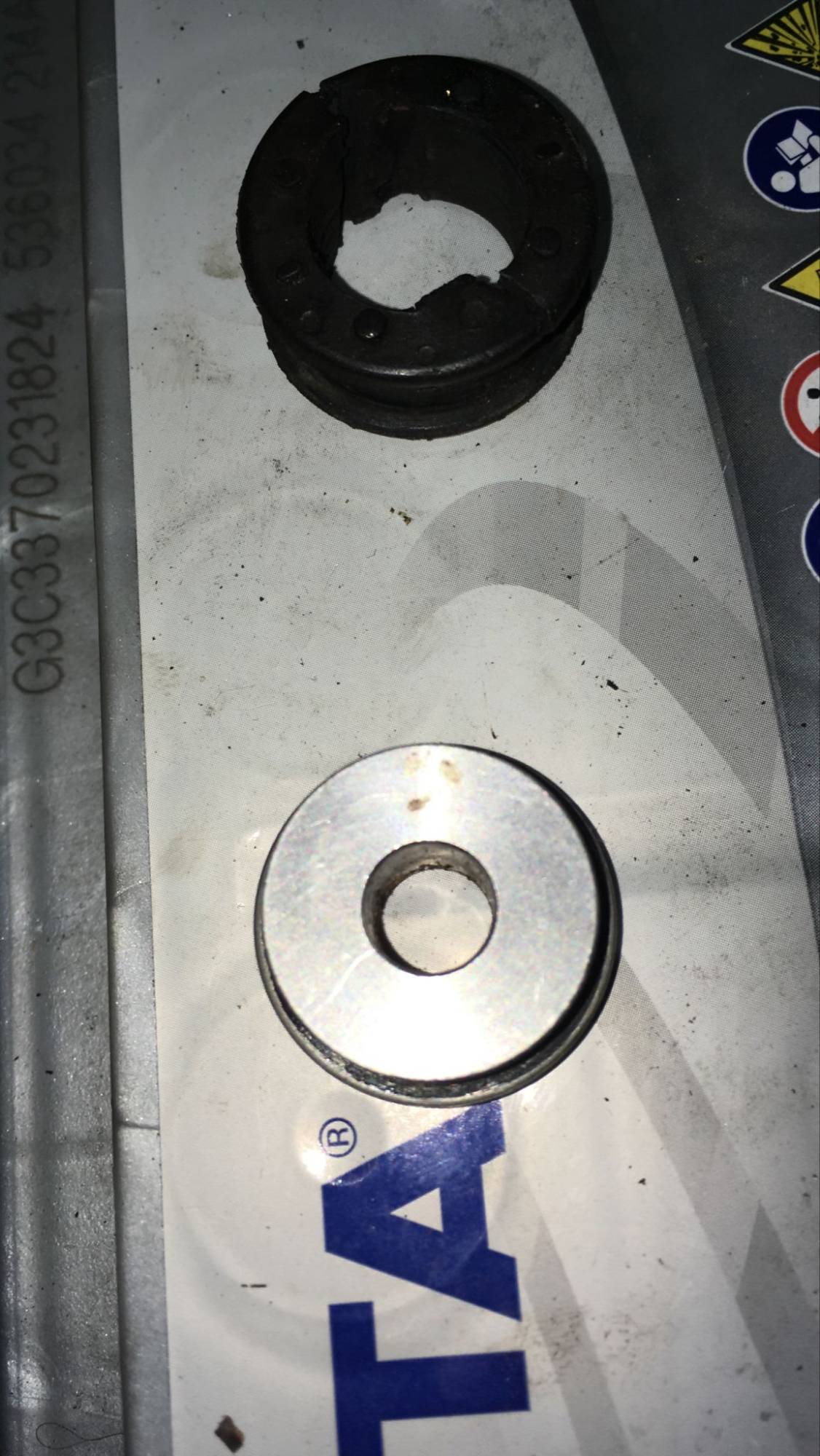

I've replaced gearbox rings

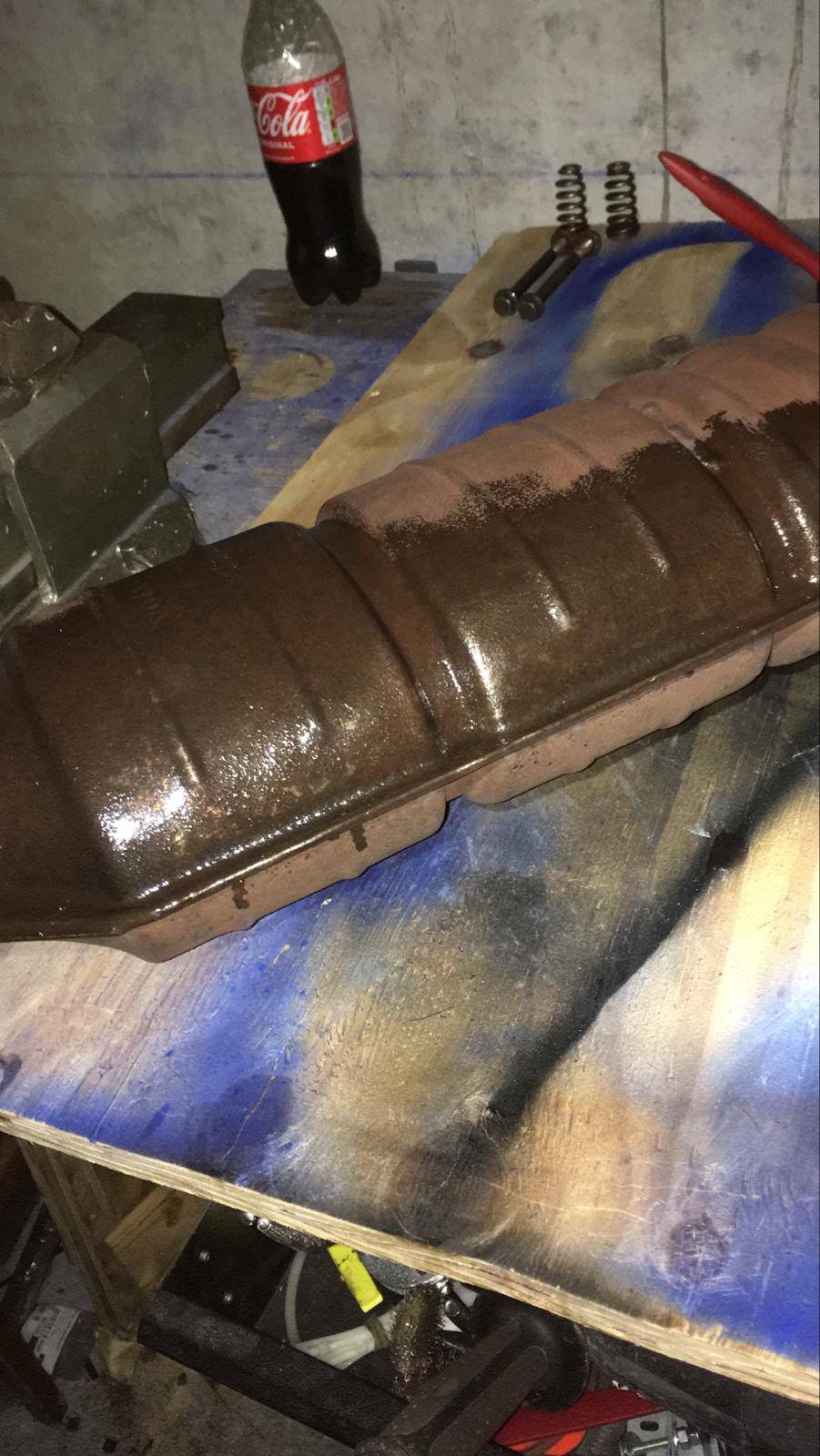

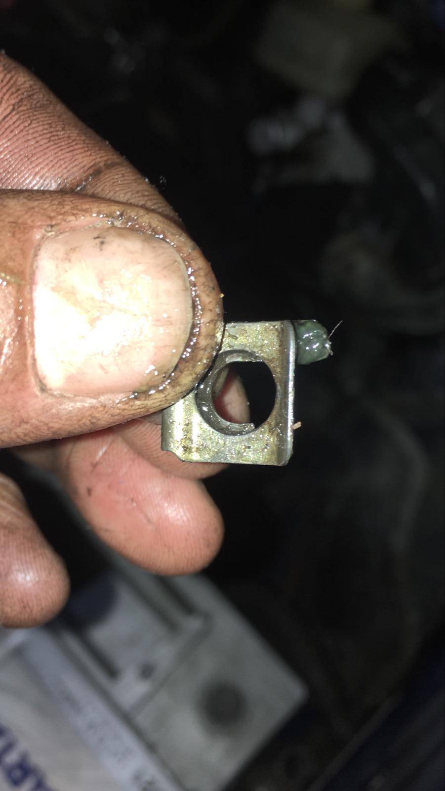

I've cleaned one of my exhaust parts.
I've broken his plastic small thing when i've replaced the hose to feed the fuel tank.

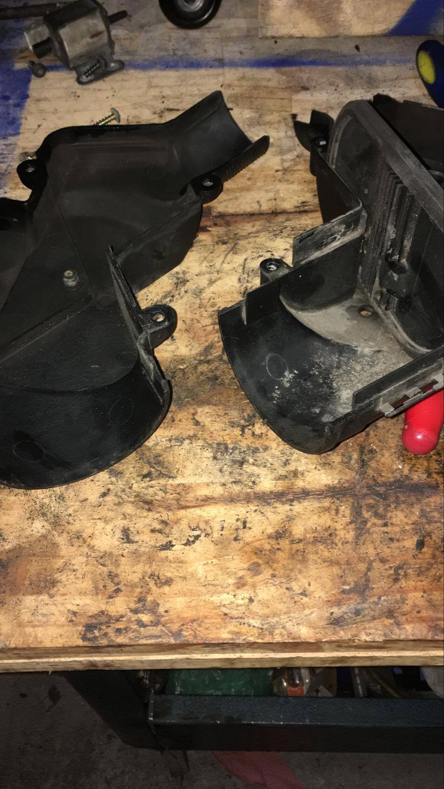

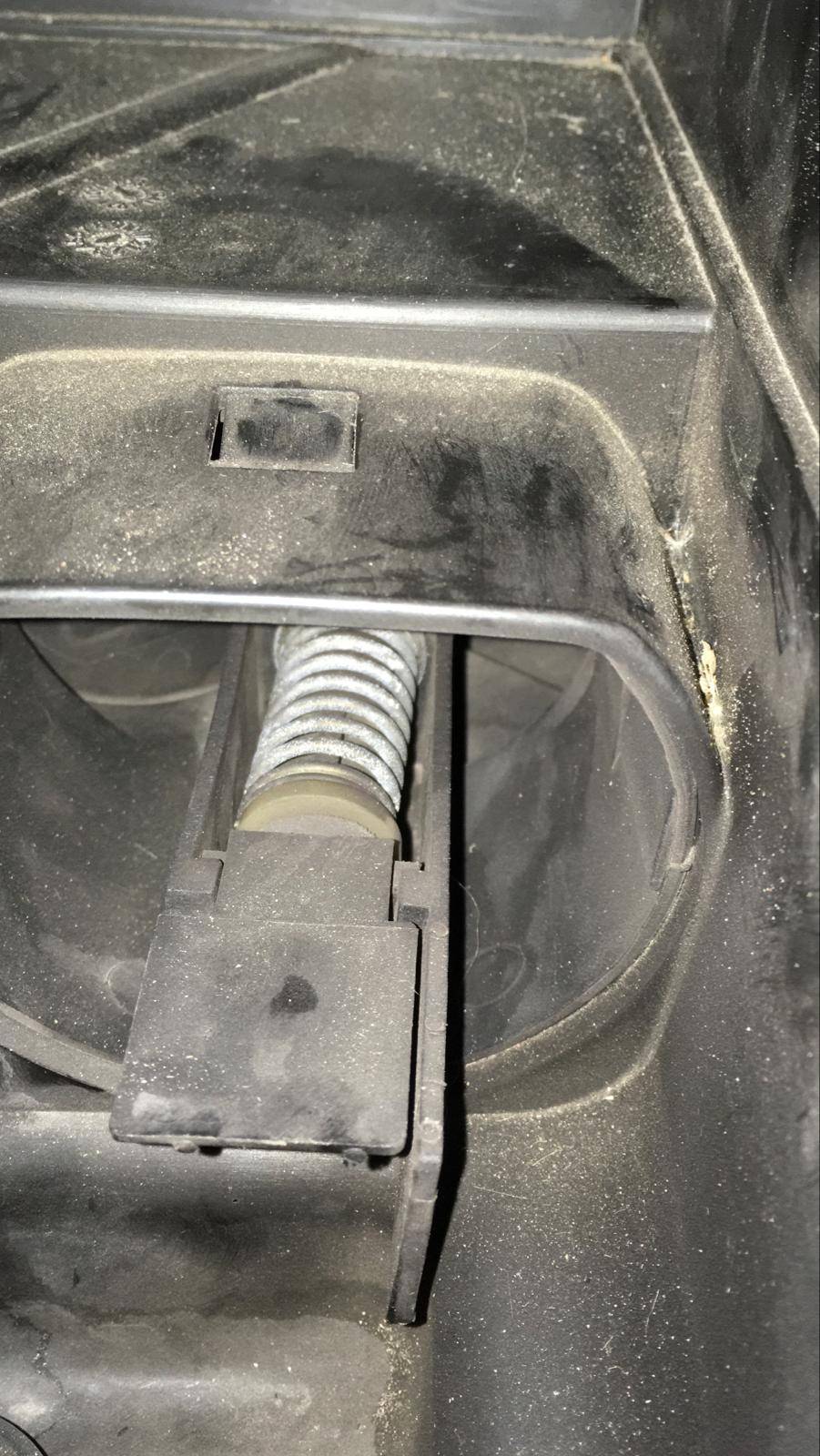

I cleaned the air filter box.
Then i replaced the exhaust seal, cleaned springs, replace bolts by Volvo ones. I used cable ties to keep compressed the springs, add a washer.

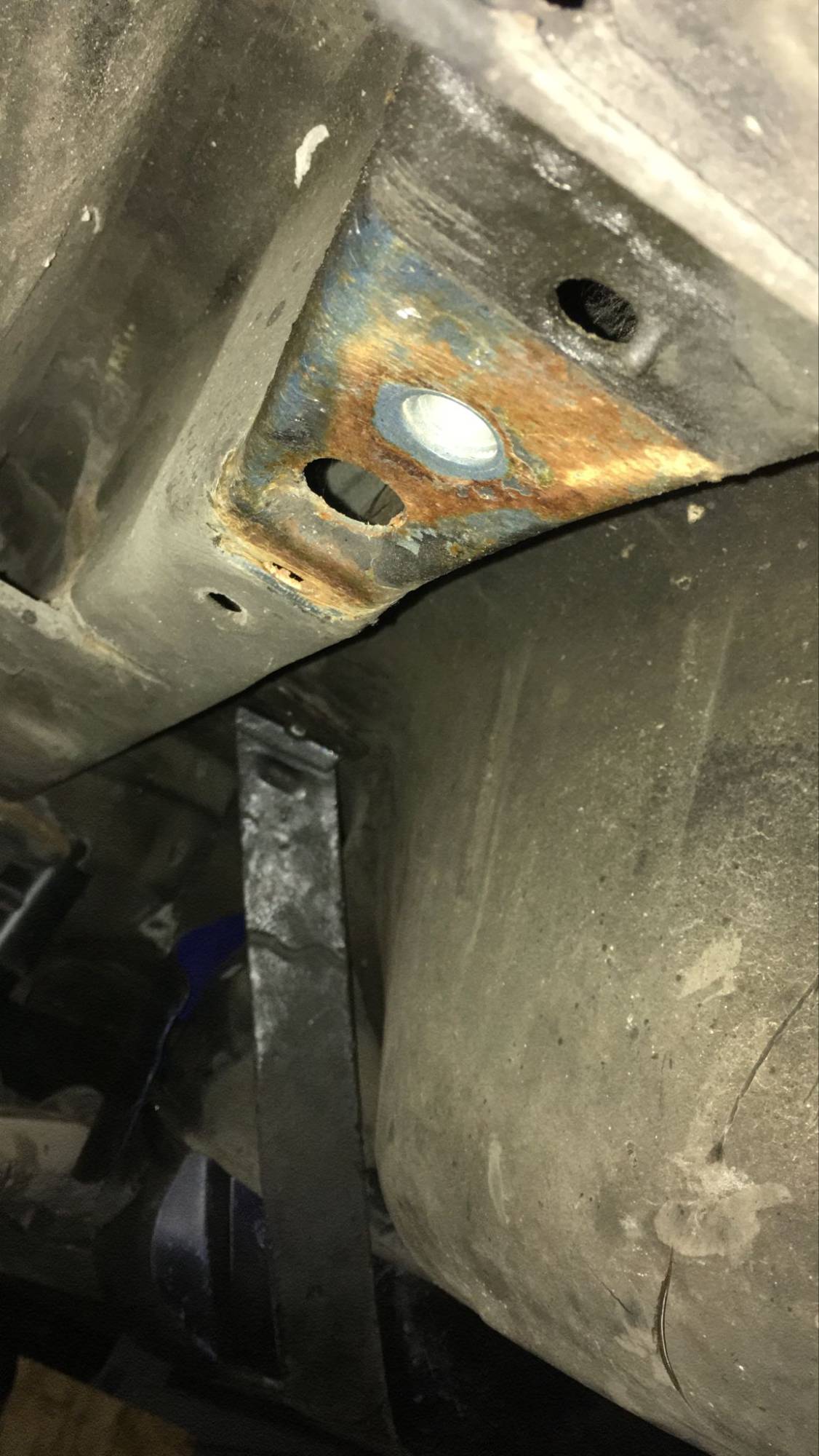

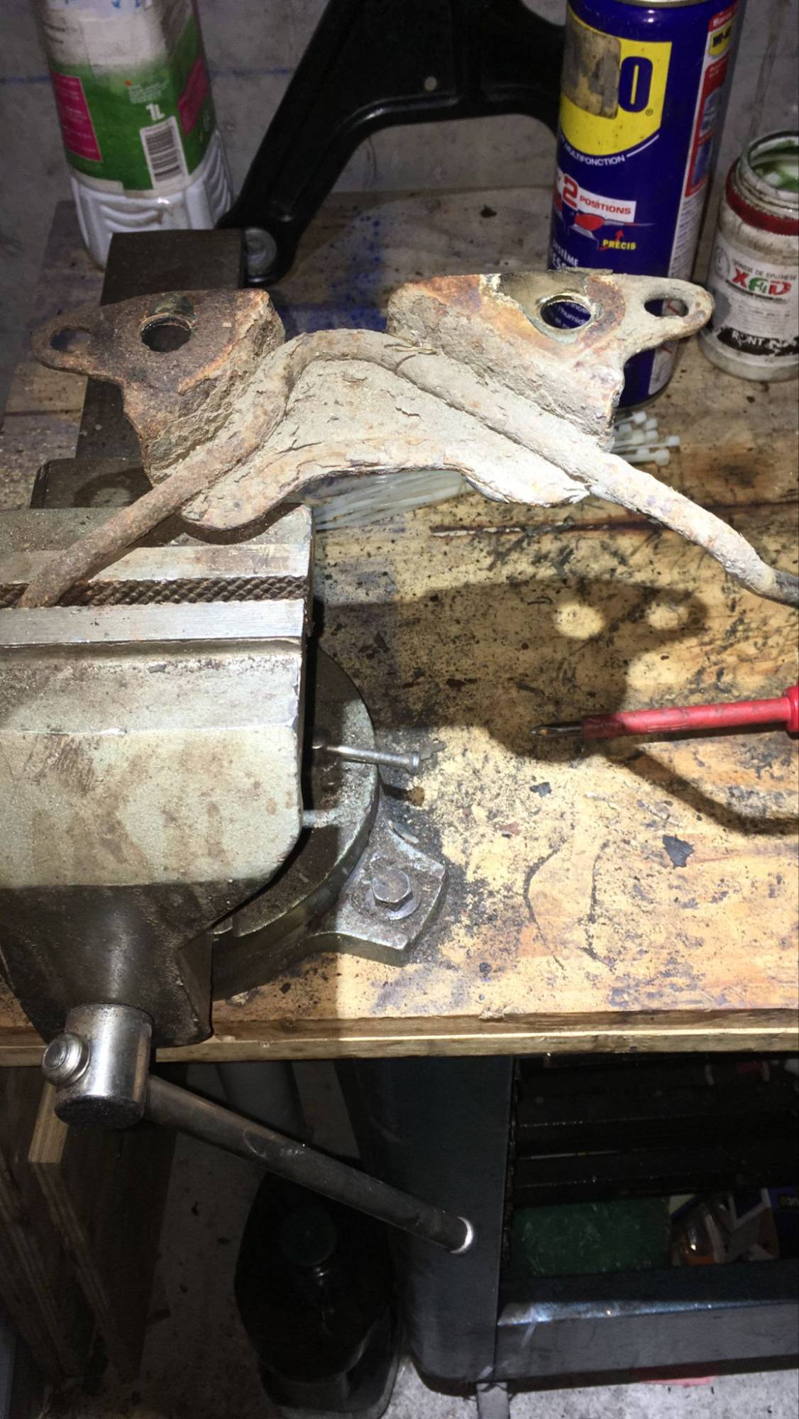

I finished my work time by having a look to the exhaust bracket. Cleaned everything, where the car frame receive the bracket, and putted on some rust killer. Tomorrow, when everything will be dry, a bit of black paint, and to reassemble the all stuff.
