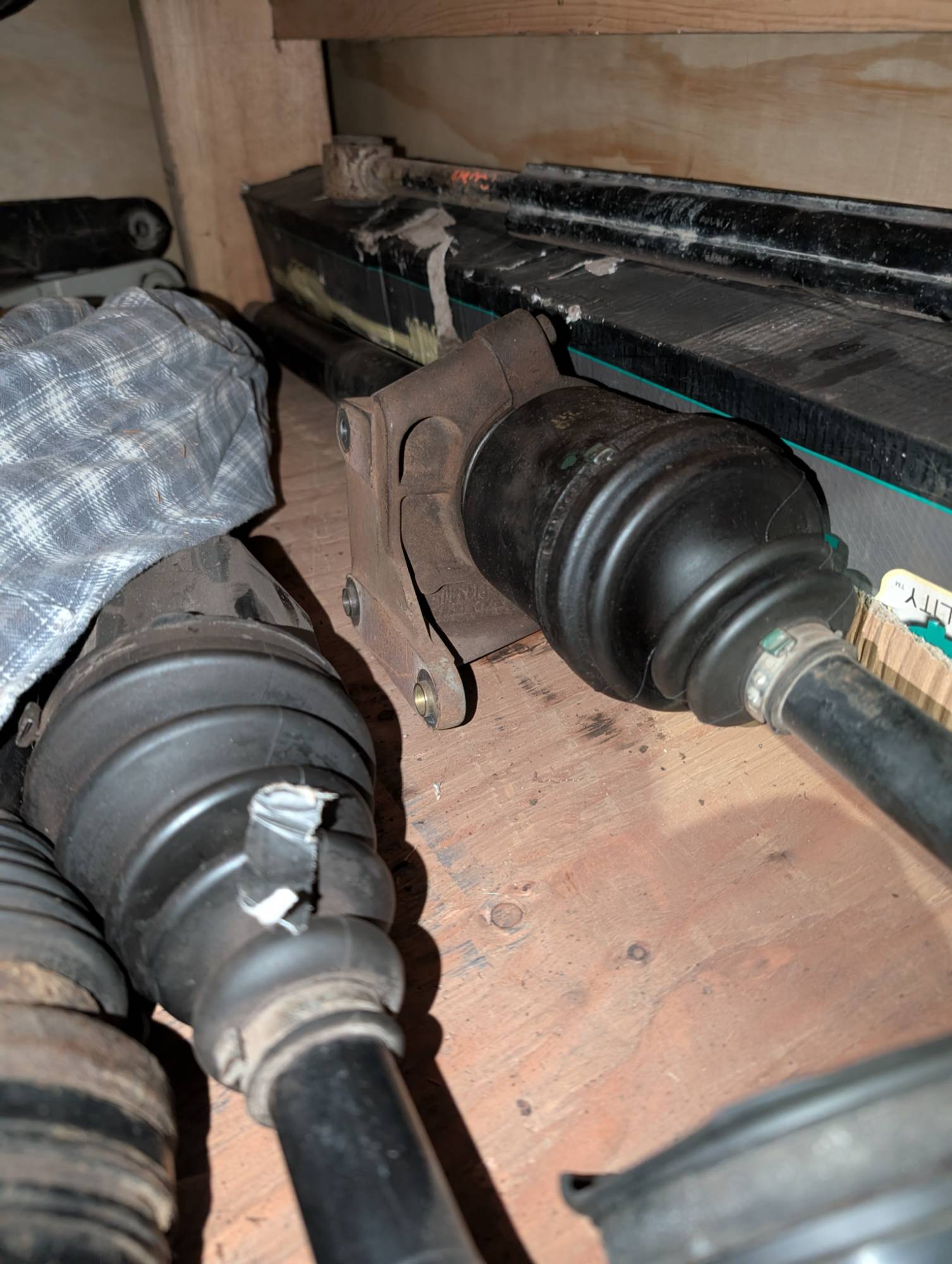

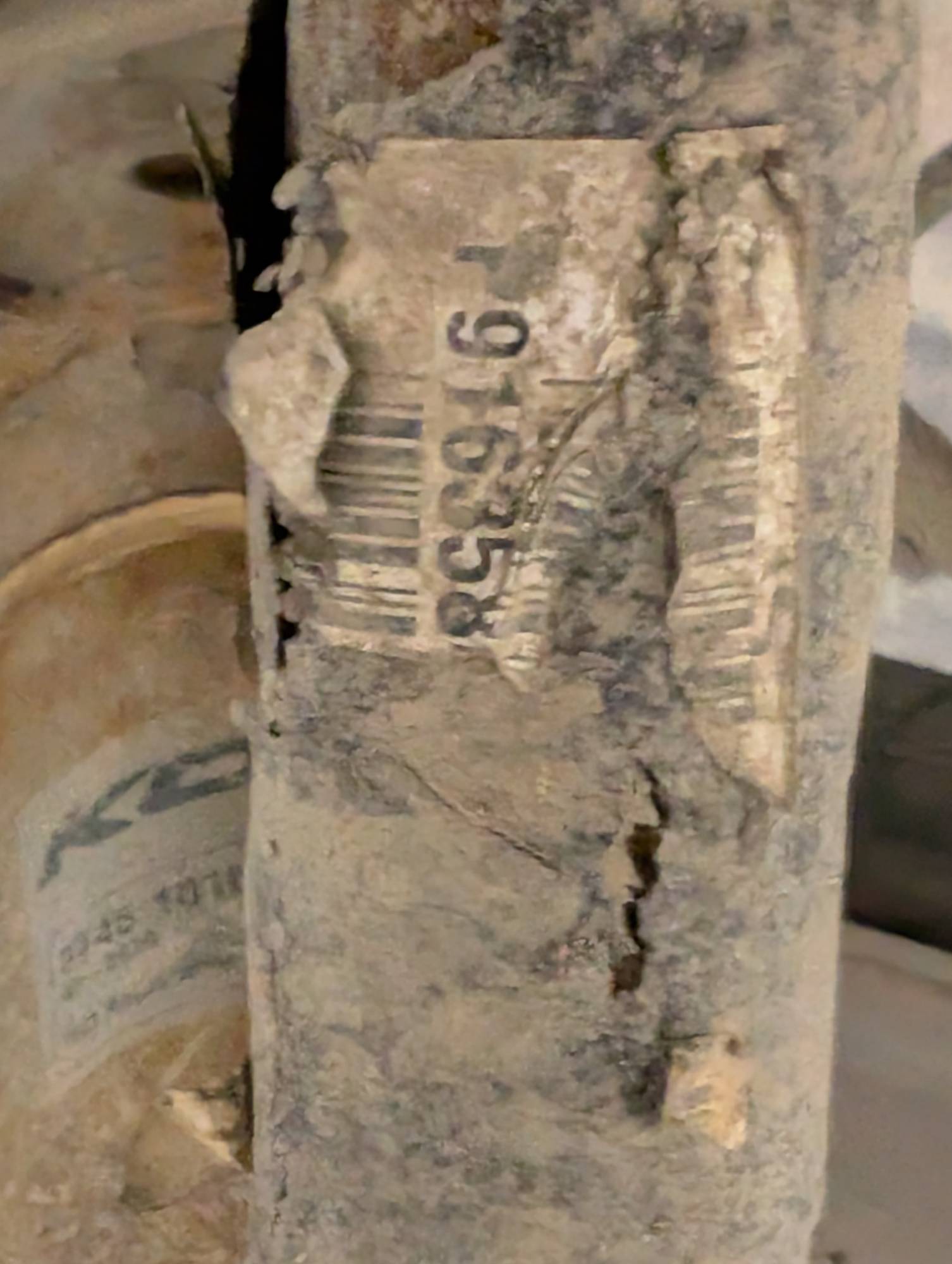

What I can't find is the correct part number to help sourcing the correct CV boots. One has a partial label but looks like it is missing the last digit. However, I cannot find any reference to the part number:
P916358
I believe there should be another digit, but I can't find any reference to the 916 numbers??

Thanks Eric! Wealth of info as usual. I did have a look at this. I have read it before, and had also discovered the same info but using a VW inner boot, I think it is the same GKN Lobro part number.
The issue I have here is that the part number does not appear on any databases I have looked at. The majority seem to start with an '8' with a 67 digit number. This one has a '9' as the first digit.
Also, I noticed that the inner boot fits to a round 'cup' where I thought they were all a hex shaped cup. However, I checked in the 'stash under my workbench in the garage, and there were 2 RH long axles. One has a round cup and the other a hex inner cup??
The axles in my cars that I recall have all had Hex inner cups. Not seven sure why I have a 'round' version. The Hex I think is actually from a 5 speed 00 NA Auto. Not sure what the other is from as it has no sticker ID on it.
So I need the 'Round' inner boots for the 98 T5. So, the linked thread does show that 'Audi' inner round axle cup. I'll need to check the stash for which ones I have in 'stock'.

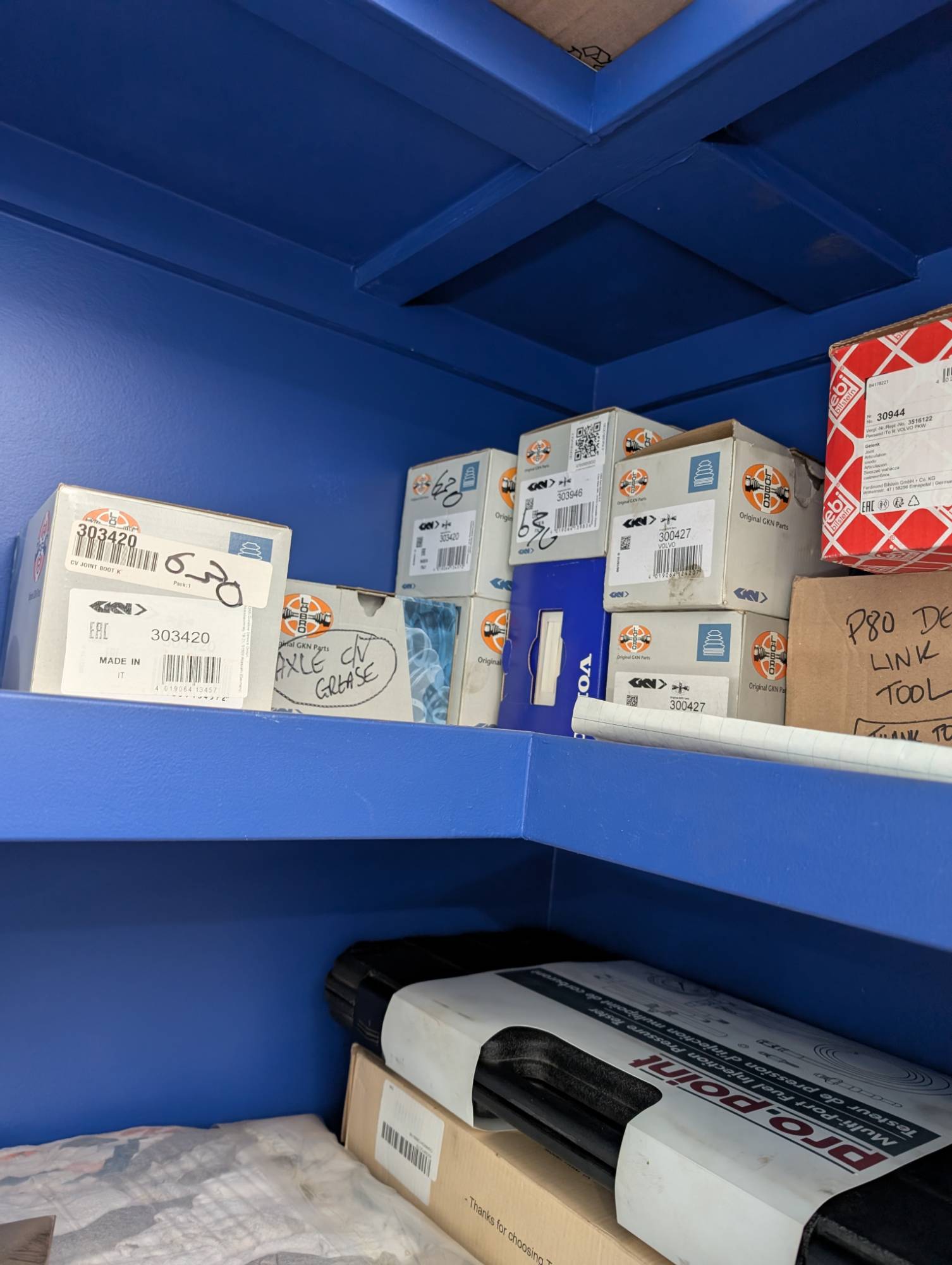

I have a bunch of boots back in the shed at home - not home until Sunday though.
The GKN part numbers dont bear any resembalnce to the Volvo part numbers , IIRC.

Holy crap, Apple Photos search engine is scary - here is what I have back home
- 8F8867FC-DABF-42C7-B9EC-B9EB76A86FDF_1_105_c.jpeg (95.33 KiB) Viewed 187 times
- E1EC3E97-BCF9-44FB-9421-34C07F480167_1_105_c.jpeg (83.04 KiB) Viewed 187 times
- F37BAEA6-EDA5-4E76-970A-7B63A5877C1F_1_105_c.jpeg (103.09 KiB) Viewed 187 times
