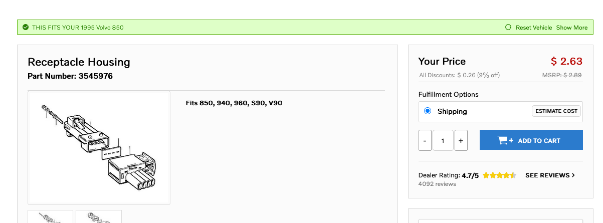

So the secondary locking device is missing from the receptacle? AMP part number in your picture is 4-965101-1, I guess if you look at the other side of the housing it should be Volvo part number 3545976? Just replace the receptacle housing...

I didn't even think about this... Thanks a lot.
