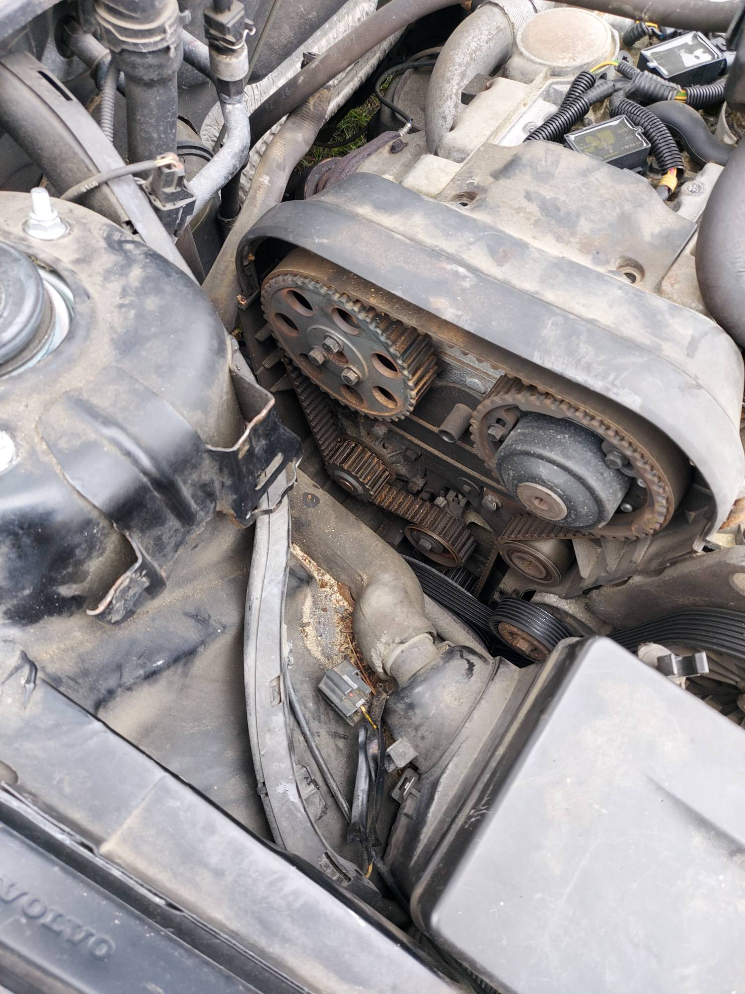

Started the timing belt and water pump job today. Got everything disassembled until it got dark on me. Gotta clean the water pump gasket surface and put it all back together tomorrow. Replacing the serpentine belt and coolant resevoir while I'm at it. I learned that the serpentine belt tensioner is on it's way out. Yet another new part to add to the list. The timing belt looks surprisingly decent for being from 2009... Also the water pump appears to be original, it has 182k miles on it and hasn't leaked a drop, still feels tight too. Impressive

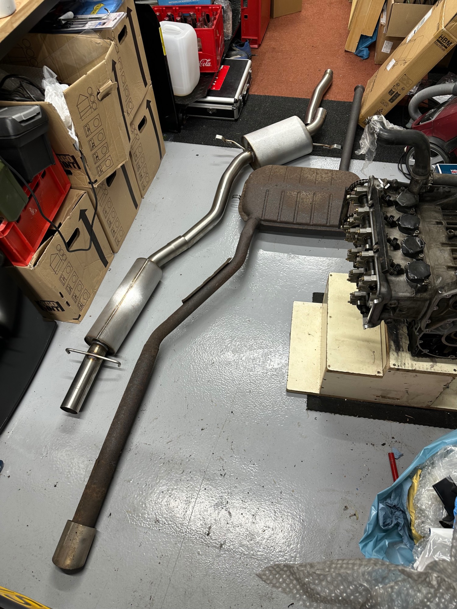

Found some atp sealant that was a little bit cheaper than the other one that I found online. I’ll using it with the next oil change.

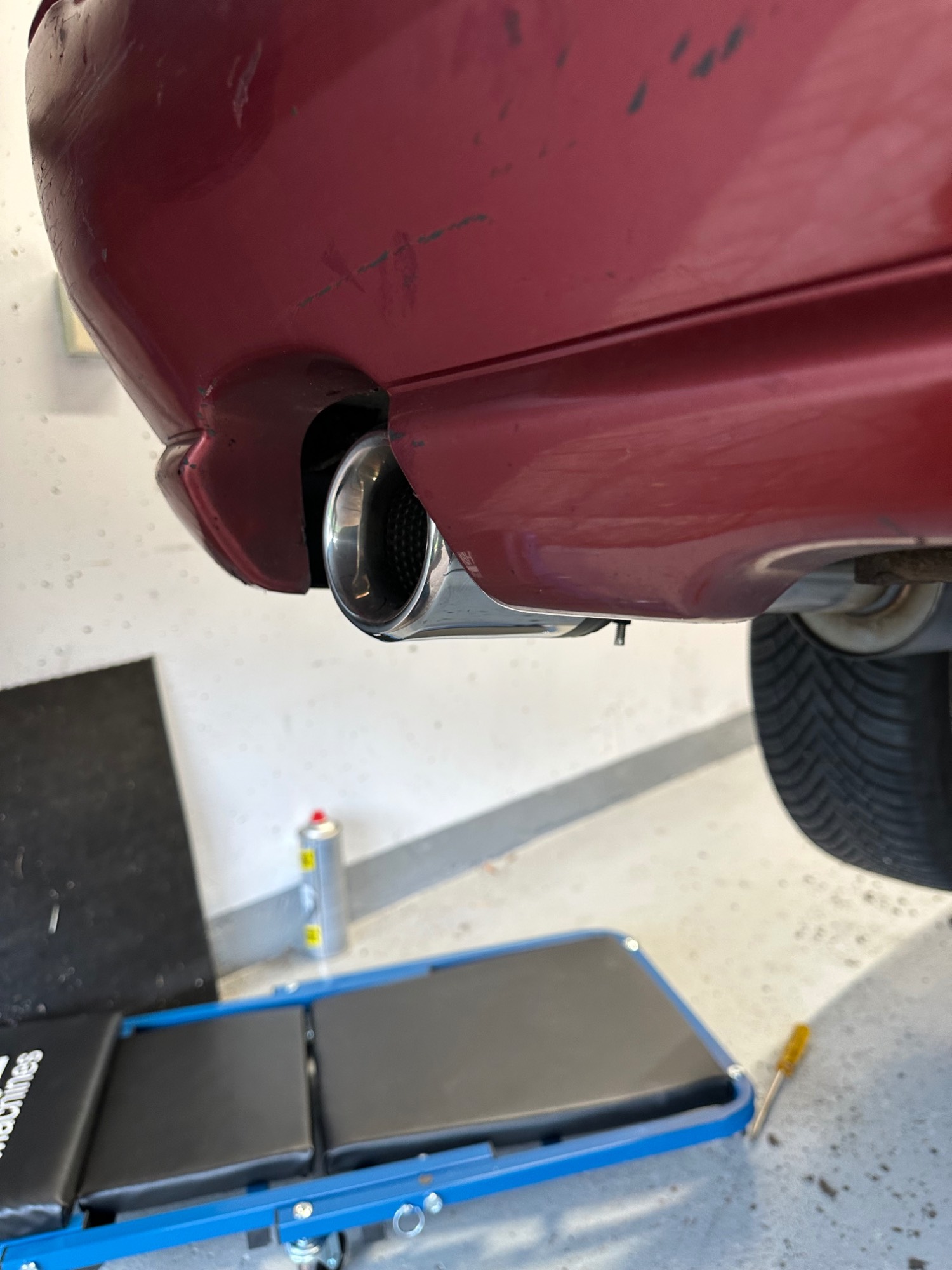

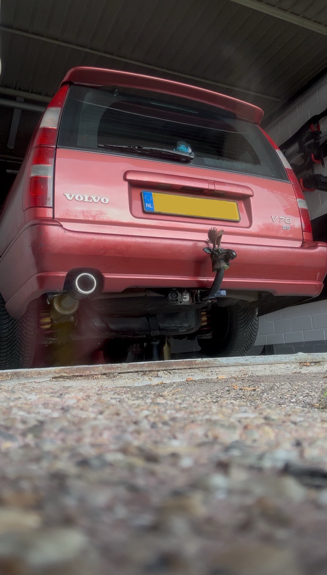

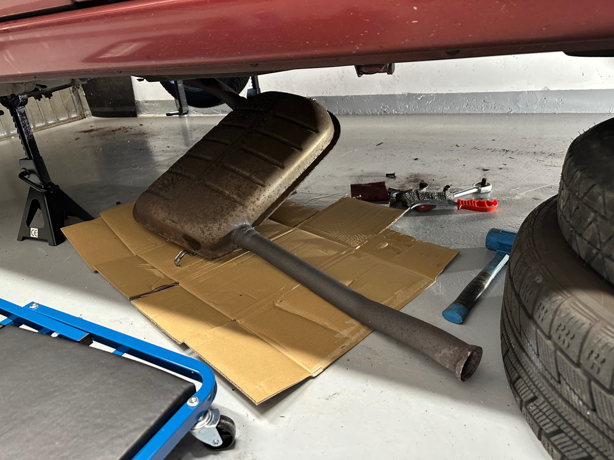

Next up I replaced the exhaust for a ferrita cat back sports exhaust. I installed it from front to back and had issues getting the ball joint to seal. Took me three tries to not get it leak.
But it’s droning a lot around 2k rpm. So much it hurts my ears.
I’ll have to reseat the rear muffler and tailpipe and make it stick a bit more outwards of the bumper.
If that doesn’t work, then maybe reseat the whole cat back and install it from back to front if that makes a difference.
Also, the cat back came with a round tailpipe. I want to order an oval tailpipe. It suits the cutout of the bumper much more that the round one.
Funny to say it, but the old exhaust sounds much better. I could hear the 5 cilinders much better than the sports exhaust.

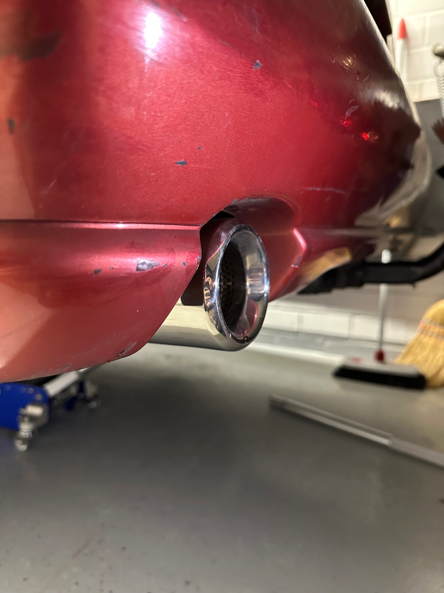

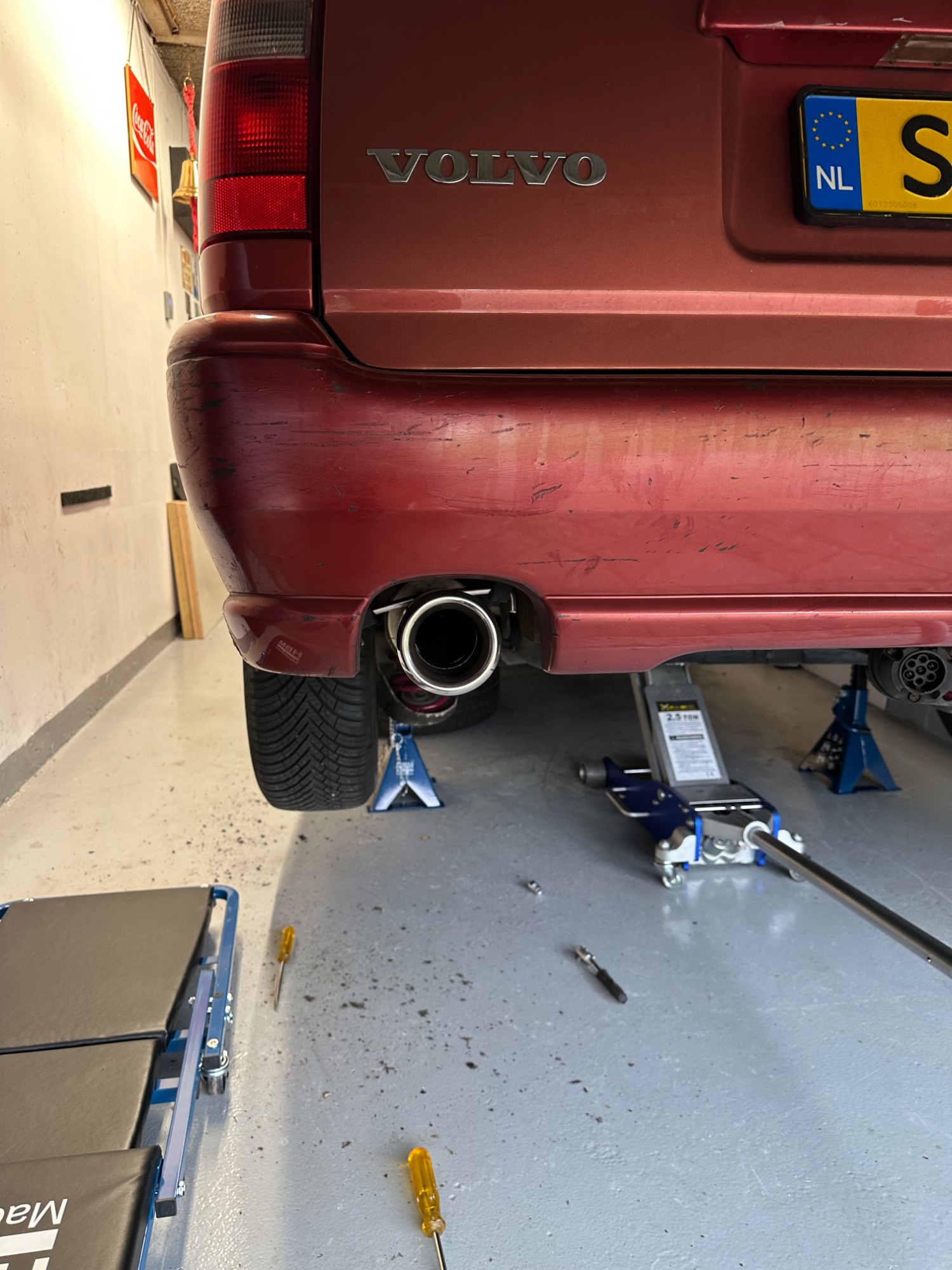

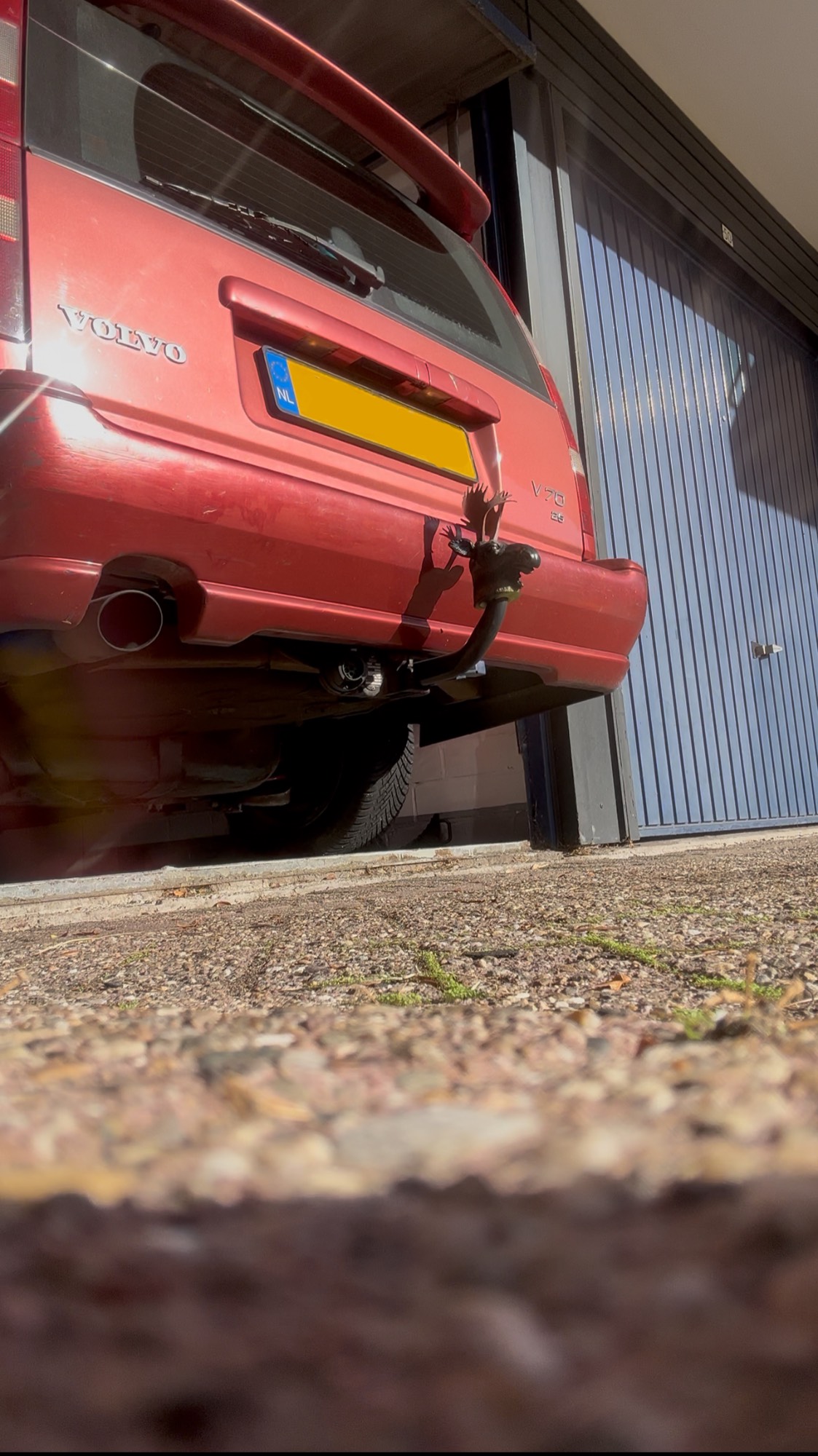

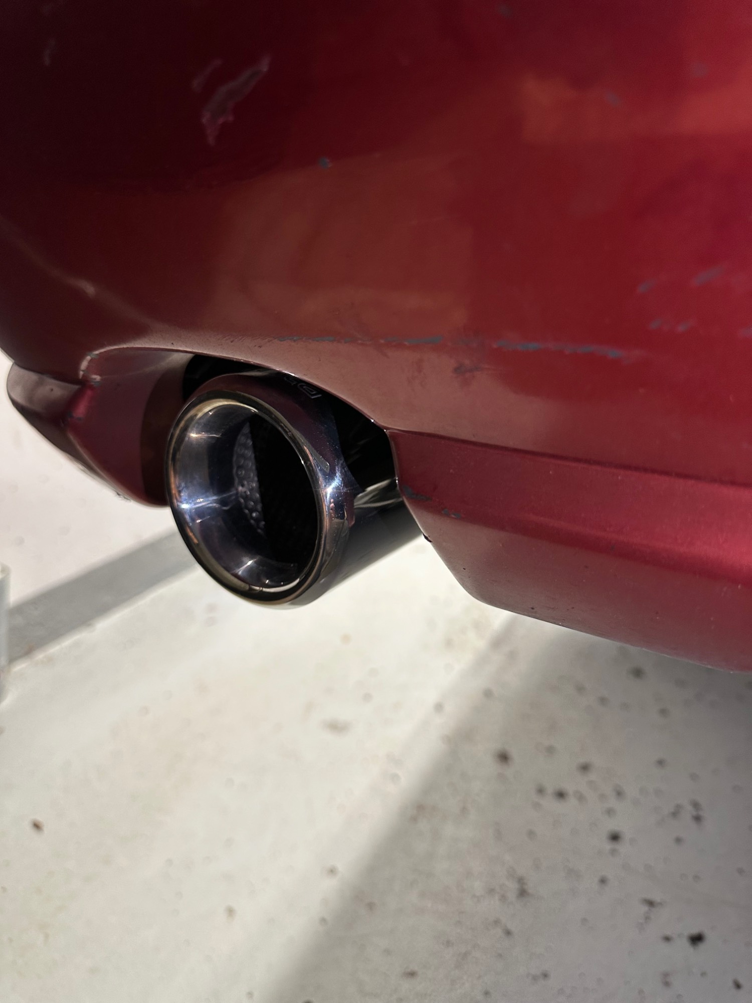

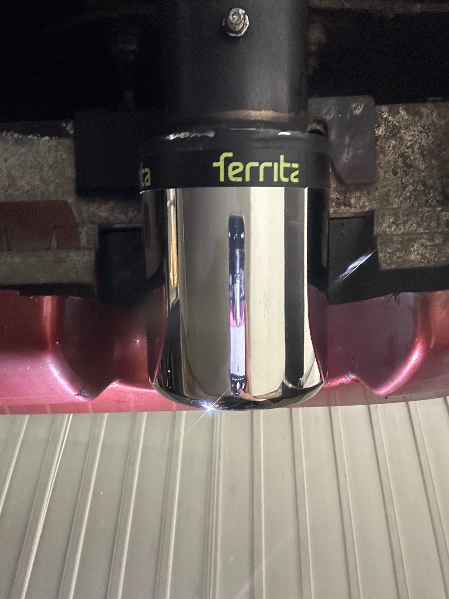

Does anyone know if the pipes have to be pushed all the way to the end of the connecting pipe?
Otherwise it seems that the exhaust is too short for the estate, because the tailpipe is very inwards of the bumper.

That is going to melt that plastic Bumper Chieber - I would steal a cm or two at each joint and add exhuast putty on each joint to keep them in place. If you 2 cm overlap that should work ok.

Hello Chieber, I had a similar problem, mine was also too short.
Can you find an extension or make one? I had to go up one size on the pipe, so I found an adapter that worked.

Thanks abscate. I’ll pull the tailpipe as far out as I can first.
I don’t want to deal with the exhaust hanger rubbers for the foreseeable future haha.
Looking for a longer oval shaped tail pipe now.

There’s a oval tailpipe from Simon’s that seems to be 23cm long. This one is only 18cm. So without messing with the exhaust again, I think I’ll try the longer tailpipe first.
How is the sound of your exhaust? I’m kind of disappointed in the ferrita cat back.
With the oem exhaust I had this nice 5 cilinder sound in the cabin.
Now it’s too much bass and droney around 2krpm.
