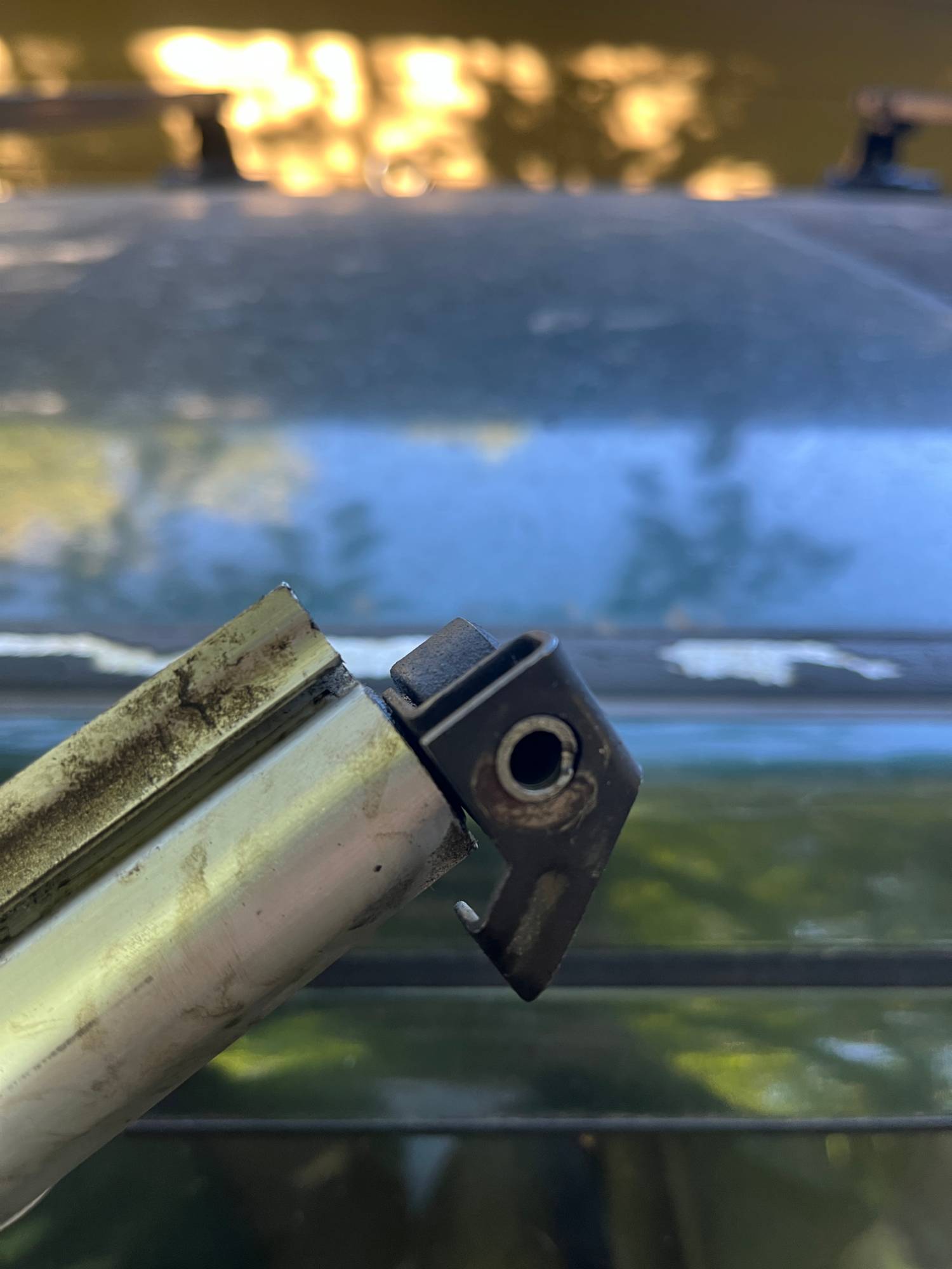

While moving fuel delivery line out of the way I attempted to disconnect from the rail and it having been a few years since I did this, I wrenched too hard and the line snapped at the rail + a little twist at the end of the line. Thankfully, I've found a replacement part on ebay, fingers crossed its the right one since they do not seem to be available otherwise, but I'm looking for advice on how to best disassemble where it fits into the rail. Do I need to remove fuel injectors to get there? Trying to not dig an even deeper hole.

As for the fuel line. I've attached a photo from the parts diagram. The green line is were it broke. The area circled in red is seated inside the fuel rail and I'm trying to figure out how it wants to be removed so I don't cause a new problem! New injector seals are a good idea if I do need to pop injectors out although I did totally rehab them a few years ago when I did PCV.

I would like to help you, but it has been a long time since I took a 98 fuel line off. Hopefully someone else will chime in. I will try to see if I can figure it out.

Post by Sveedy »
You might damage one of the injectors while trying to get that fitting out, so just take out the injectors. The seals should be fine. Just use a little Vaseline on them when you put everything back together. If it was me, I'd check the local junkyard for a fuel rail, and not fool with that fitting.
1999 V70 GLT
Posts: 35267
Has thanked: 1497 times
Been thanked: 3809 times
A junkyArd rail seems like the way to go here , you might have to swap injectors for a T5

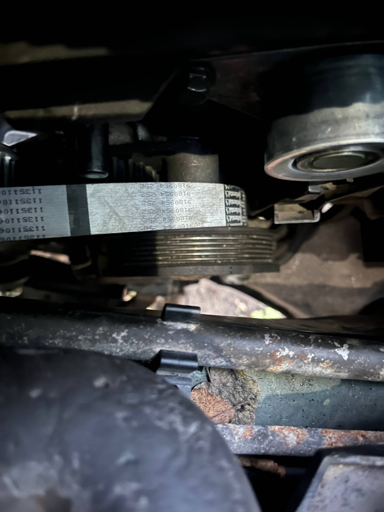

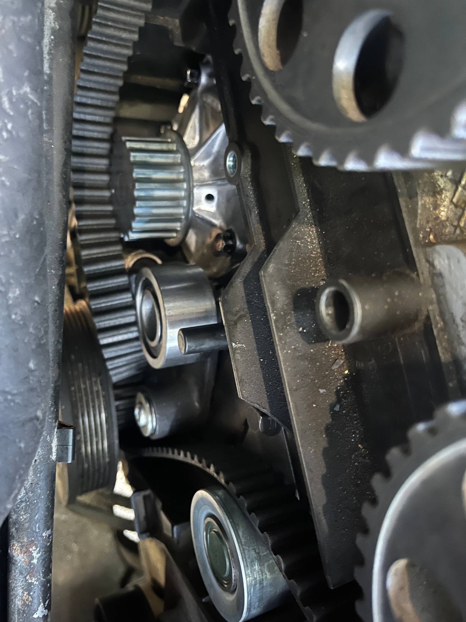

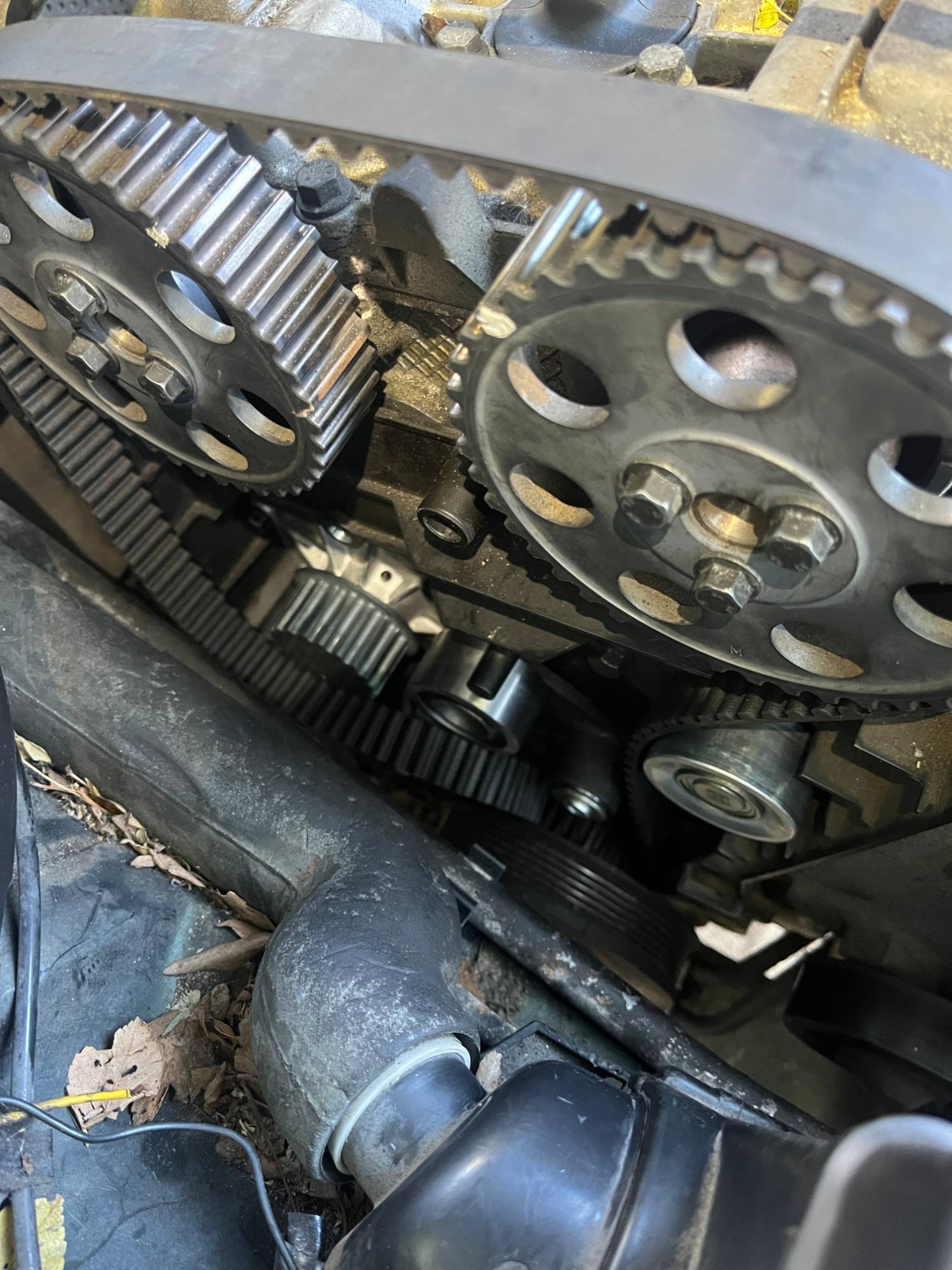

So now I'm trying to finish what I started (and am coming to regret) and for the life of me I cannot figure out why the timing belt is does not fit.
The sticker on crank case cover shows engine serial # 1013663. It has a hydraulic tensioner. This is the part I ordered and I verified its the one I received. I'm kicking myself for throwing the old belt away already, but I'm pretty sure I checked them against each other when I removed it and they were same size... though not 100% sure. Anyways... this should be the right part!
Here's some photos. Any idea what I've got wrong here? Is it somehow the wrong belt? Am I just doing it wrong? Without the tensioner in place I can thread the belt fine but there's not enough give to install tensioner with belt in place and when tensioner is bolted in raising the pully I can no longer thread the belt. I am pretty sure belt is tight around crankshaft pully. Hopefully this is just something stupid/obvious I'm missing.

Post by jmartin919 »
I assume your tensioner is compressed?

stickinthemud
Posts: 13
Joined: 21 December 2021
Year and Model: 1998 V70 T5
Location: Minnesota
Has thanked: 2 times
Been thanked: 1 time
Post by stickinthemud »
Yes tensioner compressed with pin in - its a new part.
Posts: 35267
Get under and get the teeth set into crank pulley first. It helps to have someone else up top pulling up on both sides of the belt to keep it there, then work it around all the pulleys and tensioners - they all have to be in place to get the belt on right
