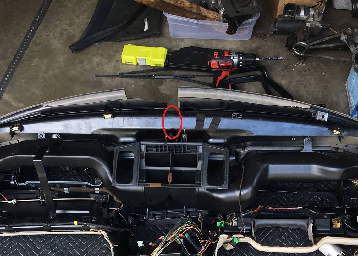

@scot850
Then it would be better if I stuff foam under the lip.
I have attached a photo and marked it. Can it break there too?
I'm screwed if this has to be done, I don't have the space or the skills for such a big job
And I don't have a mechanic who would do it either...

I would not expect it to break that far down. While anything is possible, I have not seen one as bad as the one in your picture. Even the one on my buddies 850 which was really bad (2 mounts cracked and 2 completely broken off and broken A pillar mounts) was not that bad. That damage was more likely caused by poor removal breaking a cracked piece off.
You could try something thing thin like butyl tape. I'd would not put them within 10cm of your red marked area.
