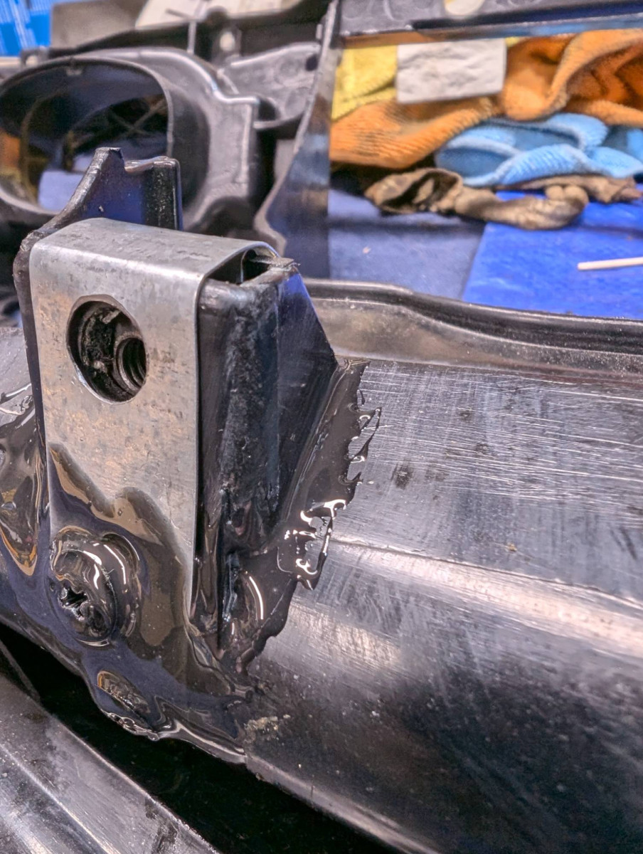

Most likely badly broken dashboard mounts. I just repaired my buddies 850 dash for the same reason. His was broken in so many places it took a long time to repair. If there were any 850's in the junkyards around here it would have taken less time to go pull a better one.
I also have a V70R and it was also so badly broken I did pull another one which was so much better.
After repair my buddy's only complaint was he could now hear noises from other mechanical issues!!
I should add that my cars dash was so bad it had broken around the glove box mounts and the end mount panels as well.

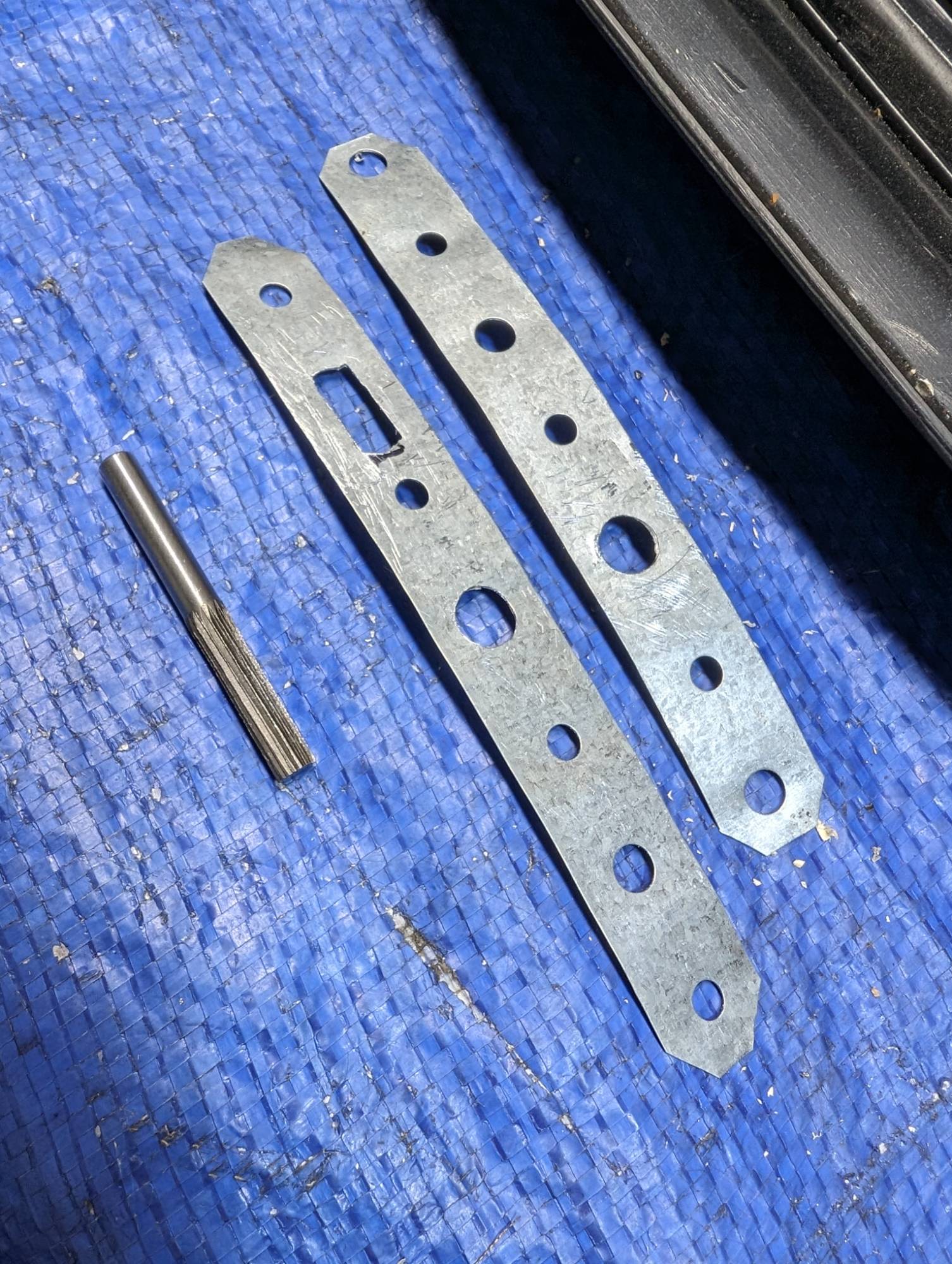

If you did the video with the glove box removed, it removes a lot of support/stiffening from the dashboard. My dashboard did the same as yours and gradually got worse and it was in terrible shape as I mentioned.
Yes it is a poor design, but it is not fixable from a manufacturing any more so it is what it is.
I have repaired several of them and use metal thin strapping plastic glued and screwed into the dash. I have posted on the subject:
Repair straps
Repair straps
Mount repair
Mount repair
It took a fair amount of time, but in the end I have a non-flexing dash that does not creak.
Abscate I think did a 'repair' with his dash as did others with some kind of tape jammed down between the dash and the windshield to stop the dash rubbing against the glass and squeaking. Sure, silicon spray may well help for a while, but ultimately you have a C70 which is less stiff than the standard cars and the 01-04 are the same as the 98-00 C70 dash boards. Th e850's had knee braces too which helped stiffen the dashes, but it did not stop the issue. This is one of my repairs on the dash
viewtopic.php?p=648540&hilit=dashboard+repairs#p648540
