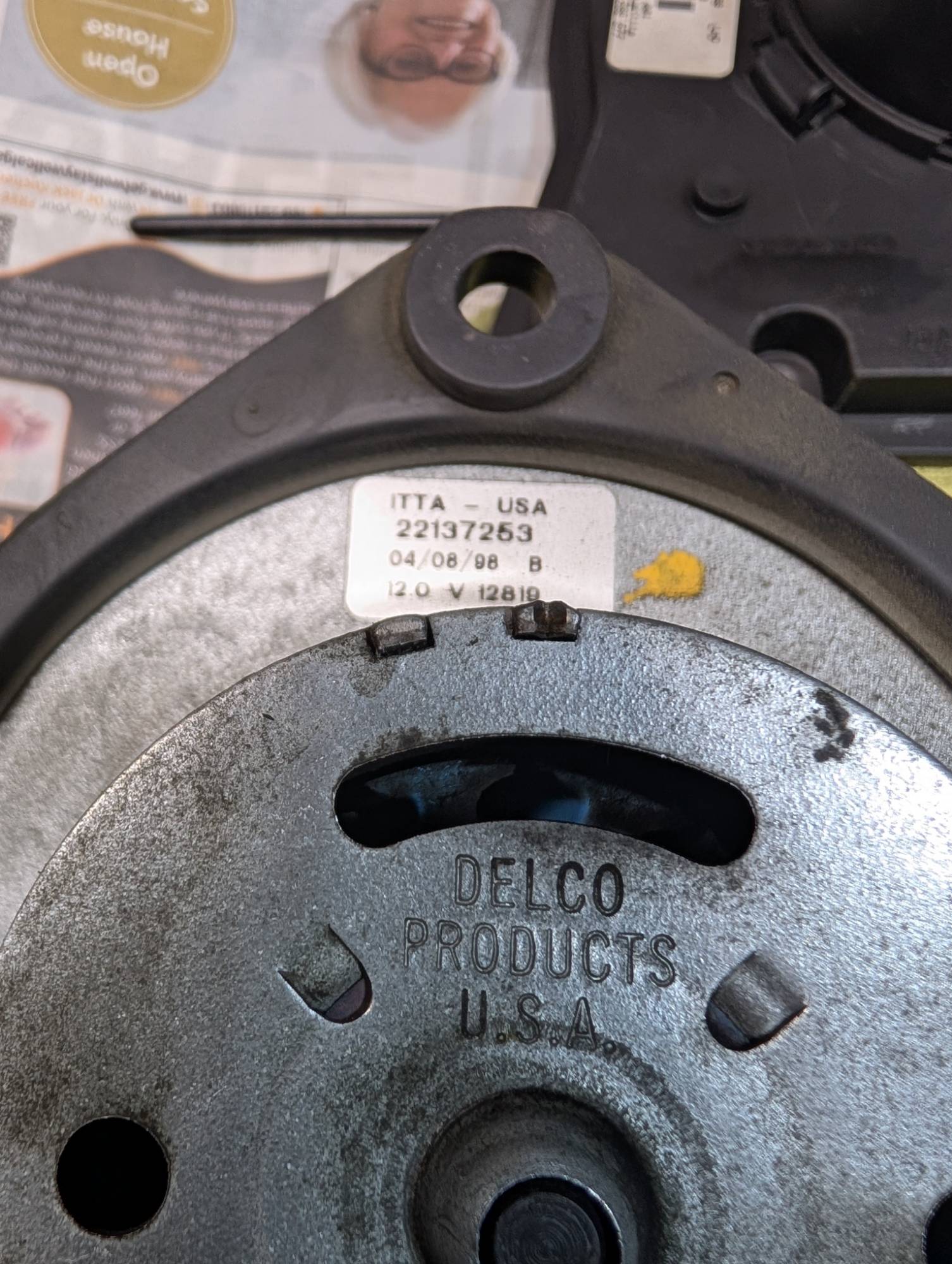

1) I always like to understand why stuff fails and if the parts can be repaired for future re-use. I took the rear cover off and the then realized you need to pull the fan blade wheel off. How do you do this without damaging the center section?

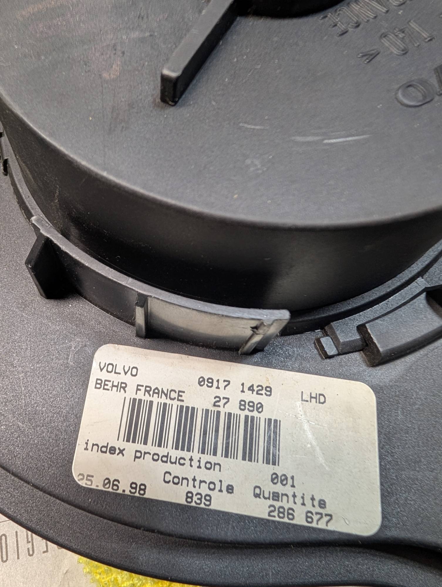

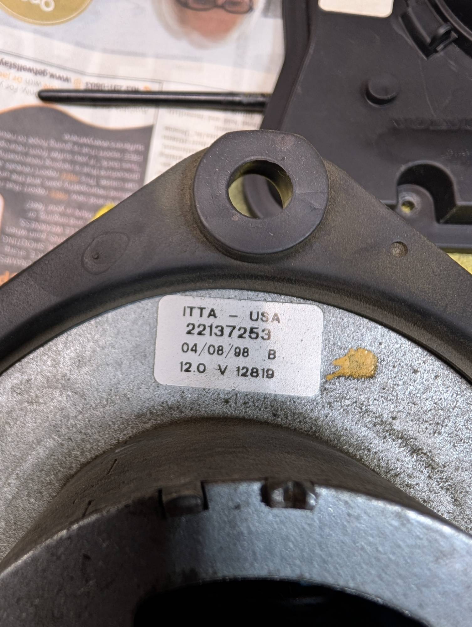

2) It was interesting during disassembly as I had watched I think it may have been Robert's video on servicing a motor, but his was from an 850 and was different to the one I have to look over. What surprised me was the unit said it was a Volvo part with the Volvo name in the plastic as well as a Behr branding on it too. I knew Behr was an OE supplier. What surprised me was the name on the actual fan motor was Delco, and says made in the USA? I didn't know Delco supplied parts for OE parts? Or is it possible only the motor has been replaced at some point and the fan wheel and the casing have been reused? I don't think so as the motor label dates it to 1998 as well as the rest of the unit.

Welcome to the wide world of auto parts supply chain
Motor 🇺🇸….. fan assembly …. 🇫🇷…… car .. 🇸🇪 or 🇧🇪 …… 🇨🇦
I don’t think I’ve ever successfully gotten off a fan blade off a p80. Nothing to grab.
Easy part to scavenge in a yard.
Vicious expensive new 30755485 $350 Volvo. Febi $150 aftermarket

About 12 years ago I bought a 'rebuilt' blower unit for my 850 from somebody on eBay. The motor was new and ran fine but the fan blades vibrated -- I think the balance clips had been lost or disturbed. I put the motor in a vise and gently held it while tapping the motor with a rubber mallet and pulling up gently on the fan. With each tap, the fan lifted a tiny bit.... fifty taps later and the fan blades were free of the motor shaft.
