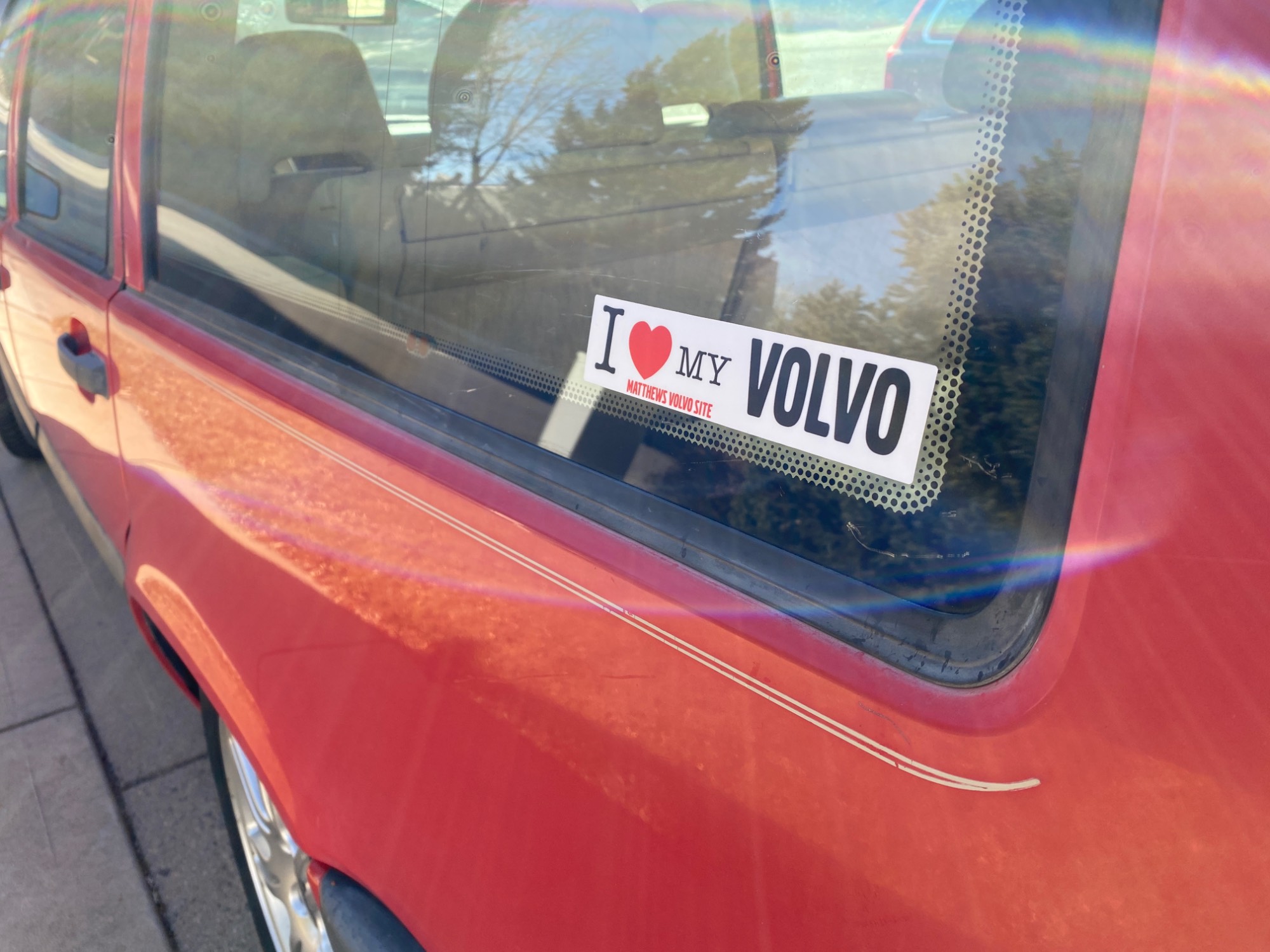

I don’t. I didn’t make the rules, I just follow them, for instance MVS stickers aren’t likely to increase the chances of fixing a problem, but they can’t hurt.
