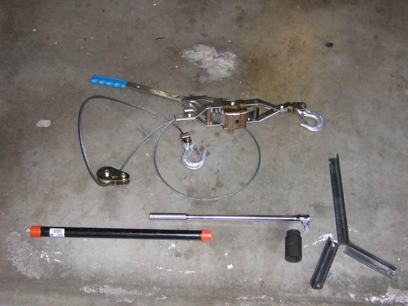

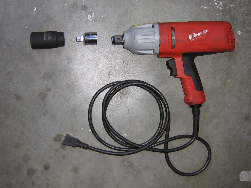

Success! Finally after getting the crankshaft pulley off. This latter was a major chore, but it needn't have been. I initially spent all morning building a counterhold tool out of 1" angle iron. I then immobilized/held the counterhold tool with a come along anchored to the car frame near the rear tire. I then yanked with all my strengh using an 18" breaker bar, bracing my foot on the jackstand. No Effect. I then ran off to Home Depot and purchased a 2 foot section of 3/4" galvanized pipe, jacked the car up higher for more head room, placed the pipe over the breaker bar and yanked with all my strength. I felt something give. It turned out the be the counter hold angle iron. It broke. I was beginning to worry that it might be a left handed thread, but further net research pointed to it being a standard right handed thread. I then ran off to A-1 Tool Shed and got some Old Milwaukee ... 3/4" impact wrench that is ($22 rental). I squeezed the trigger and before I even had time to really respond the 30mm nut was spinning free! When removing this nut it helps to have the timing belt currently installed in case the crankshaft rotates. This will roll the camshafts along with it, preventing any valve damage. If the crankshaft does move you can reinstall the nut (now much looser) to turn the crankshaft (clockwise) to align timing marks, and then remove the nut again.
The following picture shows the hard way to remove the crank nut, including the broken counter hold tool.

The following picture shows the easy way to remove the crank nut.

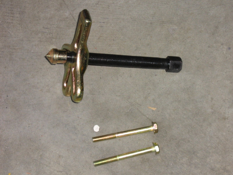

I then removed the four "lug" bolts and the roll pin. Pulley would not come loose. I taped lightly with a hammer. No effect. It was still wedged onto the spindle. I then ran off to Kragen/Schucks/Checker/O'Reilly/CSK Auto and bought a puller for $19. I installed the puller and cranked a few rotations. This was more than was needed. The pulley fell right off, but it also pulled the timing belt crank pinion gear out a half a centimeter or so. This was not much of a problem because the crankshaft pulley nut pushed it back in as it was tightened. Once the puller engages, probably only a few degrees of rotation should break the pulley loose from its friction lock on the spindle. The following picture shows the puller.

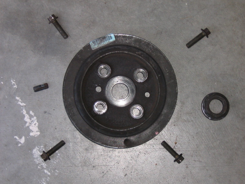

The following picture shows the crankshaft pulley, nut, 4 "lug" bolts and the roll pin.

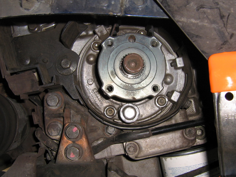

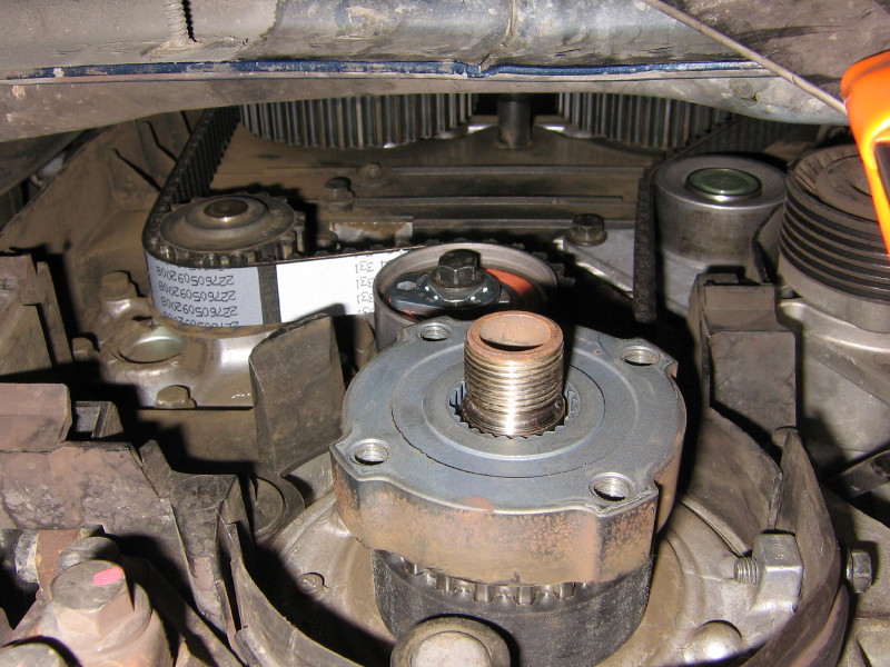

With the crankshaft pulley off, it was cinch to swap the timing belt.

The following picture shows the new timing belt installed on the pulley-less crankshaft timing belt pinion. Look at all the clearance!!! No scraping your knuckles trying to work it free! Also notice the gear assembly is pulled forward on the splines a little bit, as I mentioned earlier.
Crankshaft timing belt gear

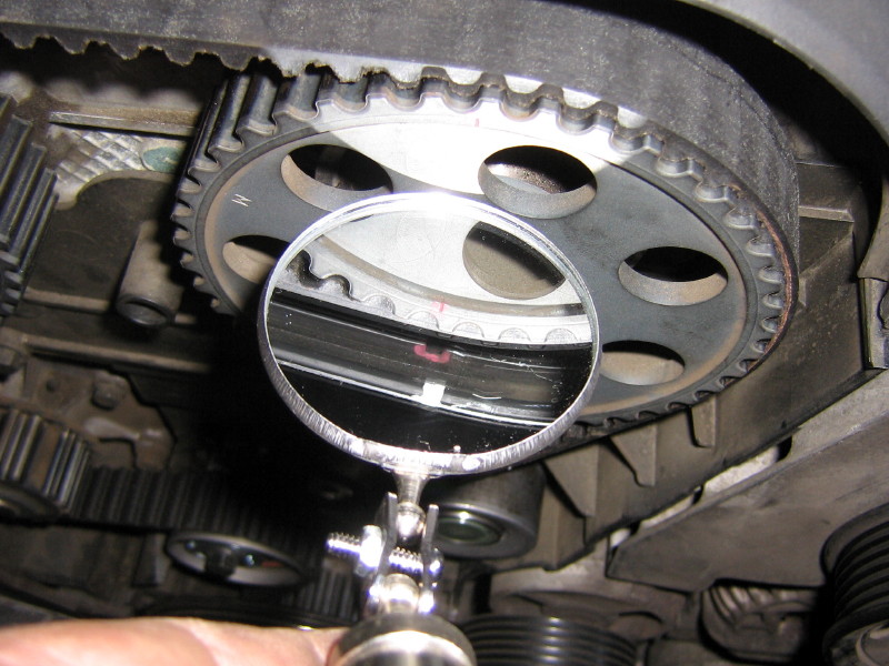

The following pictures shows me using a mirror to check the intake camshaft alignment marks.

I'm surprised that electric impact gun got that nut off. That's pretty impressive. I tried one of the 1/2" ones and it wouldn't even remove my lug nuts. I ended up getting a 25 gal craftsman compressor and a cheapo Kobalt gun in a kit for the job (actually bought to replace the wife's A/C system). I'm much happier with the air tools, wish I would've bought it a loooong time ago.

wheelsup wrote:I'm surprised that electric impact gun got that nut off. That's pretty impressive. I tried one of the 1/2" ones and it wouldn't even remove my lug nuts. I ended up getting a 25 gal craftsman compressor and a cheapo Kobalt gun in a kit for the job (actually bought to replace the wife's A/C system). I'm much happier with the air tools, wish I would've bought it a loooong time ago.
The Milwaukee impact gun in the picture (9075-20 https://www.amazon.com/Milwaukee-9075-20 ... B0000647GB ) is a 3/4", not a 1/2". The socket adapter in the middle is a 3/4" to 1/2", not a 1/2" to 3/8". I initially tried my 1/2" air impact wrench that came with a kit of air tools I have and it wouldn't budge. I had the same issue trying to get the anode rod out of my water heater (1 1/16" nut), which also wouldn't budge with my 1/2 air, but spun out easily with the Milwaukee 3/4".

That's really impressive that the electric 3/4" gun took it off. I might have to look into expanding my compressor outlet to allow for a 3/8" hookup and look into a 3/4" impact gun. The entire reason I went with the air was so I wouldn't ever have to worry about getting nuts off.
